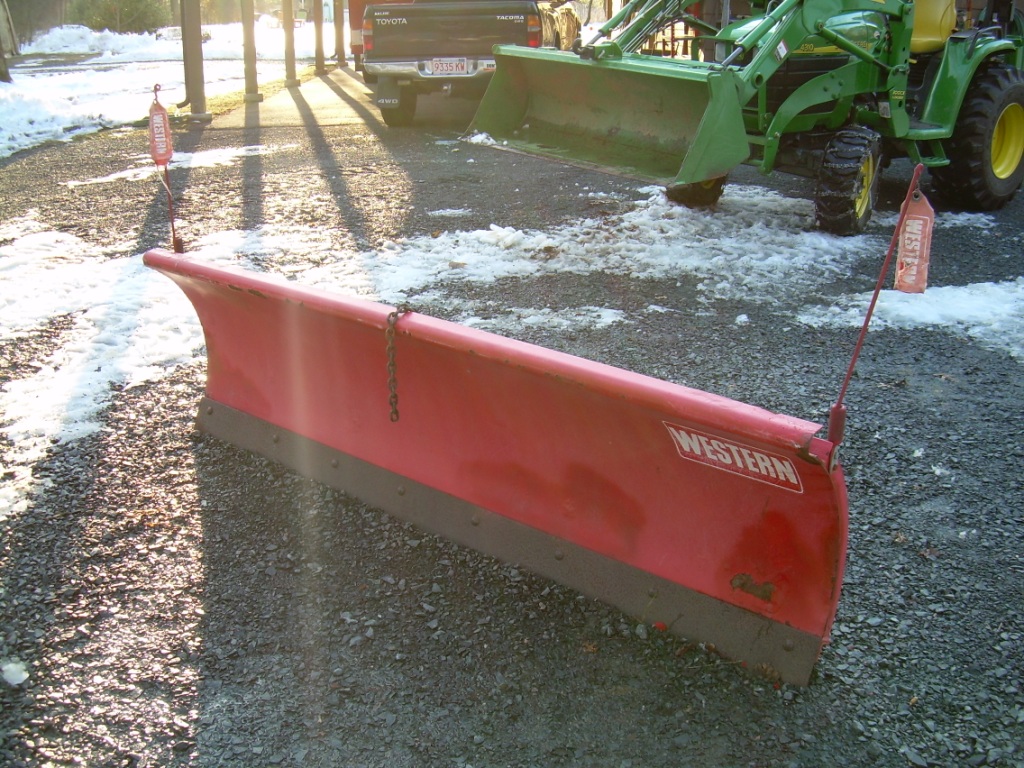

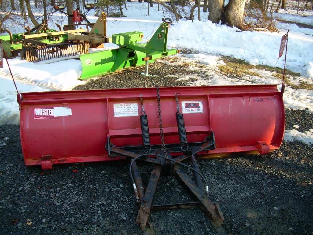

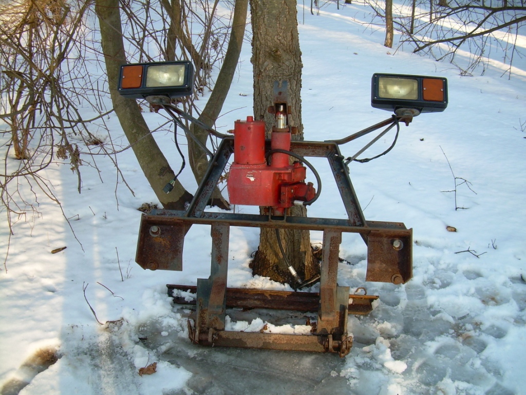

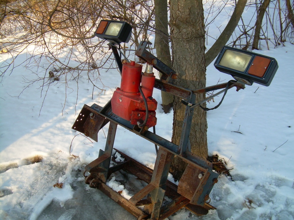

I got this western 7.5' plow for free but it is missing the controls, I see the holes where the cables go into the housing but am not sure how it works, if I connect 12 volt to the pump terminals it runs non stop, is there an electric switch that gets activated when the control cables get moved. I had a newer version of this same plow but it was all electric, no cables.
Not sure what Im gonna do with it but even if I sell it I want it to work, might try and rig it to my tractor also.
Thanks, JB.

Thanks, WOW! they do have a very informative, detailed owners manual with all kinds of tech stuff and even the theory of their systems, way beyond your run of the mill owners manuals.
It's kinda what I thought, there's a relay that turns on the pump at the same time the the cables actuate the valves.
So I need the joystick, cables and electric wires and relay.
Might just keep the blade and angle with the tractor's hydraulics. then sell the pump assembly, a new one cost $1,700.00, they're on eBay for $500.00 used.
