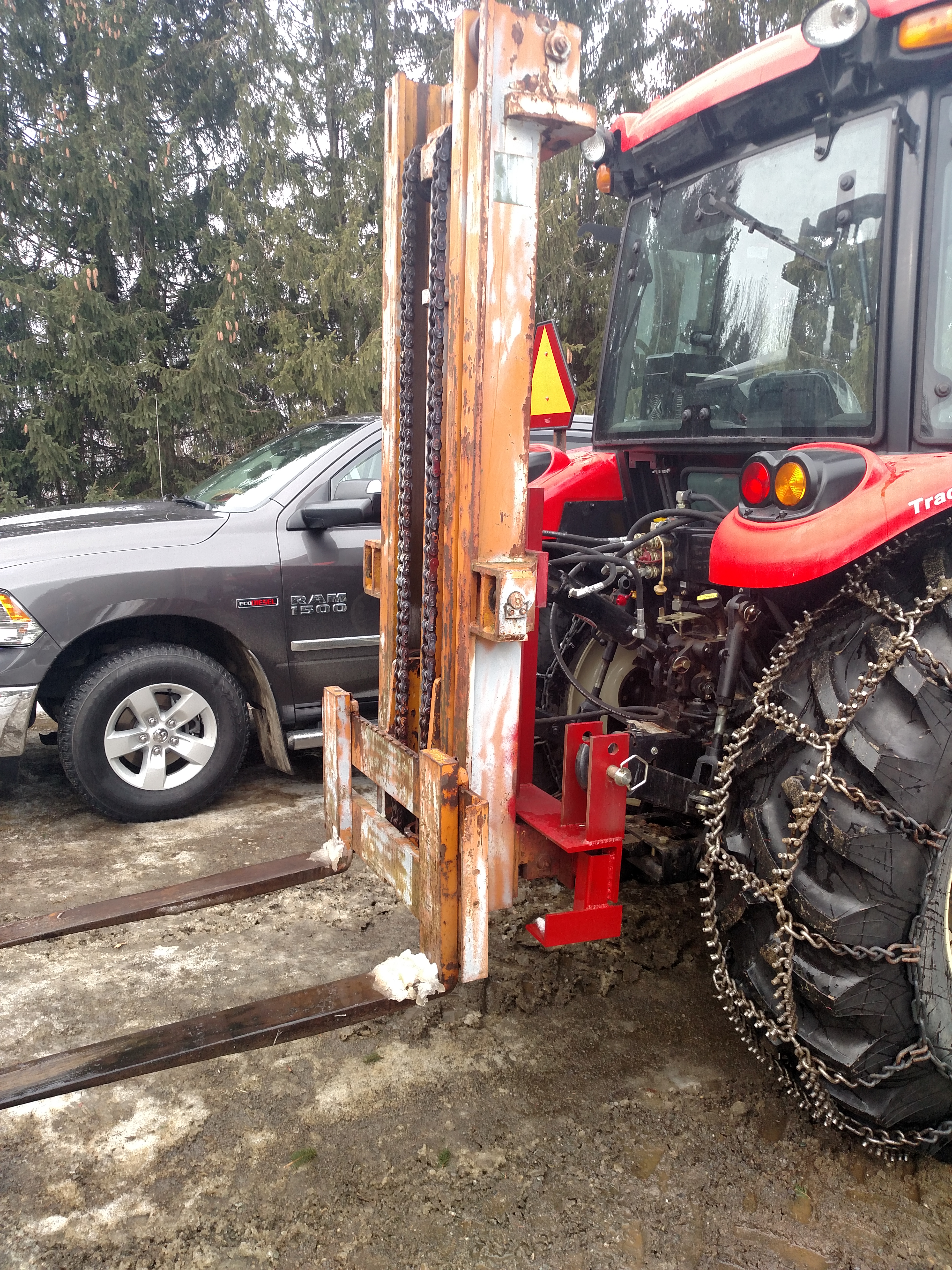

![Westendorf 3PH fork lift.jpg Westendorf 3PH fork lift.jpg](https://www.tractorbynet.com/forums/data/attachments/486/486398-15f77e7591516c18acb7299cd5bf828f.jpg)
I called about this 3PH forklift yesterday morning and closed the deal by phone and 14 hours later I had it home early this morning. Since I had to have the U-Haul trailer back by 10 AM this morning I had to move fast after a short night. This afternoon the son and I got it mounted and all functions working.
The forks will spread to 48" and are 3" wide and 1.5" thick before they taper. On our 1976 MF 265 with the lift all the way up we could off load pallets from a truck bed as high as 6'. Westendorf states it is rated at up to 3500 pounds of lifting "depending on your tractor". Their hydraulic top link cylinder is awesome and everything comes Cat 2 size so we can use it on the Ford 3000 but it would have to be for very light duty and I think the MF 265 is about as small as would be safe if used with care. The mask states 8 and it does seem to be eight foot tall. This summer we will repaint it back stock colors since it looks good with the MF color scheme.
The funny part was the mask would not lift yet each spooler control would move the top link. After 42 years the shaft in a shaft had frozen together but some PB Blaster and time fixed that age related tractor issue. I am glad the FIL purchased it new with the double spool set up. The fork main cylinder is single action. The guy that had it is 6 years older than me and has owned it for years and said he had a local guy rebuilt the lift cylinder. While we did not load test it today the cylinder is smooth up and down.
Thrifty Lift | Westendorf
From the links in the link above it means I have the ADJUSTABLEFORK LIFTHF-AJ100 and the TOP LINKCYLINDER M-7. The flexibility is nice which makes me happy. If I run across the BALE SPEARHF-150 priced right I would go for it just in case we should ever move to round bales.
https://www.loaders.com/userdocs/products/HFC-42.pdf
Below is a 1 minute Youtube video of the Westendorf forklift attachment showing its range of motion.
Westendorf Thrifty Lift - 3 point forklift attachment - YouTube
Now I have to get one of the video cameras and display set up that I still have in the boxes. There is a time and place for our chain on forks but with my extra "eyes" both in college those days are long gone I expect. If it is to be it is now left up to me I guess.
