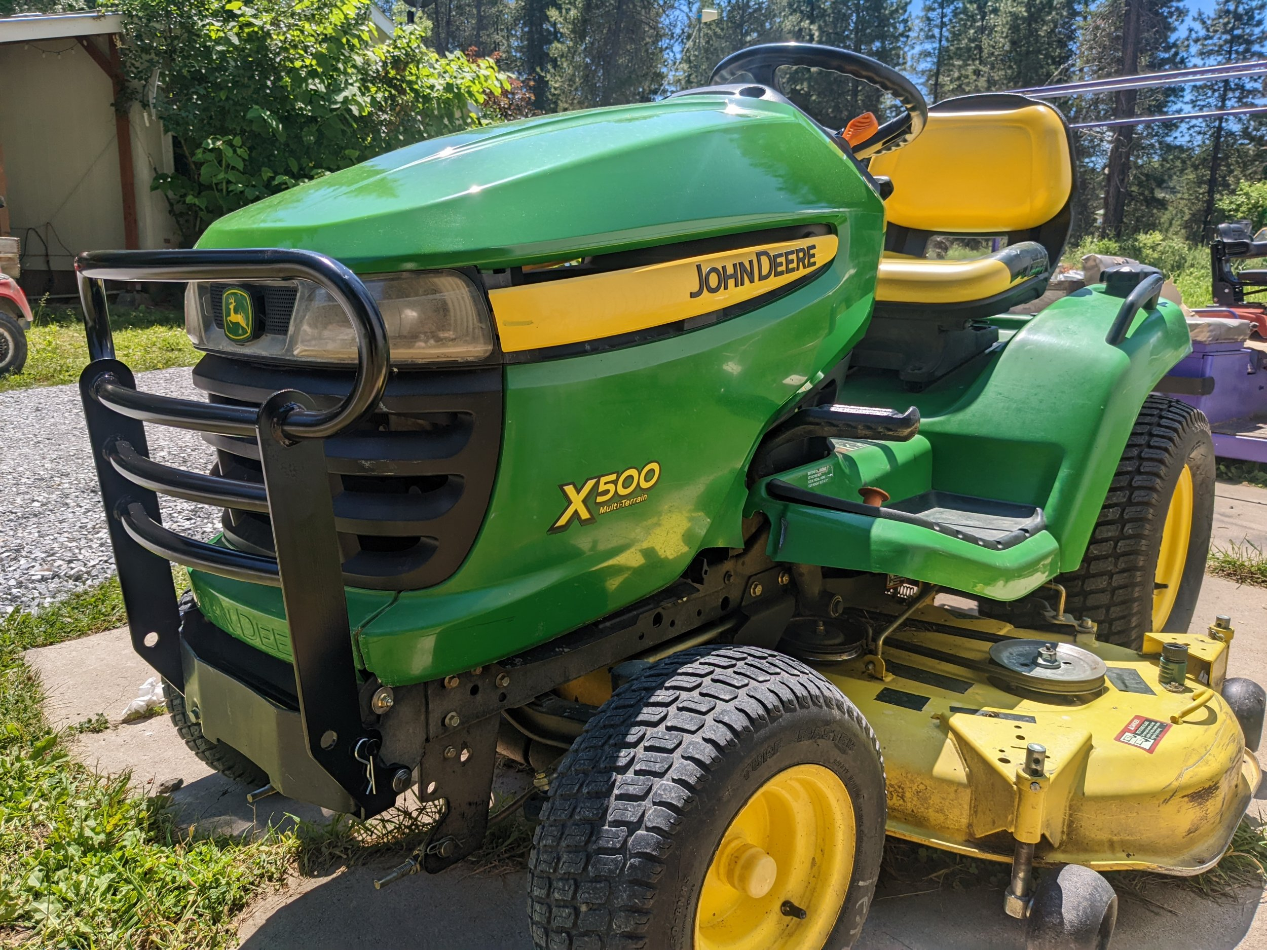

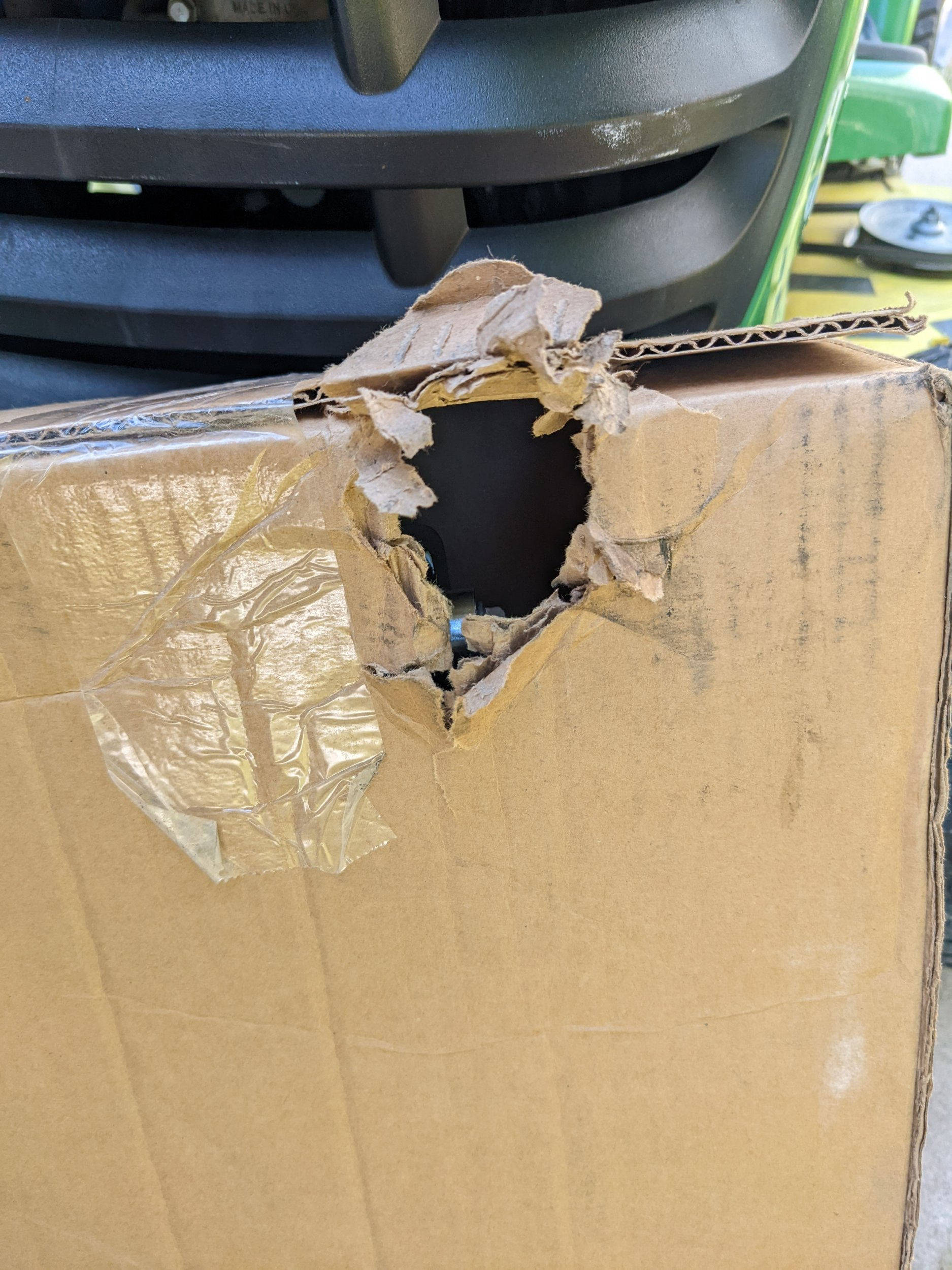

I had ordered a factory Brush Guard thru amazon. Box showed up with large holes punched in it.
No one was home and knowing myself I still would have accepted it anyway.

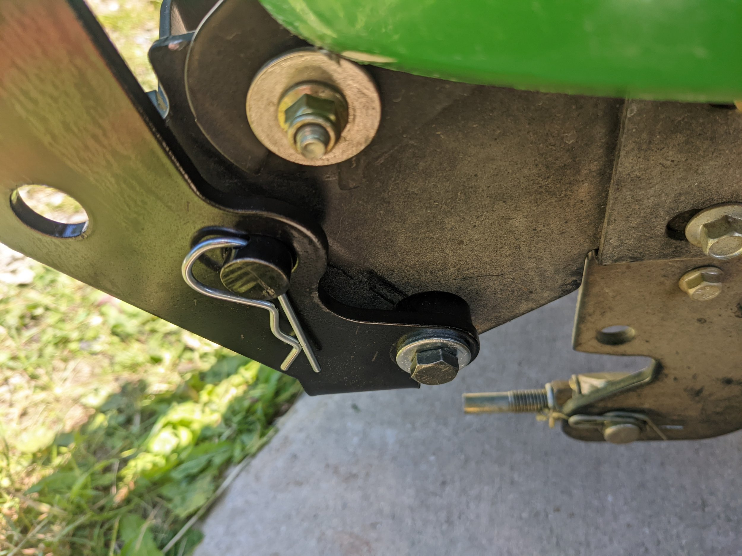

Sure enough small parts were missing (just a bolt and washer and one of 2 stepped spacers.
I figured it would actually be less hassle to machine a new spacer than deal with amazon/UPS so started to lathe one up on my little HF unit...
Then I promptly lost the spacer that did not fall out of the box,smh,
so I made two out of the delrin copy of round stock left over from the QA I did on the tractor.
Thinking probably less likely to rattle as well.
I Like the Grille Guard, and we have lots of stuff to run into around here, plus I did a quick repaint and fiberglass repair on the cracked hood.
Color did not match ( Van Sickle fizz can) but Its OK since the cracks are still showing. Anyway It is still the nicest mower we have ever owned.
