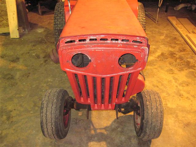

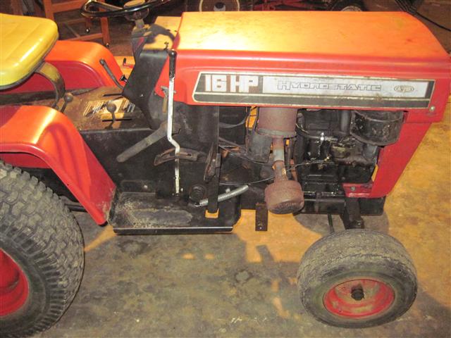

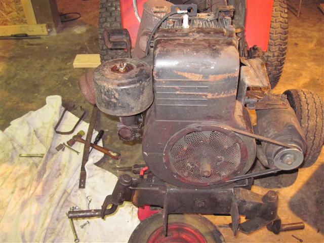

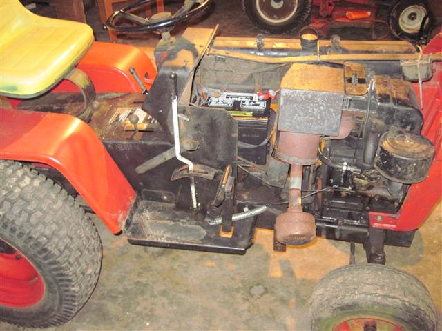

:dance1:hi everyone this is #4 just got this one and i will be restoring this one over time as some of you may know i have done 3-other ones. that i have sold all ready. the first(blue was a mtd 990 1980 model)-#2( was a green wizard 990 1976 model)#3( was a vary rare firestone fairlawn 990 1973 model) yes all were made by mtd and all are 990 these tractor were sold in places like jc penny.firestone tire.westen auto stores and more they were sold under lots of names like wizard,daytona,fairlawn,farmboss and more.this one here is a 1982 mtd 990 in really ruff shape. i will be going slow but it will get done if you have one please send picture and tell us your story about it.like my blue i added electronic ingtion and it was one of the best running tractor.and it had a lot of power. here some start picture lets see yours :thumbsup:
