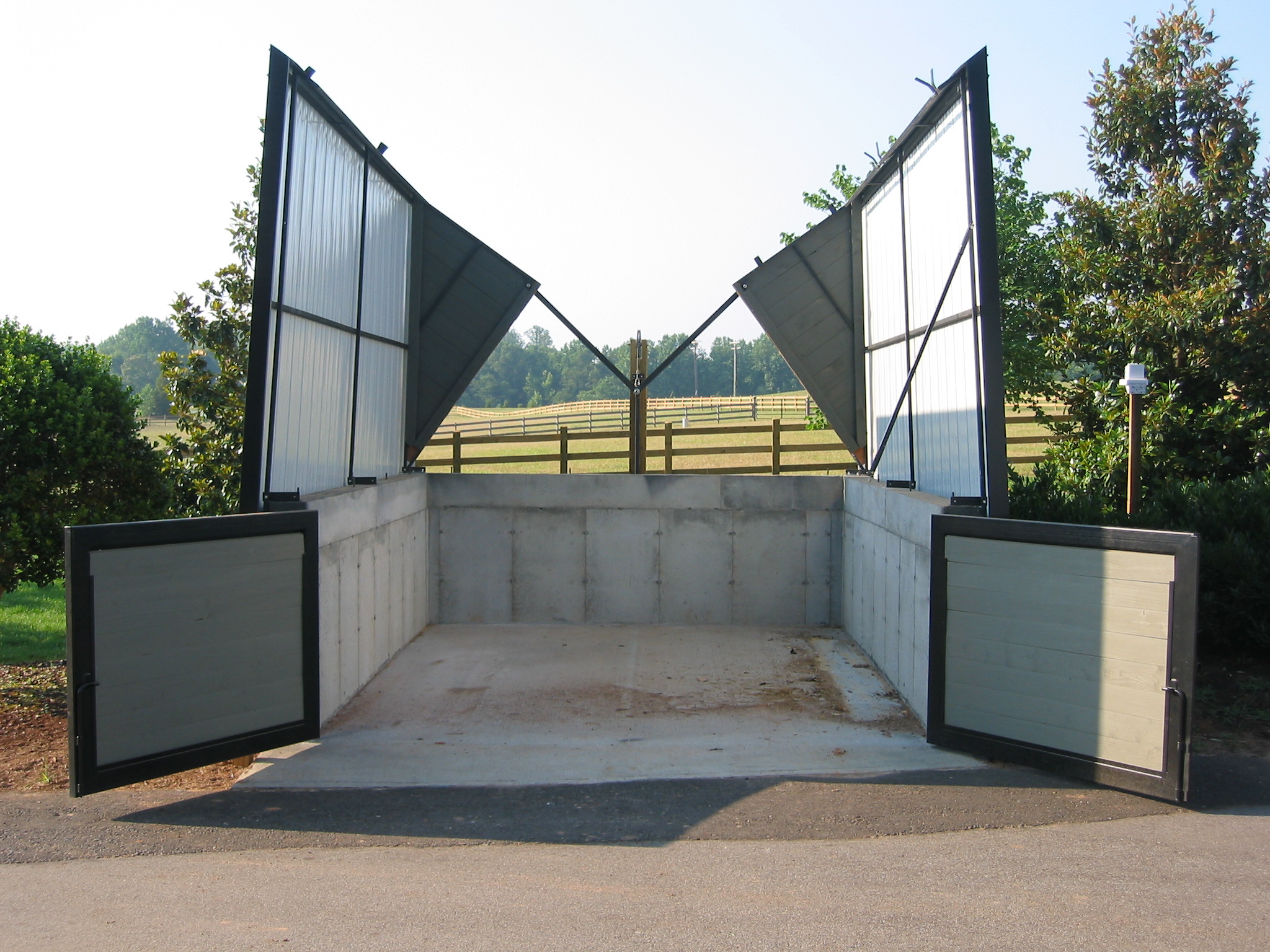

Make it like a sawdust bin I built.
   / Well house roof design help #24
Brilliant, but what is a sawdust bin used for? I know, sawdust, but what do you use the sawdust for?
   / Well house roof design help #25
From the remarkably manicured pastures and wonderful fence placements and construction, I'd bet this farm is for royalty horses. Royalty horses get bedded with sawdust and the sawdust is delivered by a box truck with a dump box feature. Back up, unload, close the storage bin. Nice !
You are correct. I don't get to build many of these. Thanks.

Can you point me to any info on how you built this sawdust bin? I'm mostly curious about the system that opens the roof and how the roof was made. I'm looking to build a smaller version for a well house to hold the pump, pressure tank and 3-4 whole house filter systems. I need to be able to get above the system to service them on a monthly basis. I also need to insulate it well and add a small heat source for really cold days.
