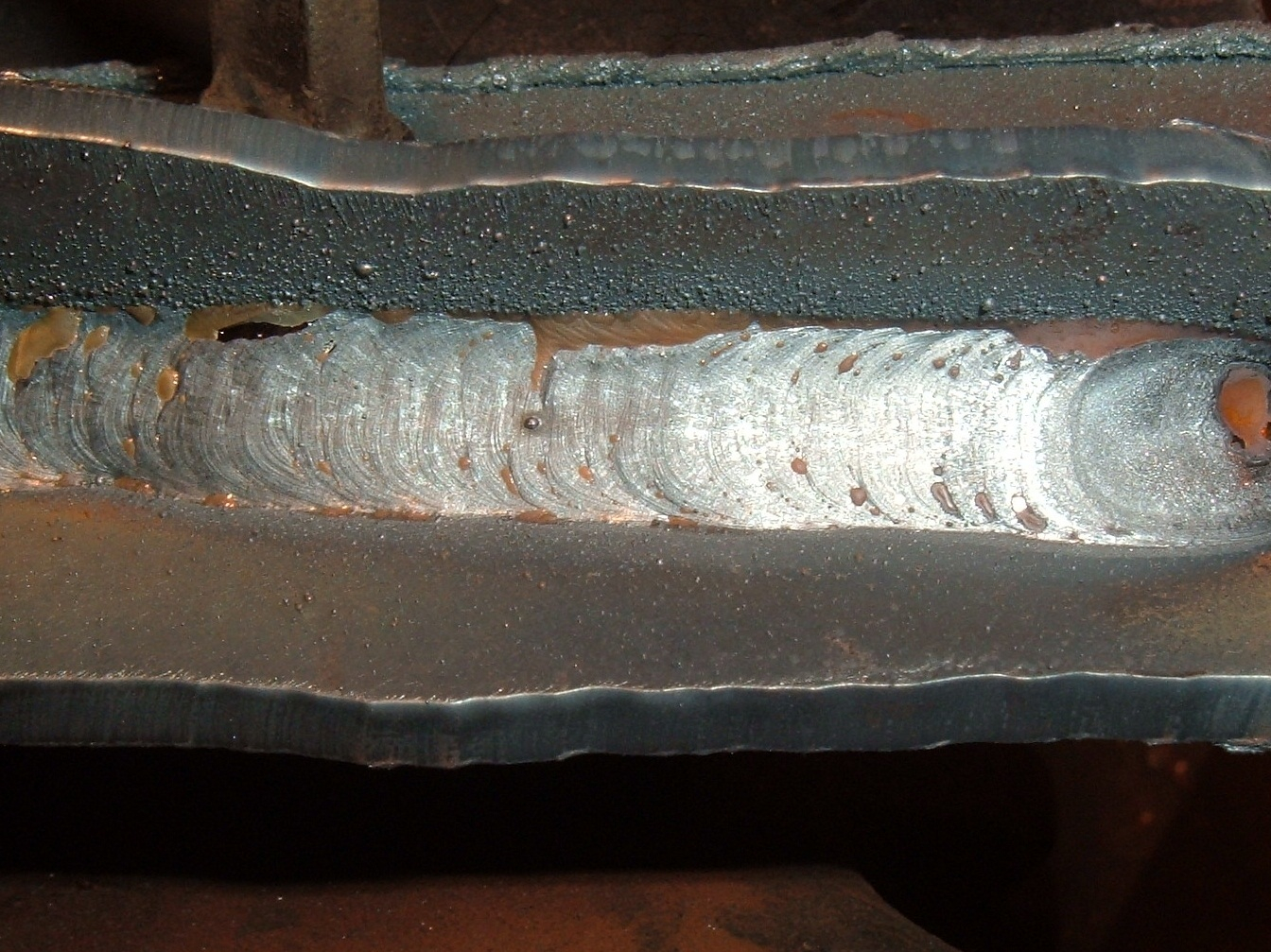

A properly done weld, whether a fillet or a butt, will be stronger than the parent material. This means that the weld itself will not fail before the parts being welded together fail. The weldment may fail at the weld/parent interface, with the weld bead tearing out, but this is unlikely in a properly welded and designed structure. When making a butt weld on pipe or tube there should be 100% penetration of the weld from the outside to to the inside. furthermore, there weld will bead will not be flat but will be above the surface. So the weld bead will be thicker than the parent metal. Furthermore, the weld rod will be of a higher strength than the parent material. So if you are making proper welds a fillet weld is not necessary to replace a butt weld for strength.
