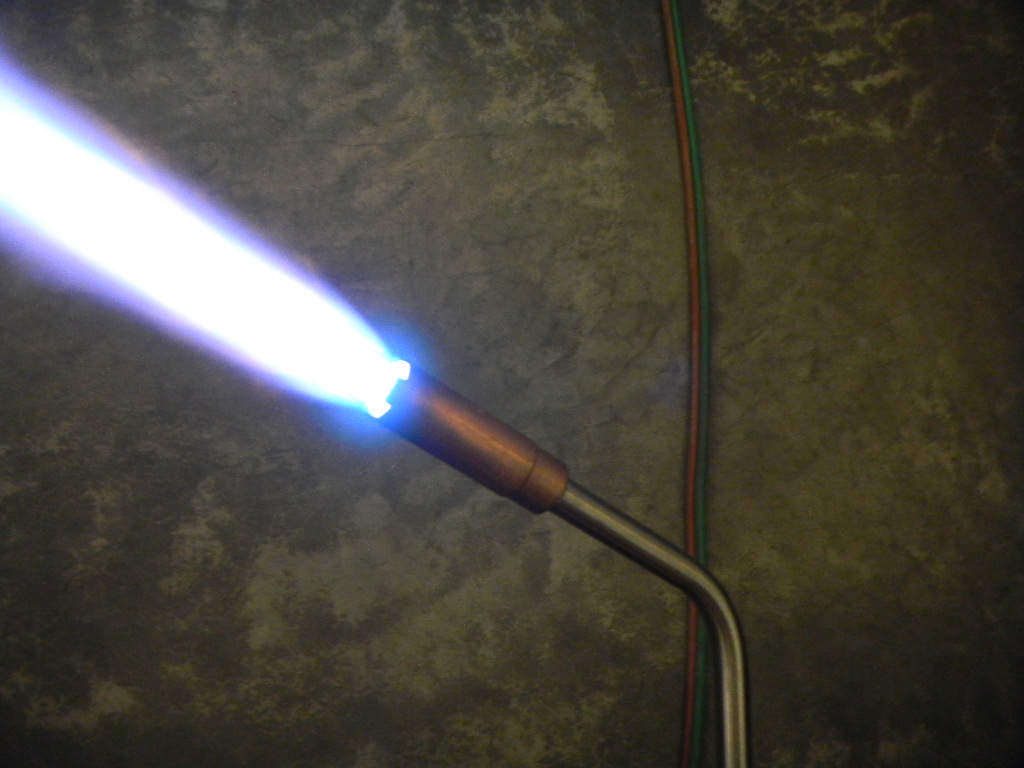

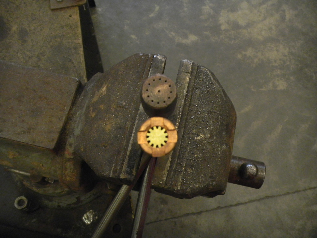

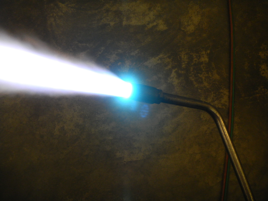

It is difficult to maintain a propane flame on an acetylene tip, especially a welding tip. The flame tends to get blown out very easily. It's very hard to adjust and maintain the flame.
Propane tips are recessed for more stability.
My standard rosebud works okay on propane but welding and cutting tips are a problem.
Note also, that propane degrades standard acetylene hoses over time. It's best to replace the hoses with an "all fuel" hose.

Here are some pictures of a propane rosebud, and an acetylene rosebud.
