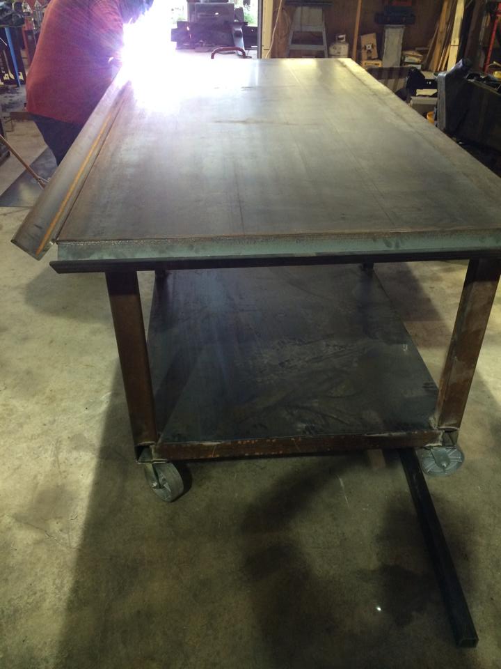

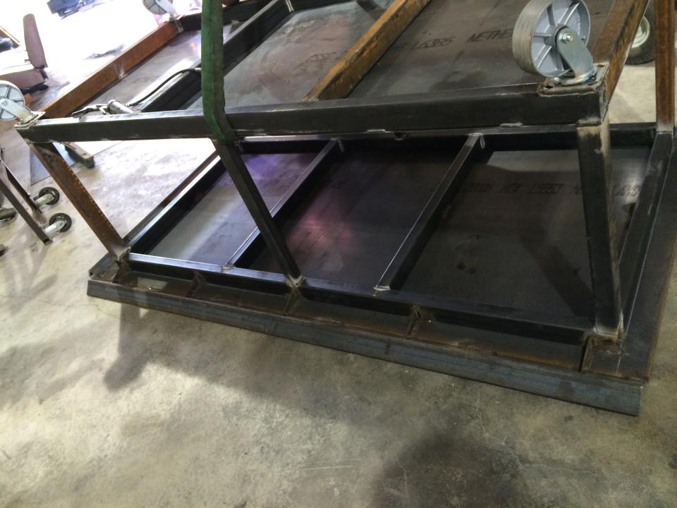

Just finished up my welding table build about 2 months ago, I used 1/2 plate for the top, 1/4 wall rectangular tubing for the frame, 12GA for the bottom shelf and 3X3X3/8 angle for the pipe channel. Weighs in at 1106 lbs with the wheels

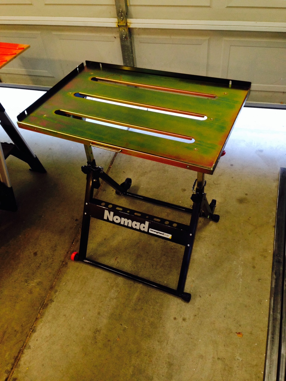

For years and years, if I was lucky, I had a piece of plate on a couple sawhorses. Anyway I never had the need for a big heavy table. Just today I bought this little table, it is adjustable for height, tilt, has edge guides and clamp slots, weighs about 50 lbs. Just right for me, I need something easy to move between our two homes. Anything too heavy I can always go back to the plate/sawhorse plan or just weld it where it sits.
