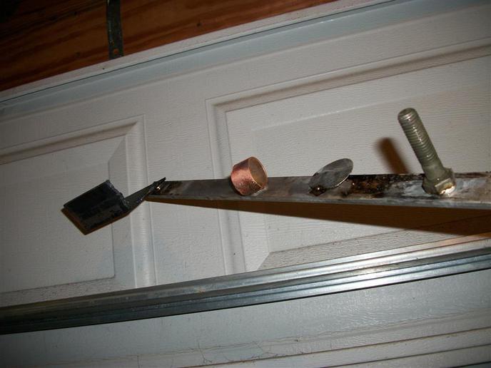

quite easy.. just takes a lil patience and 2 different solder alloys to do it.
I soldered or 'brazed' a piec eof aluminum bar to a piece of steel angle.
clean wire wheel to each piece.
lots of flux on each piece.
tin the steel with silver solder.. set aside..
use a alloy solder rod, such as alumaloy and tin the aluminum. ( note.. all the allow solder rods I used were MOSTLY zinc.. so this should give you a clue as to why it works.. )
once the aluminum is timmed with the zinc allow rod, then you can tin that zinc alloy patch with silver solder.. then you can join that bar stock to the angle iron and heat the joint like sweating a pipe and the silver solder on the angle will join witht he silver solder on the zinc path and flow.. and then you let it cool.. and poof.. you have soldered aluminum to steel using 2 steps and 2 different fillers.
works especially easy on zinc plated steel.
here's a pic I made for some unbelieving friends that called me aliar when i described the above process. that long bar is aluminum stock. on the end is some scrap angle iron.. then a piece of copper pipe, thena tin tab.. then a bright zinc bolt. :)

I agree with you 100%.
try it before being sarcastic.
I posted some pics below of a mock up i made for some 'friends' that said I was full of ^&*(.. then I proved em' wrong... )
as you point out.. there are some nice mostly zinc, alloy rods that will melt and join to aluminum.. from there.. it's pretty easy to get lots of different metals to stick to zinc...
when dealing with the non believers.. i always keep in mind the old addage about science being like magic to those that don't understand it.
soundguy

Thank you Soundguy :thumbsup: Picture is PERFECT!
I guess I'm gonna have to try it :)
   / Welding question on BIY #20
you wouldn't believe all the naysayers.. some called me a downright liar.. some stupid. some said I faked the pis.
so I took like 20 pics showing the steps, using the propane torch, clenaing.. soldering step 1,, soldering step 2, and then joining all the dissimilar metals to that one aluminum bar, then inverting it and what not to show it was not a trick of angle or some thing.
mind you this is a slder connection and as such is only as strong as the filelr metal..e tc.
Lots of oil pickup tubes in old tractors hav ethe tube silver soldered into the pump.. so hard solder on steel, I alrady have done / had good practice with. and those allow solder rods that are good for aluminum and zinc alloys.. well.. once you read the rod contents you know what you can do.. ones I have now ar emostly zinc, with some aluminum..e tc.. couple other metals inthere too.
knowing what all zinc will stick to lets you in on what you can and can't join.
havn't had much luck with chrome yet ;)
