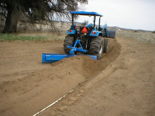

I have done what you are asking about and want to do. Here are a few pics. On the Land Pride blade, you can see where I have extended the lift points down and forward. They really only needed to go straight down, but by going forward the blade is now able to be raised with the top link very high for transport.
The pics with the blue MidWest blade is where a ditched for several hundred feet. Worked great. I made 2 passes to get the trench 18" deep.

/ welding on landpride #28
candyman,
You can see from MtnViewRanch's photos how to tilt the blade forward to "plow" a furrow. Great photos from him.

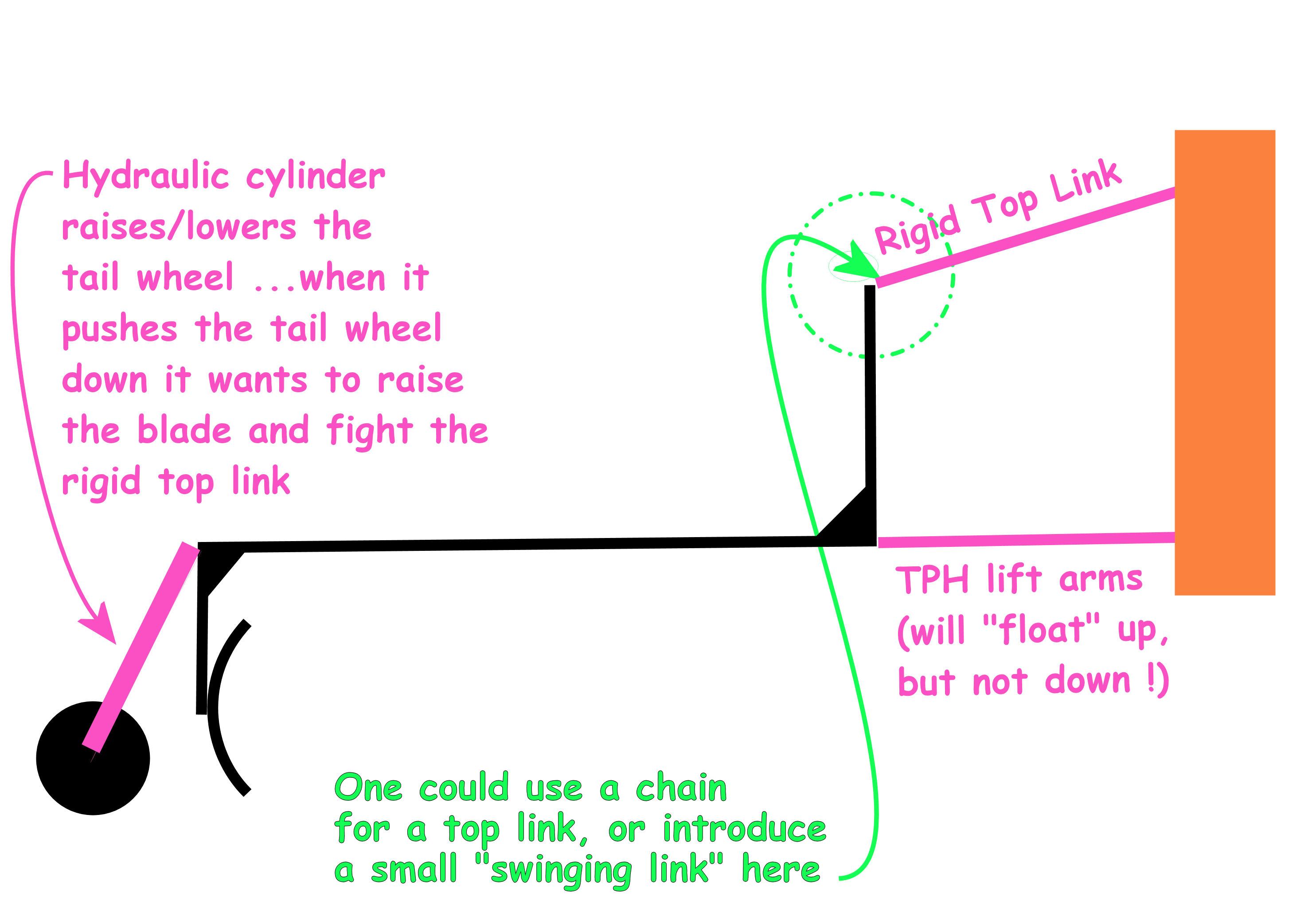

As pointed out, you have another hole of adjustment on your lift arms to take advantage of ...and, you can always get a shorter toplink but, as you say (and others seem not to have appreciated) just shortening the toplink changes the "angle of attack" of the blade.
If your landpride is like mine, I have 30" of offset which is how I do my ditching, so that the tractor stays level and I use the tilt of the blade to cut the ditch ...but, if you don't use the offset, can't you use subsequent passes? on each successive pass, the tractor will tilt, no?
In my case, I use a short toplink with a swinging toplink adapter (HF) to get the length when I need it and to allow compliance in the blade. I have posted this picture before, but it explains my geometry, which is quite satisfactory for my ditching ...and other purposes, and allows the hydraulic tail wheel to function best.

/ welding on landpride #31
CM has a an RB3596 blade. It only has 12" of offset. The best and easiest thing for him is to get a Top and Tilt set. But if money is tight and we all know that it is for a lot of us, then other options are needed. I think that if he angled the blade as in my pics and tilted it to the first tilt pin hole on the blade, he would be fine. As you said, each pass is deeper and the tractor follows suit. The tractor is not big enough to cut the trench with one pass anyway. 2 or 3 passes and all will be fine, he just needs to have his blade set properly, which can be done with what he has. ;)

/ welding on landpride #35
As pointed out, you have another hole of adjustment on your lift arms to take advantage of ...and, you can always get a shorter toplink but, as you say (and others seem not to have appreciated) just shortening the toplink changes the "angle of attack" of the blade.If your landpride is like mine, I have 30" of offset which is how I do my ditching, so that the tractor stays level and I use the tilt of the blade to cut the ditch ...but, if you don't use the offset, can't you use subsequent passes? on each successive pass, the tractor will tilt, no?
Angle of attack is not an issue when the blade is tilted for trenching, it will still dig well with the top link shortened all the way. Once he gets his ditch deep enough and starts sloping out the sides a bit is when he needs to change the angle of attack and at that time, he wont have such radical tilt so the blade will lift higher. Hydraulic top link would save a lot of getting on and off the tractor, but is not a requirement for working a tractor, just a time and labor saving device, same as the tilt hydraulics.

mt.view,
that set up you have looks great, how did you ever get the blade at that angle . oh by the way is that what dirt looks like. ??

/ welding on landpride #37
mt.view,
cm
CM, if you are talking about the blue blade, then it is angled forward, tilted over with the pin in the blade and tilted with the hydraulic side link. That is a 96" wide blade, same width as yours. This is all very easy to accomplish and still be able to drive around with the ability of tilting the hitch with the hydraulic side link. :cool:
Doesn't everybody have dirt like that, rock and root free? :rolleyes: I sometimes forget that not everyone is so fortunate.;)
