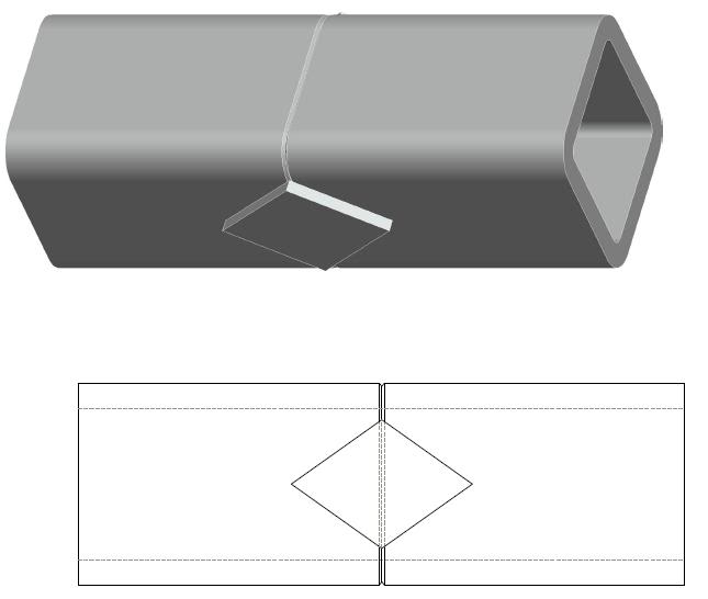

I bought a used machine and noticed recently that it has a cracked frame right before the front axle. I reckon that I tear down machine come winter, mig weld and fish plat weld over the crack. Does that sound good enough?

Make sure you use oval, or diamond shape fish plates. No 90-degree corners!

Ahhh yes, I am no welding expert but this is what I had in mind. FISHPLATE.jpg

Here are a couple good examples. Notice on the second picture how the welds are arced at the points of the fish plate?

Ahhh, never seen it welded like that.
Thanks.
