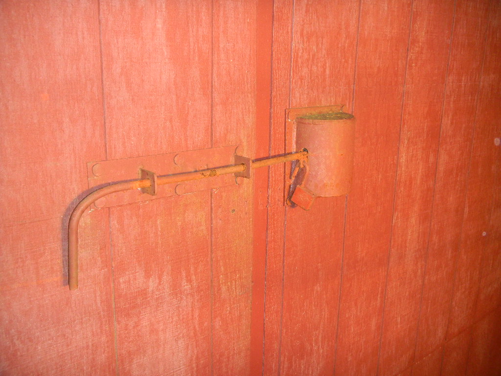

I like the bar through the wheel idea. Big enough piece of round stock would take some time to cut. I would try to incorporate a piece of pipe to protect the pad lock. We always did this on our tool vans / shipping containers.
Here is one I built years ago for my dad's barn.

Shield Arc and OP: Protecting the padlock is described as best as I could by the following:..." On the padlock end of the rod possibly another flange with an oversized hollow rod section with a hole drilled through it so it could slip on and protect the padlock from being accessed with anything but the key or combo"
I could 'draw' a rudimentary sketch if push comes to shove?!
/ welding high grade chain for security? #19
I think I can visualize what you're trying to say Coyote machine. I'm a big believer in protecting pad locks. I use to carry a 24-inch crescent wrench in the tool box of my company pickup. I can't tell you how many pad locks I've twisted off with that wrench with no effort at all.
