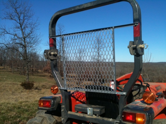

I have one of the cheap HF flux wire welders and I've only welded a couple things with it with decent results I thought. Now I want to weld a piece of expanded metal on the ROPS bar on my tractor to keep from getting my brains busted out. My questions are, where should I connect my welder's ground cable and do I need to be concerned about shorting out the electrical system on my tractor if I connect something wrong? Tractor is a 2016 NH Workmaster 33.
Yes, be concerned about shorting.
You should consider making a frame that is removable. The expanded metal can be welded to the frame and the frame bolted to the ROPS.
This is the best. Flat U bolts can be gotten from Home Depot online for moderate cost. I buy a lot of them. I put together an enclosed trailer with about 60 of them :)
As I said, I've only ever welded a couple things. Now we're going from tacking the expanded metal in a few places to hold it in place to a complete metal working project that I'm not sure I'm capable of at this point. :) I wasn't planning on ever folding the ROPS, but I guess I could split the expanded metal in the middle to allow that. Bolting on a removable frame may be the answer, though as I think there are some spare holes up there I might be able to utilize. Might be able to just weld the guard onto some angle iron that is wide enough to just clear those bolt holes and bolt it on that way. It would be nice to be able to take it off when I'm not bush hogging because I often turn around in the seat and grab the ROPS to keep my fat body turned around. :) Thanks for all the input guys. When I go over there Friday, I'll give it another look and see what I can come up with now that I have new information.
Making a frame and welding the expanded metal to it ON your welding table will be far simpler than repairing it when the tacks fail. And fastening with flat U bolts will be simple.
But I would first try just fastening the screen on with U bolts :)

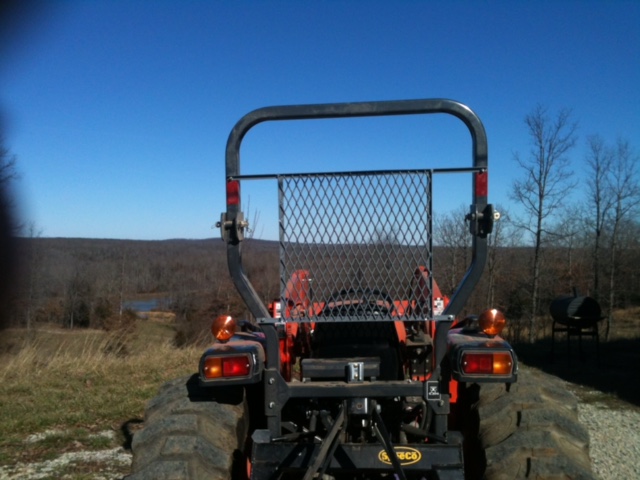

Here is what I was able to do on mine. When welding the expanded metal, just wash the puddle on to the wire or else it will melt thru. I have also used thick washers to hold the expanded metal and weld the washer to the frame. screen.JPG

Yep, I like the idea of clamping, bolting, zip tying something in place. Info on structural integrity of the ROPS is received, I had not thought of that. It's probably best that I use one of these solutions until I get a little more welding experience under my belt before I start trying to weld something directly onto my $20K tractor. :) I like your frame there Crystallake. I think my final solution will be something like that, but for now, I think y'all are right, a temporary bolt up will work just fine. Thanks for all the suggestions!
