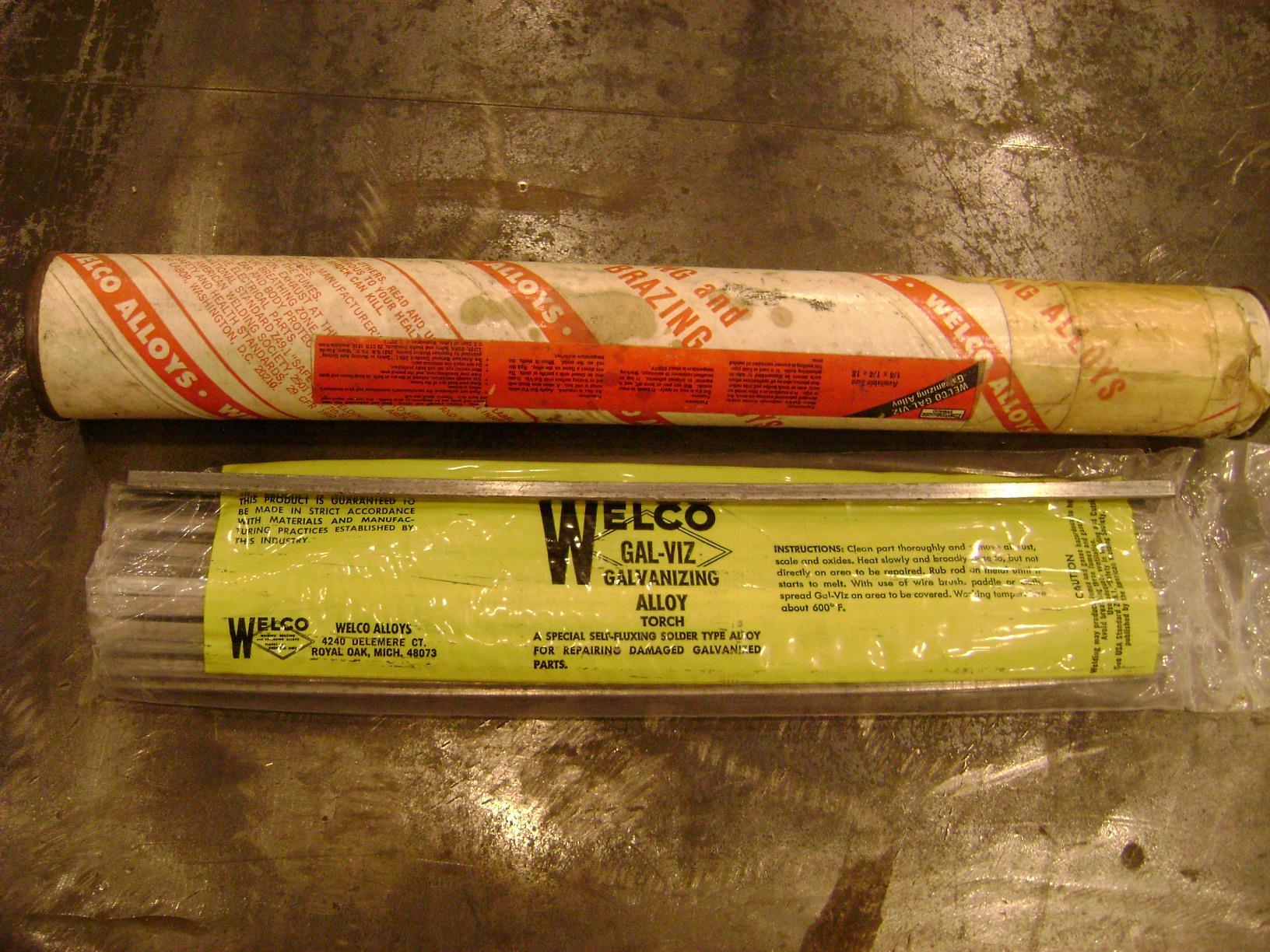

The first time I got nailed, I was working in a oil refinery. I had to O&A weld something galvanized. Apparently it was thin or I would have just stick welded it. Made me sick as a dog. Went years without welding anything galvanized again until getting into marine construction, then I would get steady diets of it at times. Welding it didn't seem to bother me as much as cutting it with a torch. I never had the luxury of an exhaust system, just had to depend on the wind and rain to knock the fumes down:laughing:! I'm sure it effects people in different ways, but the way it always got me. After getting home, taking my shower, eating dinner, and setting on the couch catching up with the family. It never failed, all of a sudden it was like someone stuck an ice pick in my right knee:eek:! Once I was over that, then it felt like someone stuck an ice pick in my nuts:eek::eek:! Then the cold sweats, and high fever would set in. Every once in awhile I would get the ice pick feeling in other parts of my body. Next day you would think nothing ever happened to me, other than a little tired because I didn't get a good night sleep.
In marine construction we always had to use this stuff to cover our welds, a lot better than the cold galvanize you get in spray cans, but very expensive! Just heat the area with a torch, melt one of these sticks in the heated area, and wire brush in.
