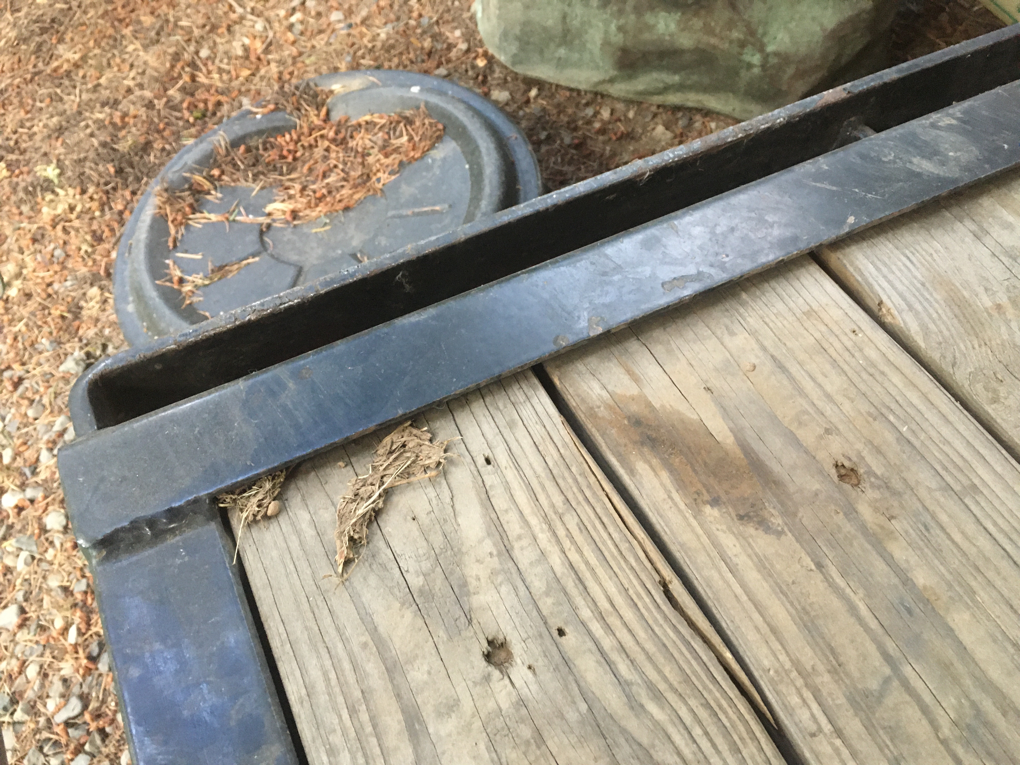

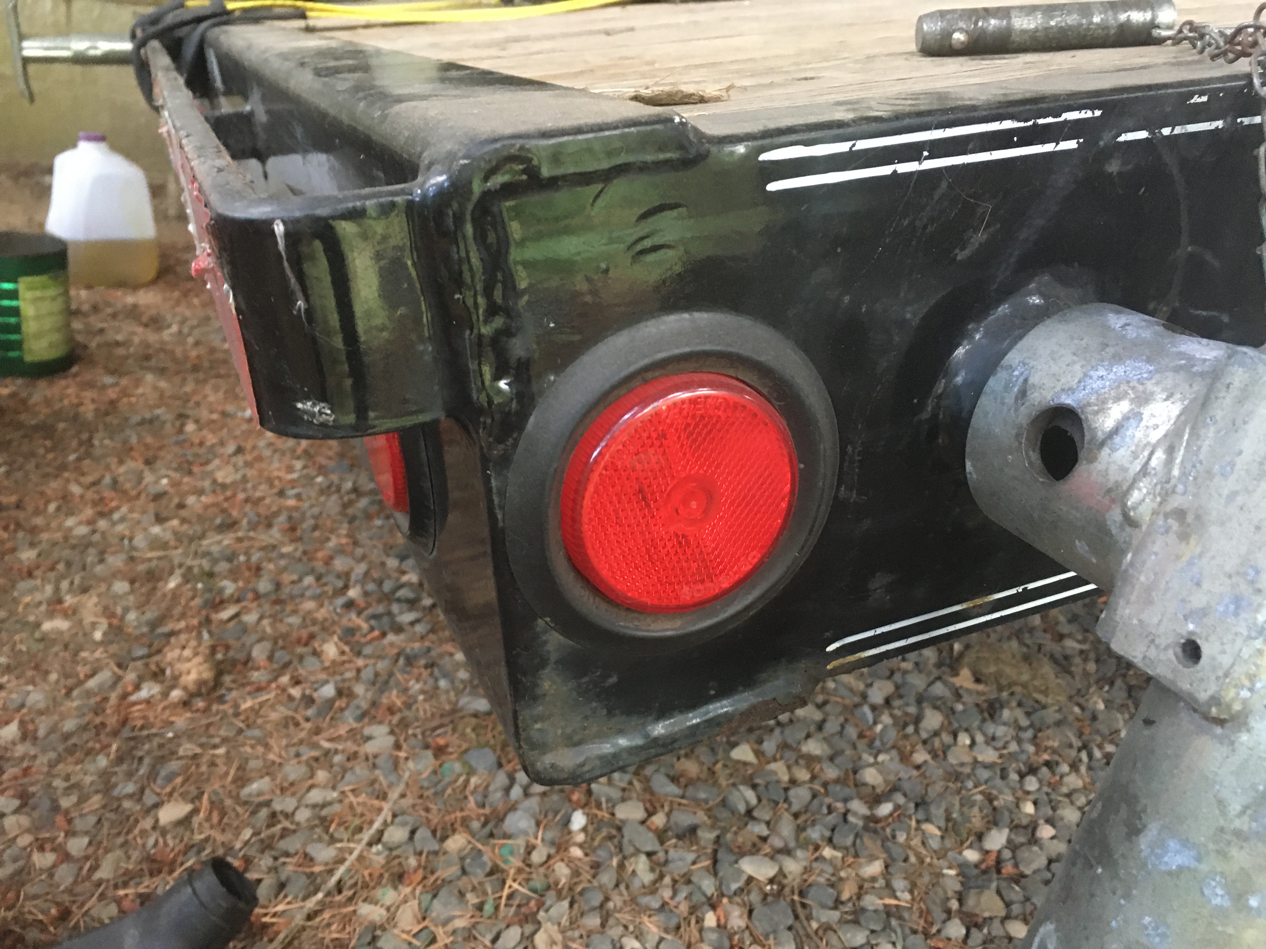

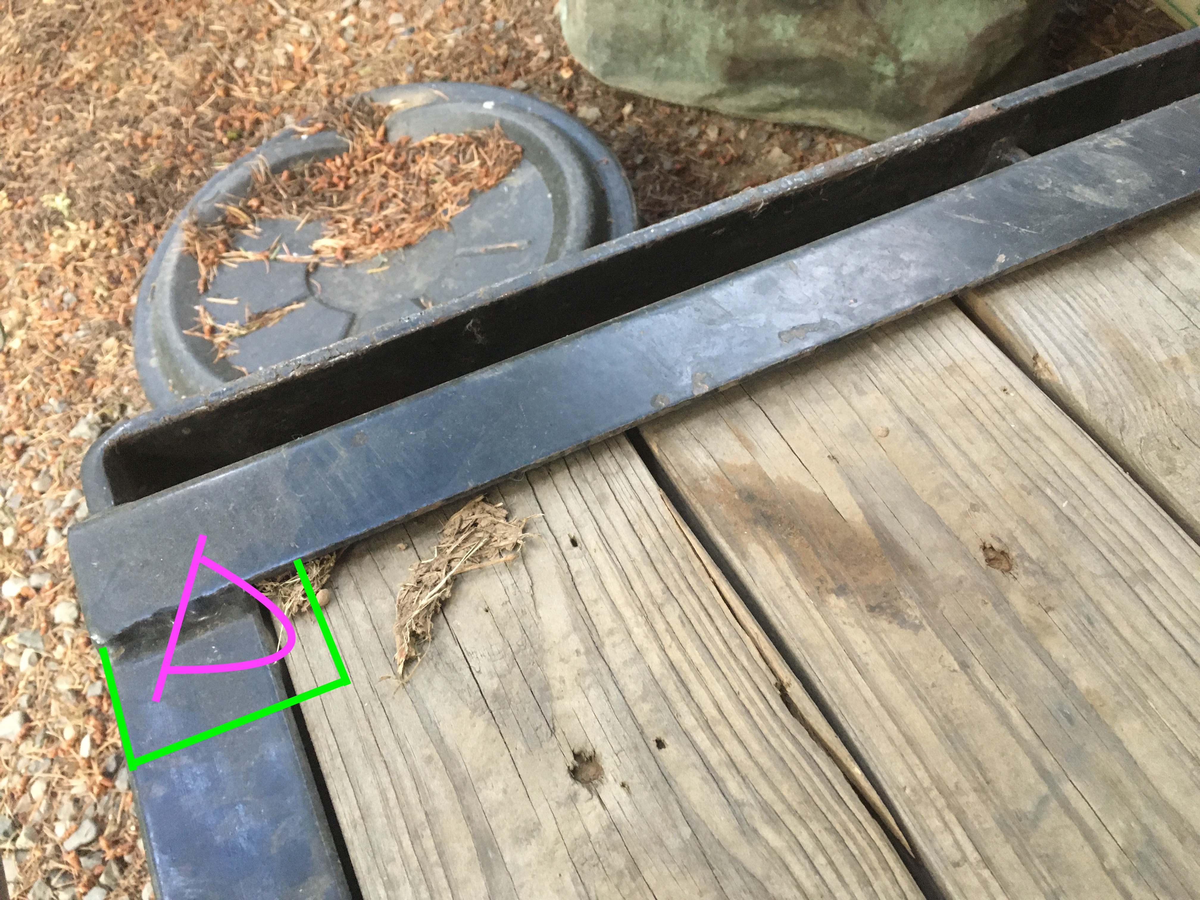

I have attached two photos showing the end piece of the trailer. You can see it is a piece of steel bent in two locations to wrap around the trailer's side frame channels. The thickness of the steel is 3/16".
I have looked at adding additional attachment points to the tractor but there doesn't seem to be a good location.
3Ts - I thought about attaching something to the steel bars that support the ramps but with the angle I am pulling I was worried about bending the bar in its weak direction. I could weld additional intermediate supports between the steel bar and the rear frame of the trailer but then my ramps won't be able to hook over the bar. The link you provided is interesting but unfortunately I don't have access to next forward steel cross member under the wood as the rear implement on the tractor is a butt plate for logs and it extends within a couple inches of the back of the trailer.

Thanks for the pictures. Can you not put the d rings right above the round clearance lights? I would maybe place them on top of the rear member at at 45 degree angle pointing towards the center of the trailer. In this location they would be directly above the heavy channel iron frame.
   / Welding D rings to rear frame member of 18 + 2 14,000 PJ equipment trailer #7
Maybe something like this? The green outline is a plate you could weld in to make the things level with the rear frame member. Pink would be the D ring.

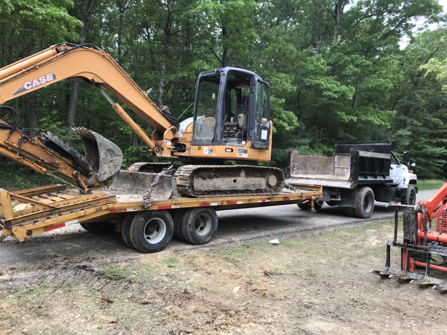

I’d hate to put 12,500 on my 14k trailer but then again I have no need to. It should handle it without any damage. I’ve put 19,000 on my 10 ton pintle trailer but the pintle trailer is built for a beating. Most of the regular trailers aren’t. The 10 ton weighs 5500 pounds and the 14 is about 3,000 so there’s a lot more steel in the heavier trailer. IMG_8754.JPG
