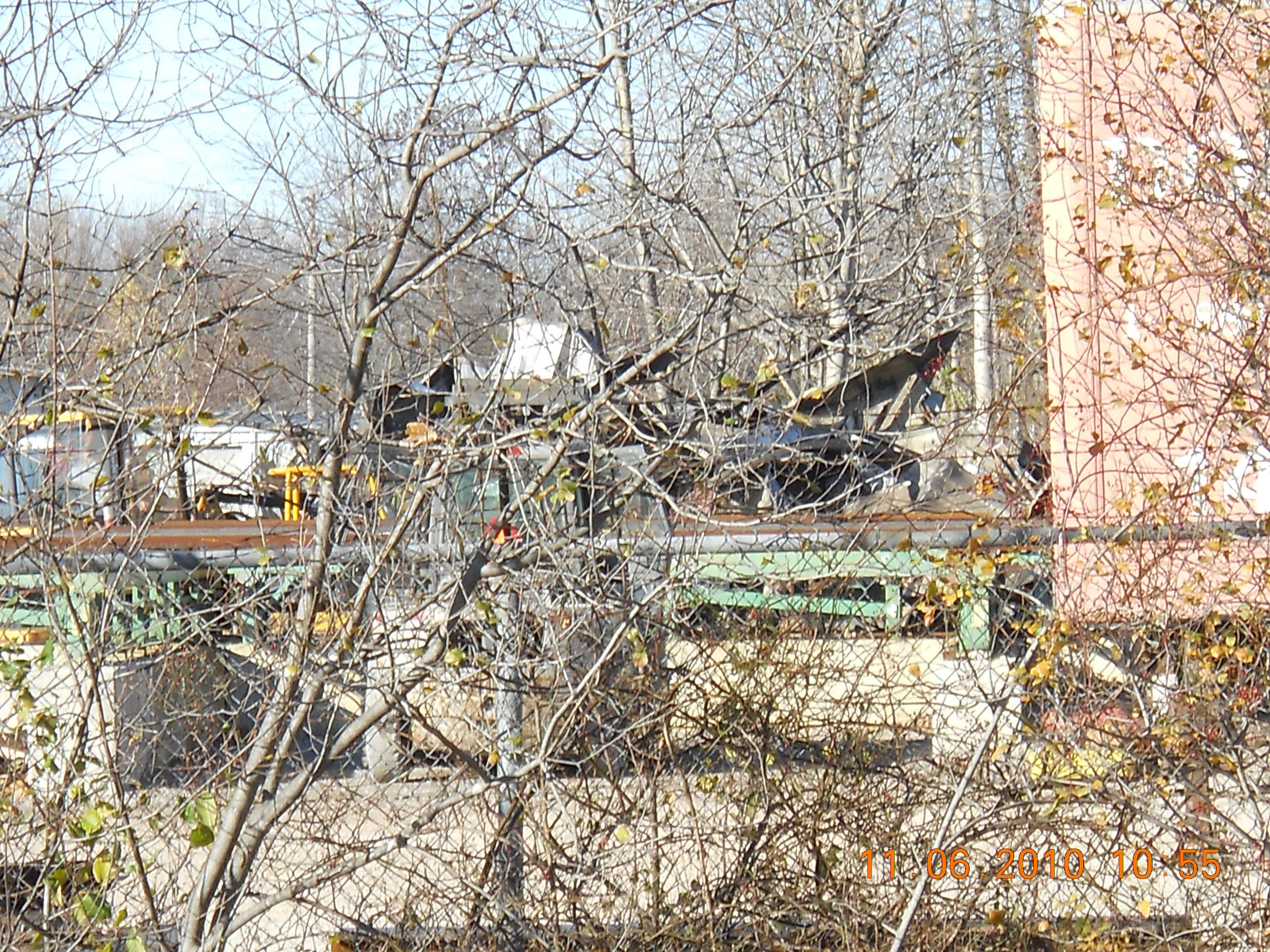

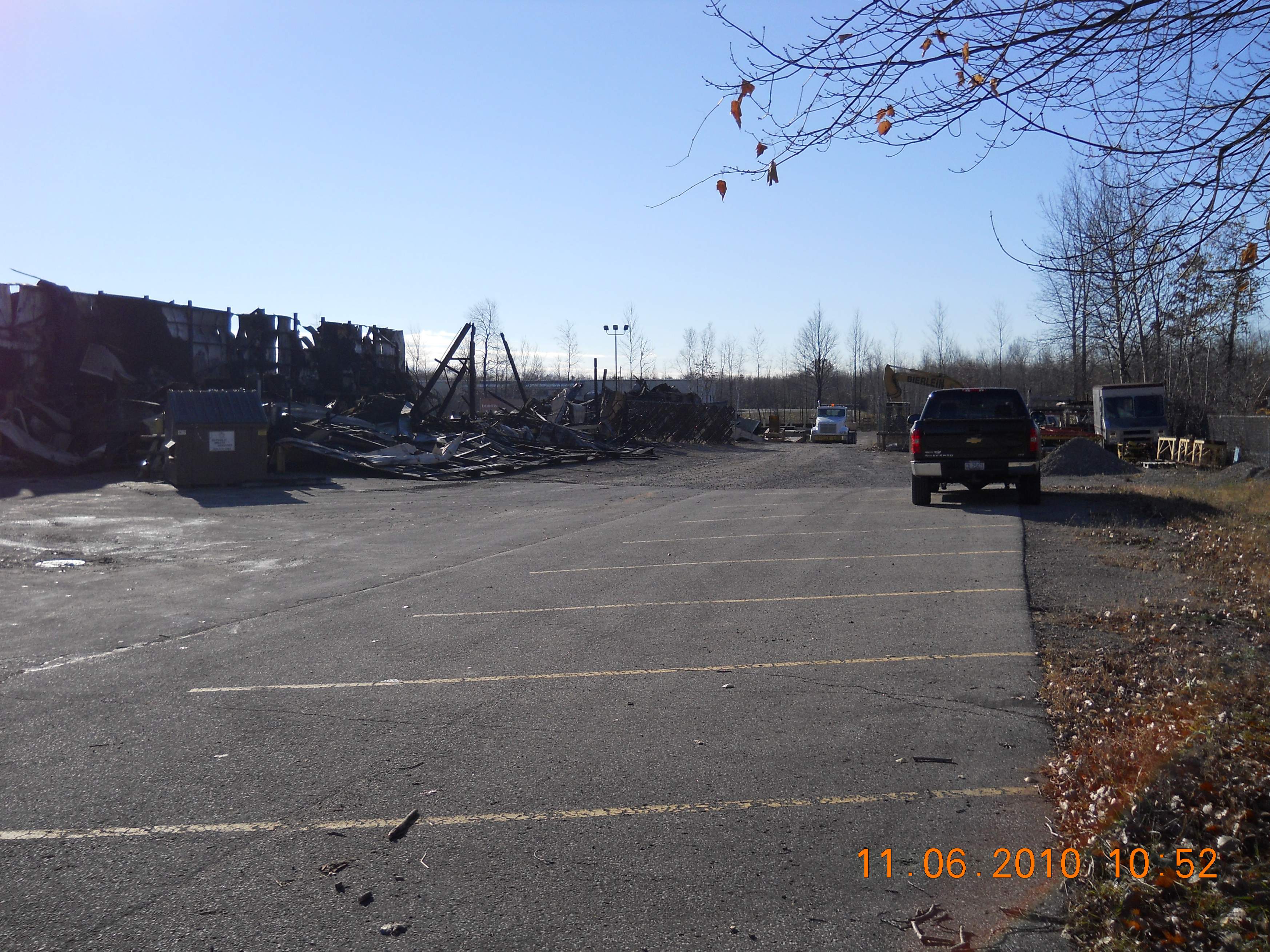

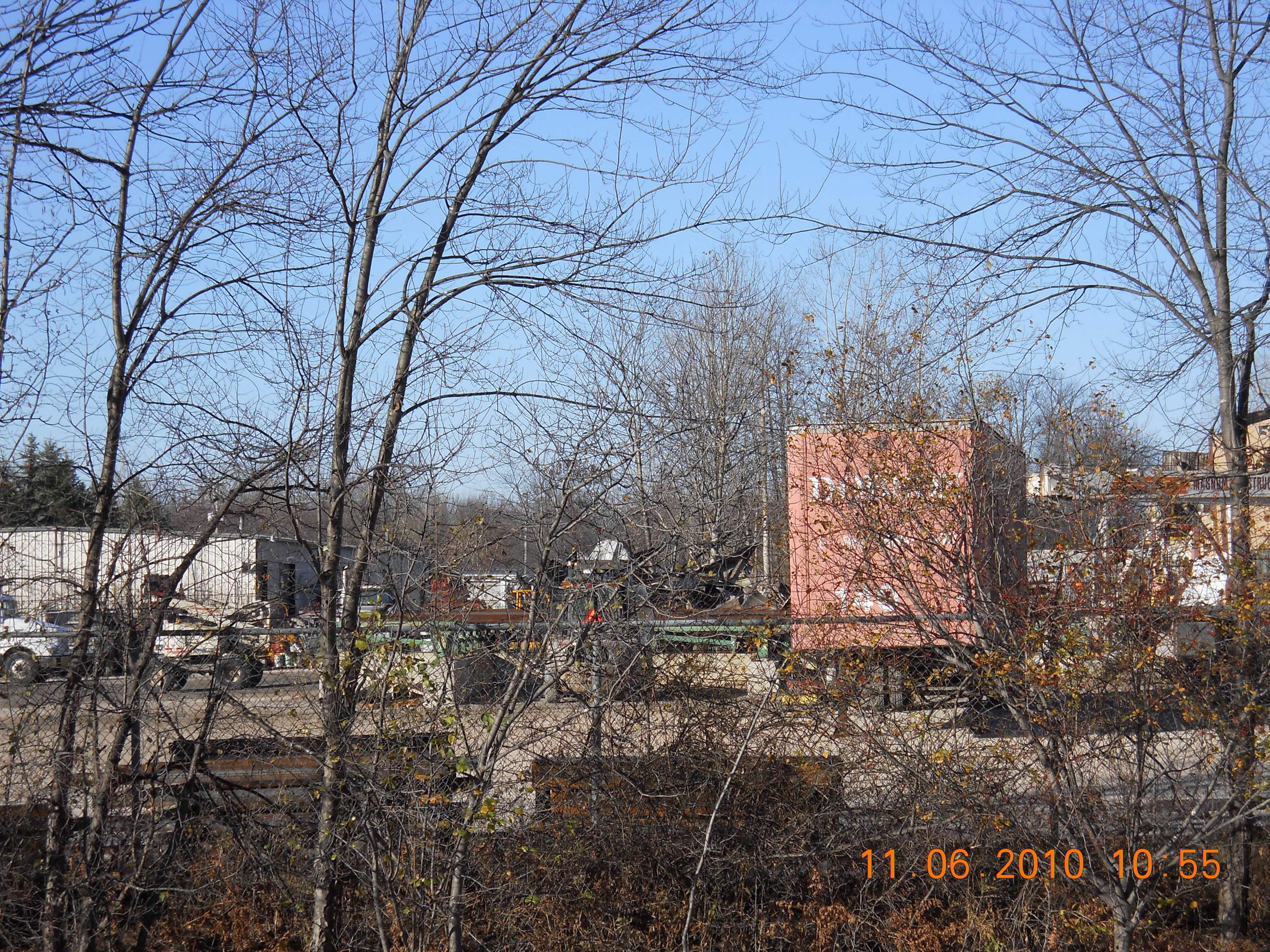

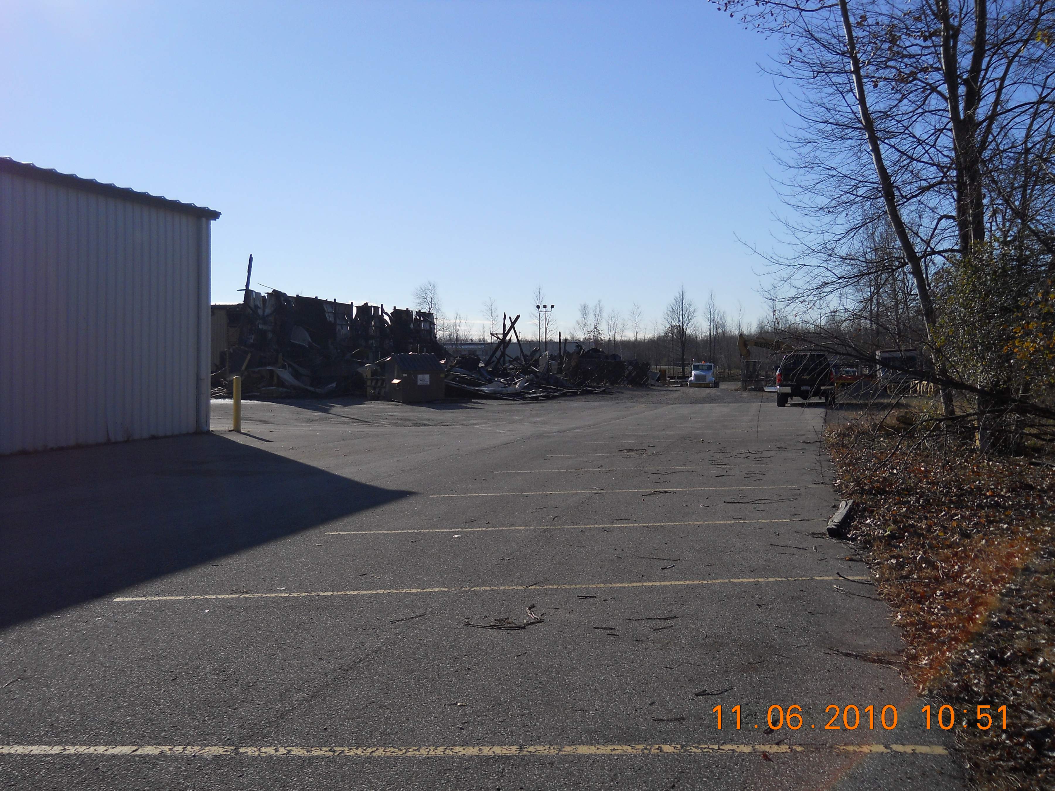

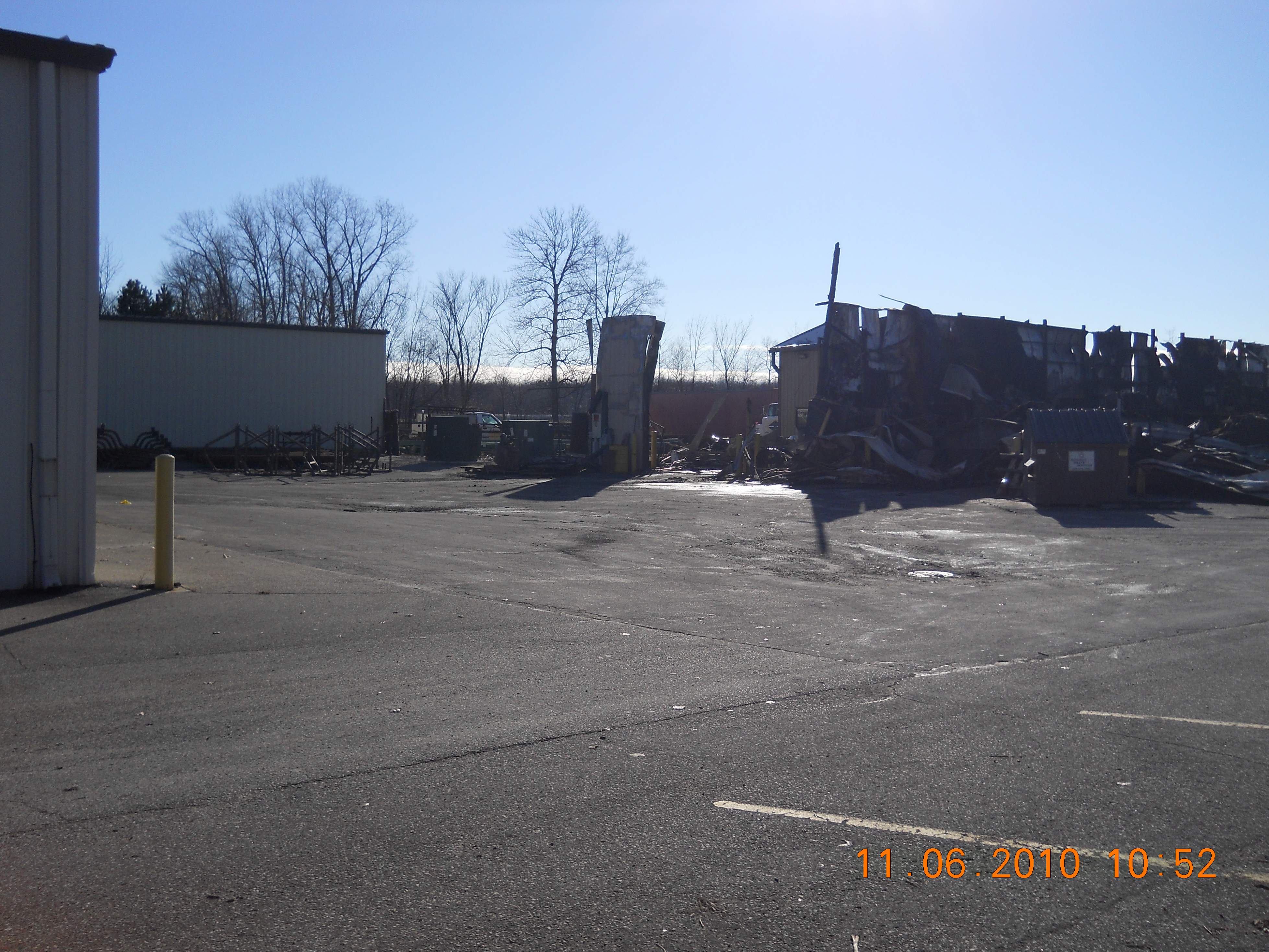

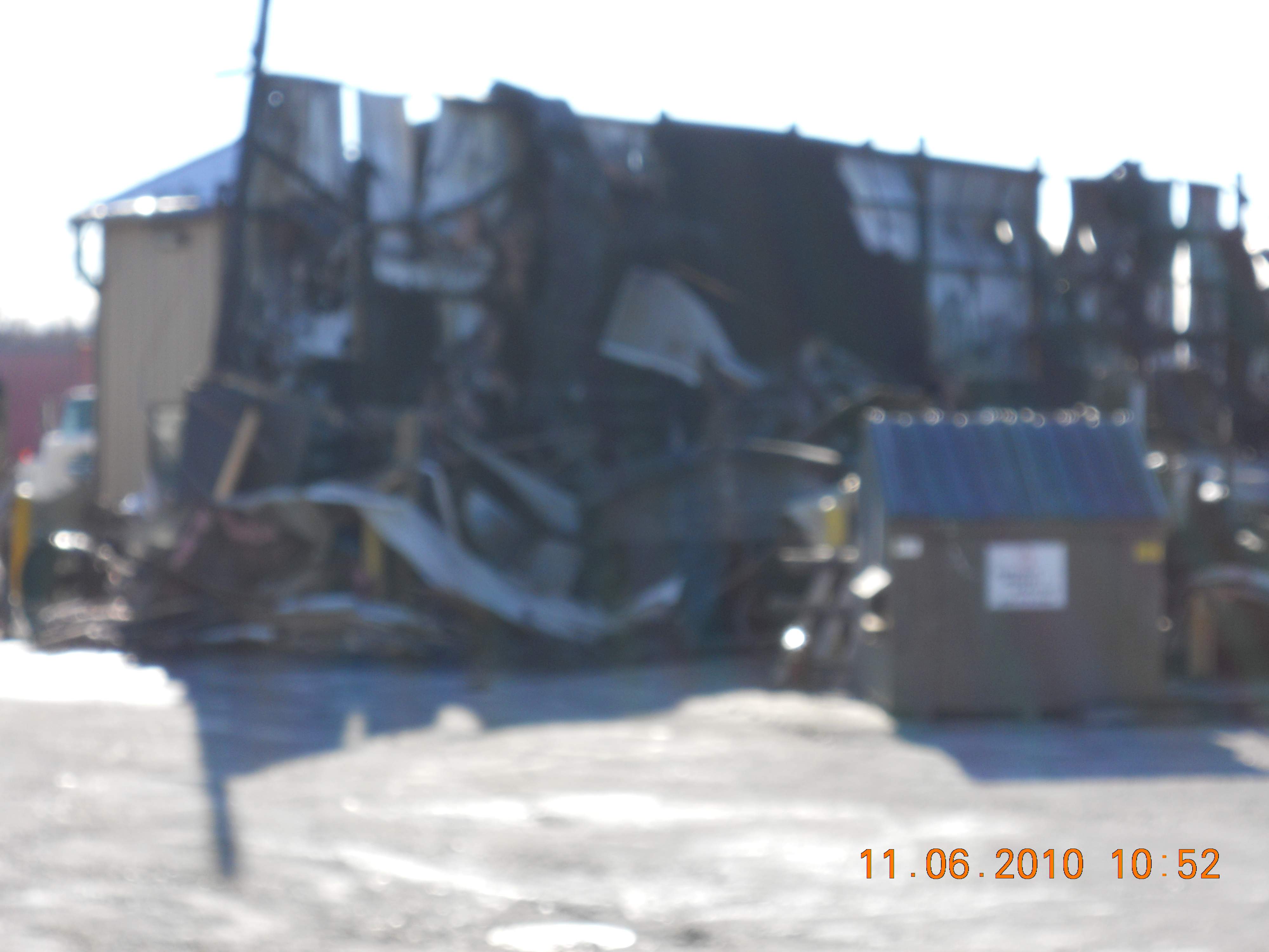

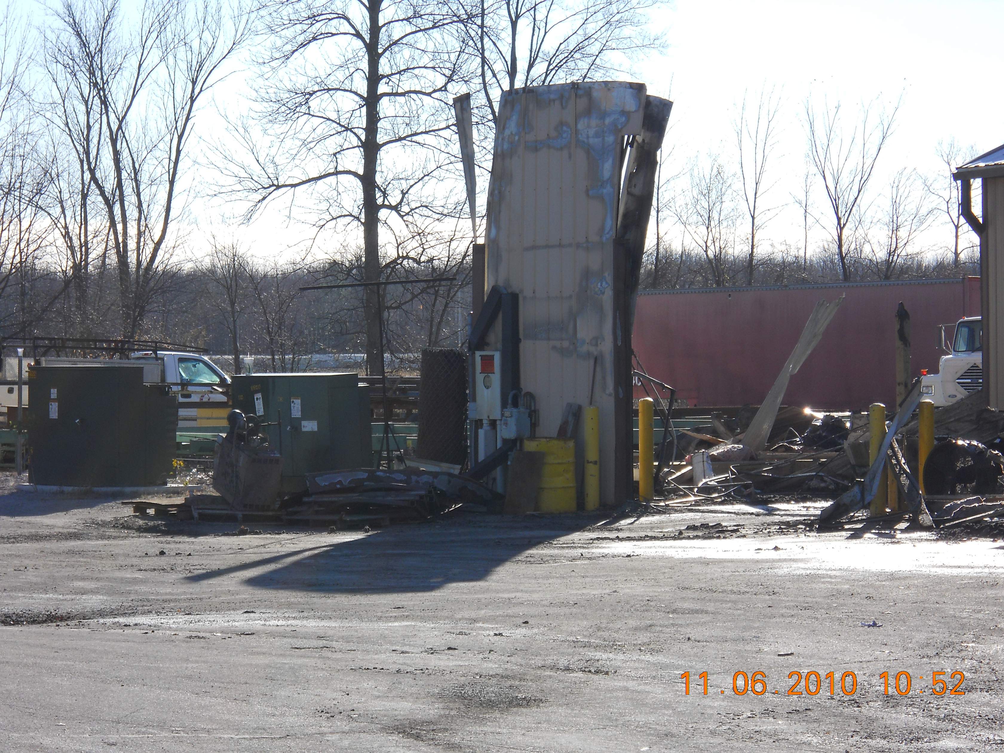

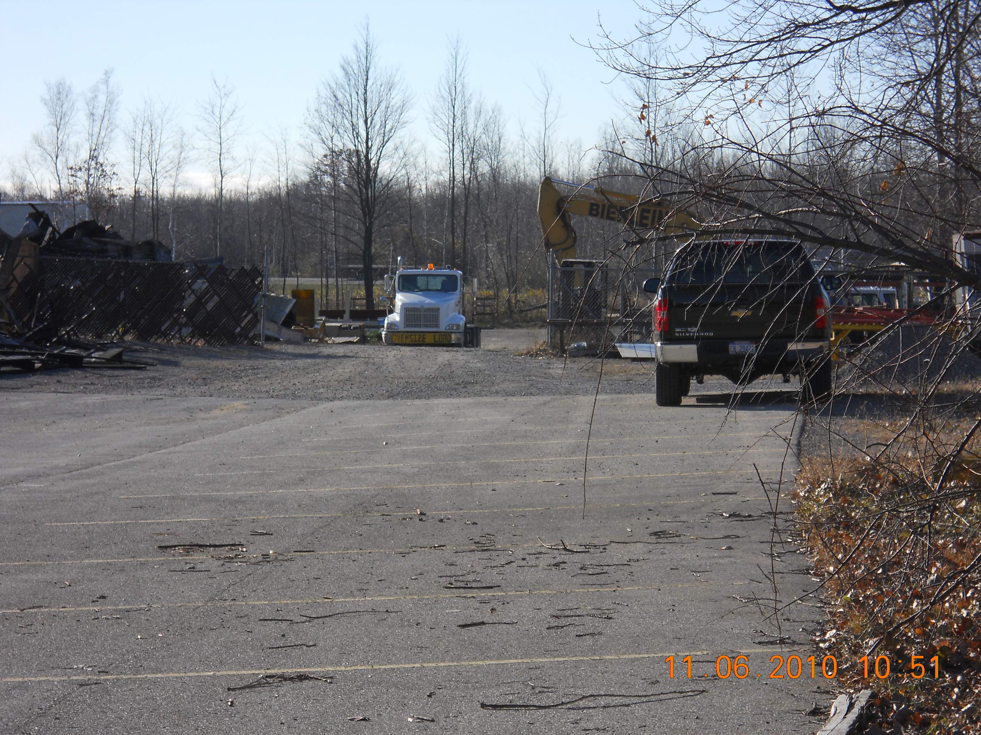

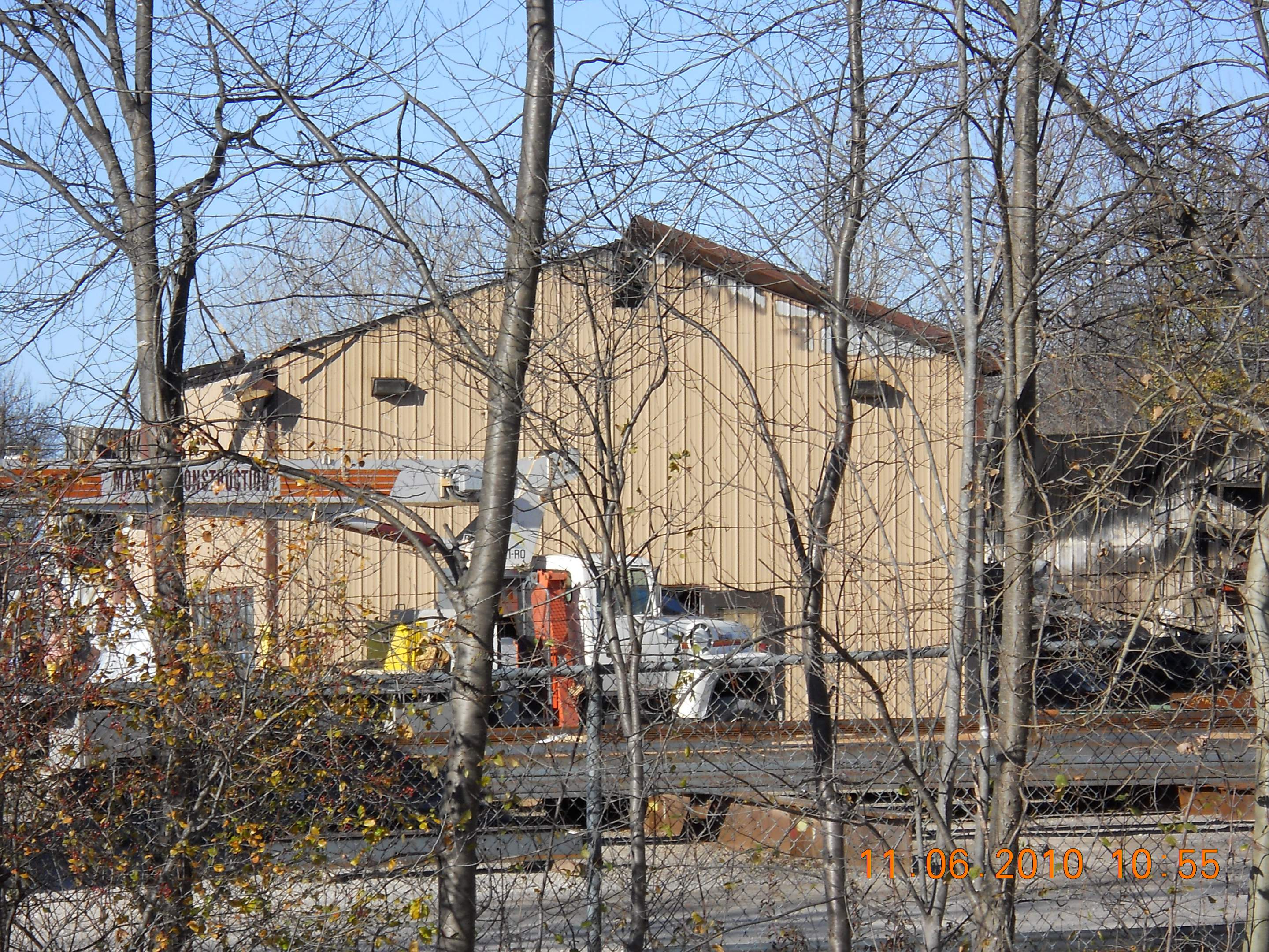

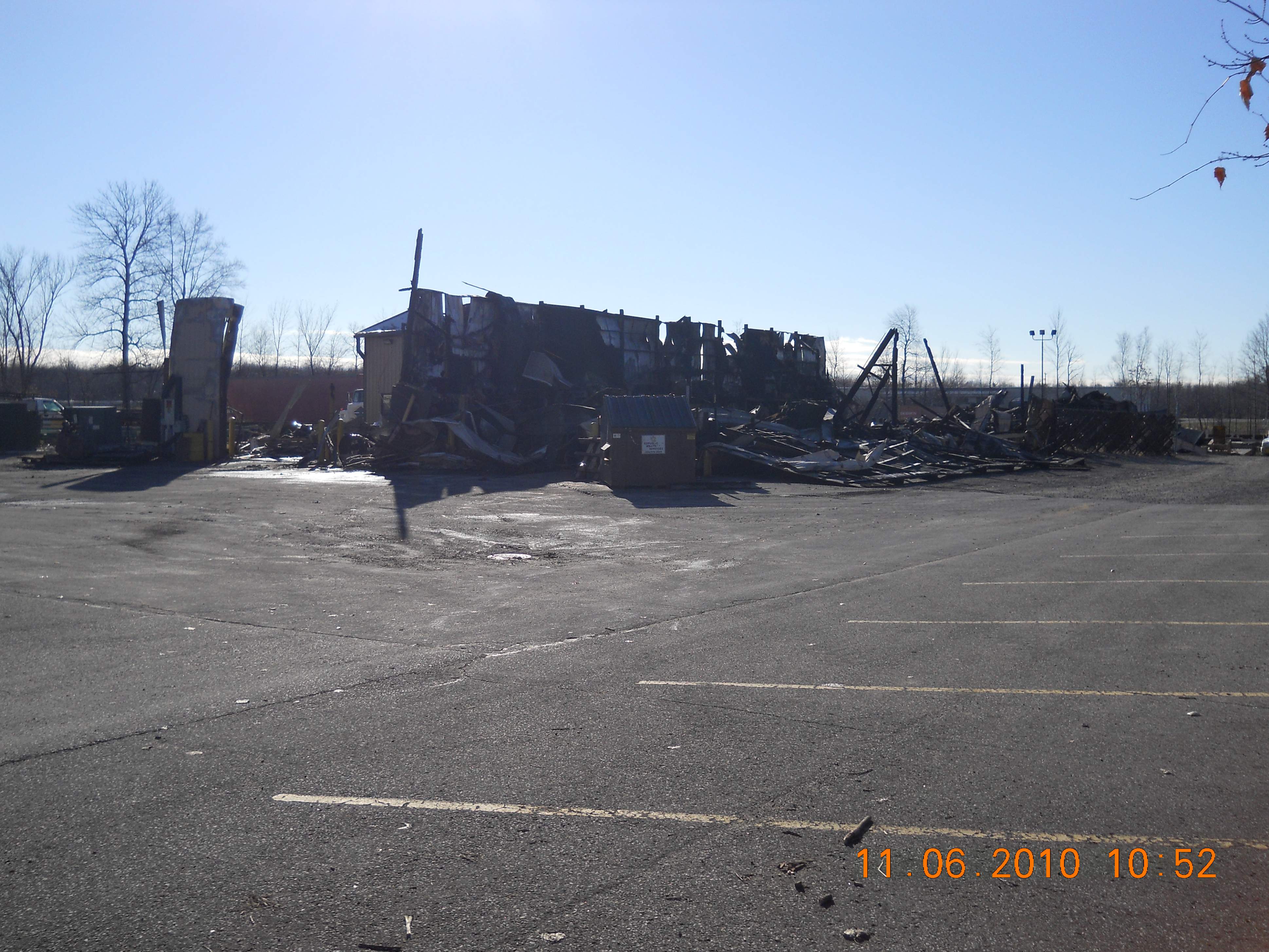

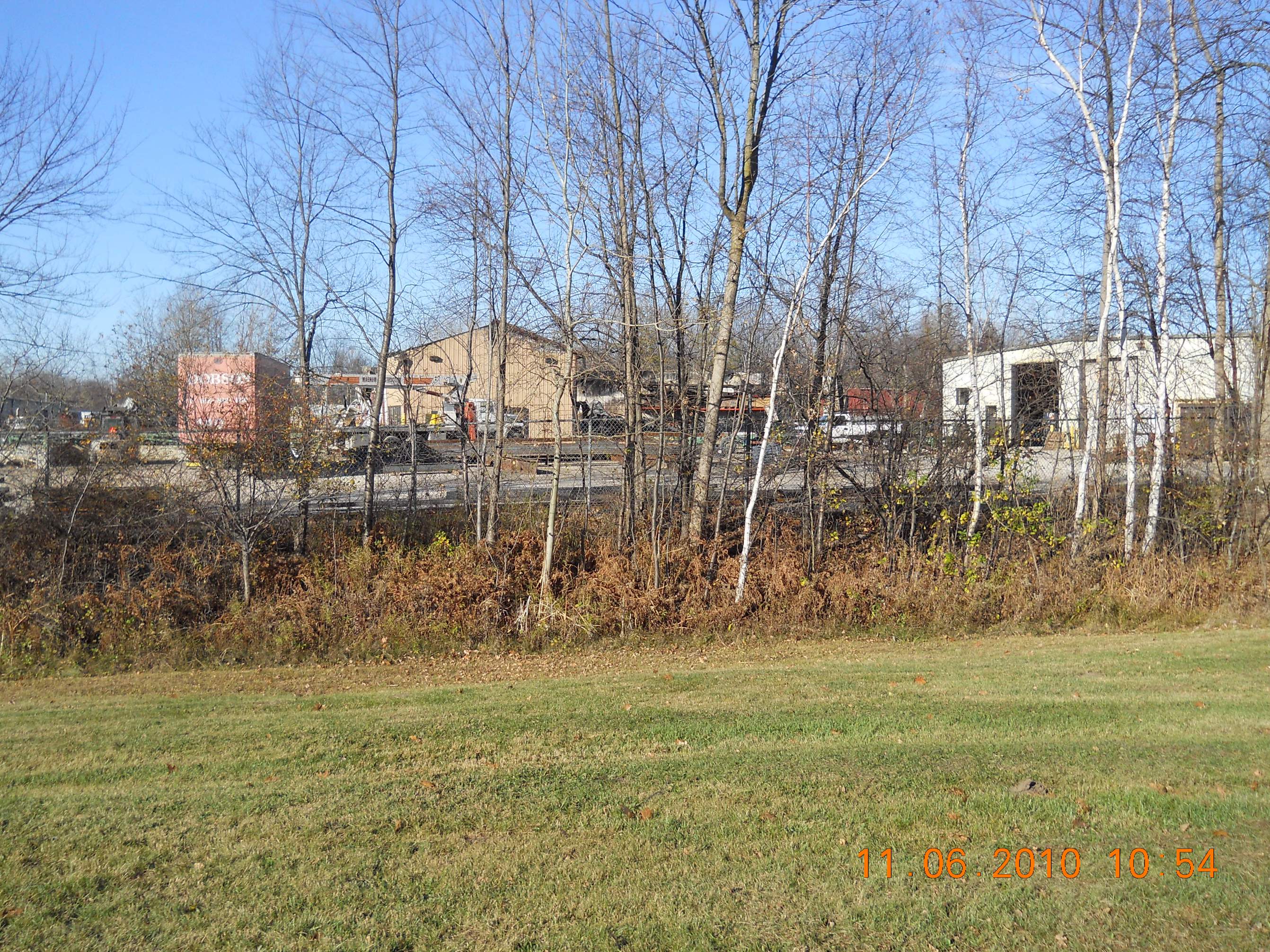

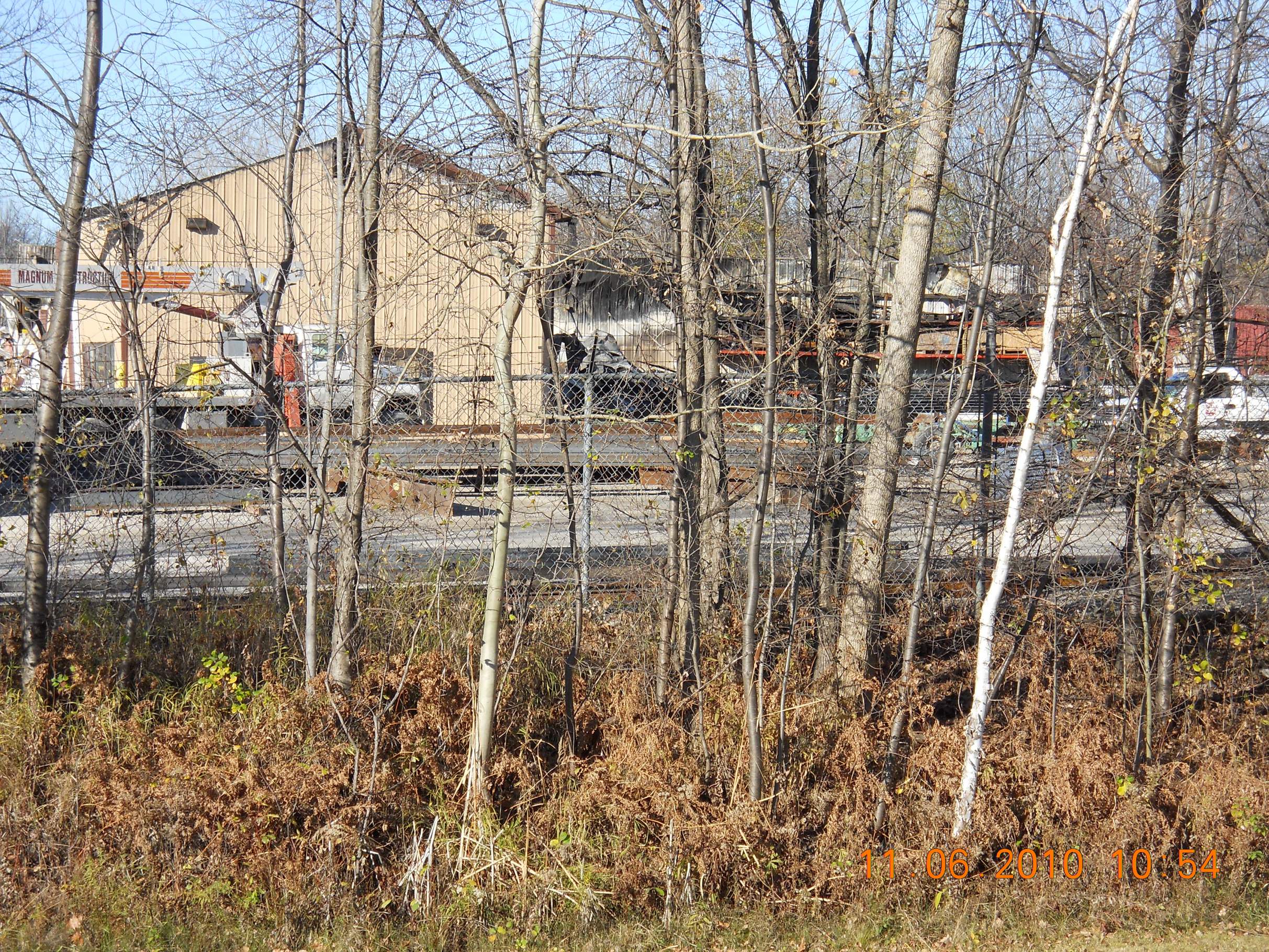

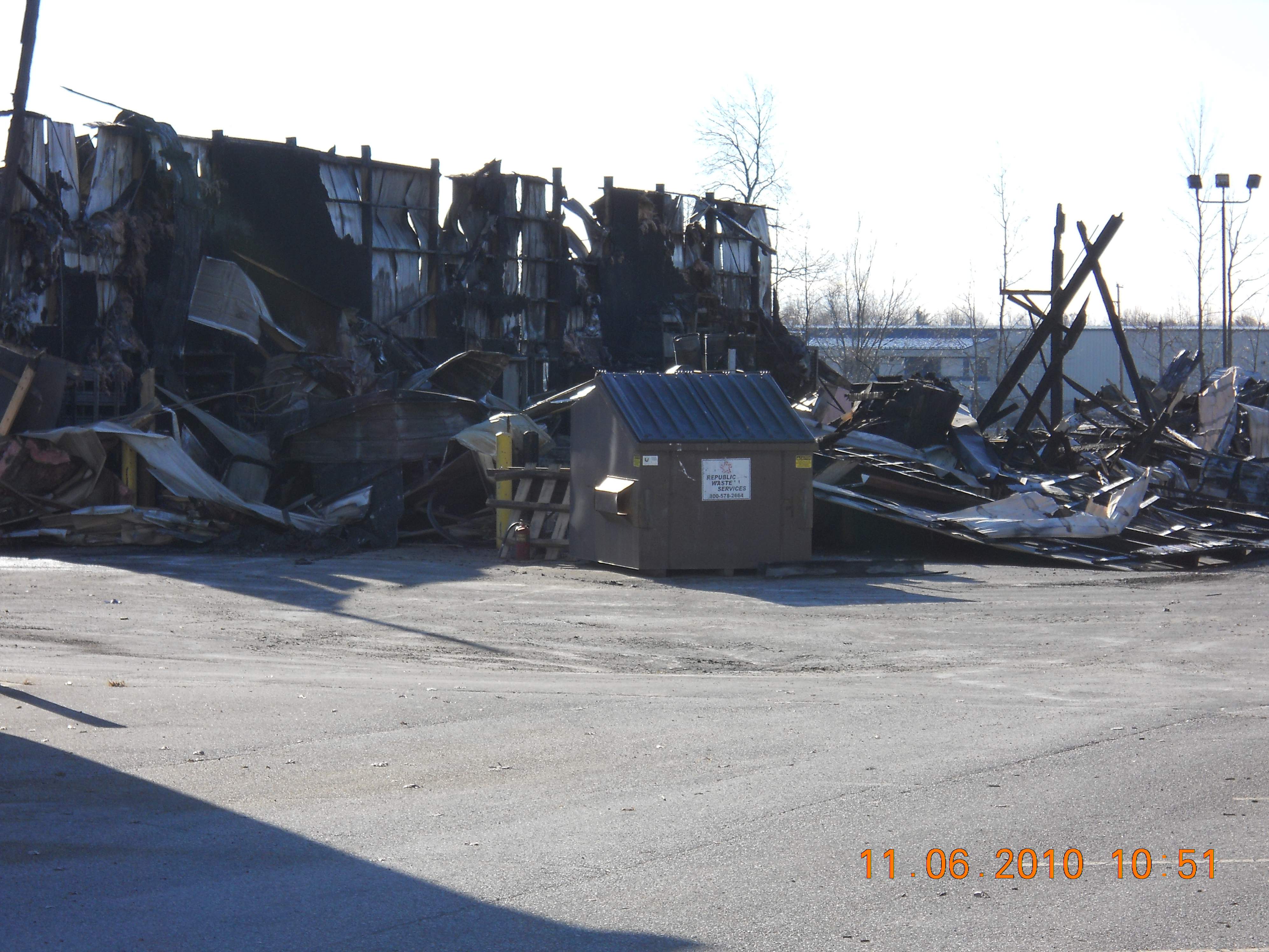

Word of caution.
These photo's are what welding on a vechicle's floor inside a building unsafely can look like.
In my neighborhood 2010?
It's hard to stop a train also to put out a pickup truck on fire
