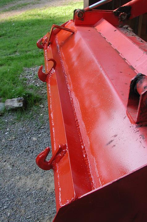

I just got a 3830 with Quick detach 723 FEL, Hydrostatic 4WD. And I got a good used Bushhog brand bushhog, a hay spear for the quick attach, canopy, R4 tires filled, delivered, tax and all for $21,600 and 3 year 0% fin. Thought it was a good deal. Anyway, how about welding a chain hook or two or three across the top of the bucket to lift, pull, etc. did know about hte torsional strength or limits. This thing is STRONG for it's size, but don't want to tear up anything.

I put one on the center of the bucket on my L3830. I have yet to need one on the ends. I suppose it depends on what you do. I don't like lifting from just one side of the bucket for the reason you mentioned. There are folks I'm sure that would make use out of hooks on both ends with 2 chains setup.
/ Welding chain hook on bucket? #3
I had three hooks on the bucket of my 670. One in the center, one on both ends. That gives you all the versatility you nedd or, you can spread to load more when necessary.
I had three hooks welded on the 790's bucket prior to delivery.
/ Welding chain hook on bucket? #4
The dealer installed 3 on my bx. The outer 2 are angled. They removed the level indicator, and a piece of 2x4 angle was welded solid across the back of the bucket. The hooks (weld on type no loops) were welded to the top of the angle. It looks like it came from the factory that way.

<font color="blue"> BRIGUY,
Any chance of getting a photo of your set up? </font>
I did something similar to what BRIGUY described. Here is a shot of mine...I left the level indicaton on though... /forums/images/graemlins/smile.gif

PJ my setup looks similar to Henro's job except his looks like 2x2 angle. Mine is 2x3.5" angle. The 3.5" is on the vertical attached to the backside of the bucket. I'm not sure why they removed the indicator. It looks like it could have stayed. I was going to do it myself but 150$ seemed real reasonable.

Thanks for all the info and the pics. I have a buddy who is going to weld it on for me and I wanted some veteran advice on it. Amazingly, the dealership sent a mechanic out due to a leak on the FEL and we asked him about welding hooks on. He said he would do it in a heartbeat, and then proceeded to mark where to put them. He said to put two, one on each side directly in line with the arms of the loader, and one in center. Then you could pull/lift with any of them. Oh well, center sounds best to me with displacement used on heavier loads by using two outside hooks. Thanks again.

Thx for all the comments. Dealer is coming out to replace a cylinder, so I called and asked about the hooks. He is goingto send along three hooks and the welder to do the job for me. He has been great to work with, and I would rather him have the liability for the welding versus me.
