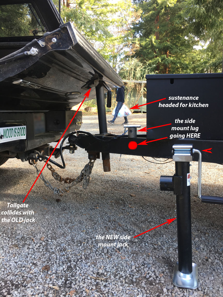

Just another simple project for the forum.
Welded with a portable Miller MultiMatic 200 MIG/TIG/Stick using the MIG & C25 gas
Settings? Haha, I just chose the factory setting for ---> 1/4"
544697d1521528043-welding-side-mount-jack-onto-img_1114-jpg
Tailgate hits jack when the trailer is attached.
Pretty much can't open tailgate, unless you have a rag or something to prevent damage.
This trailer was made in 1998.
How could they sell trailers like this?
Were tailgates ever that short?
This jack was only $46.95 with free shipping. Included the weld-on lug and the pin!
(5,000 lb. Side wind Ram tubular swivel jack with weld-on pipe mount. 15" travel by Southwest Wheel)
544698d1521528043-welding-side-mount-jack-onto-img_1114-jpg

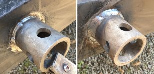

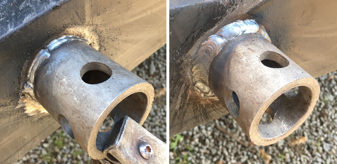

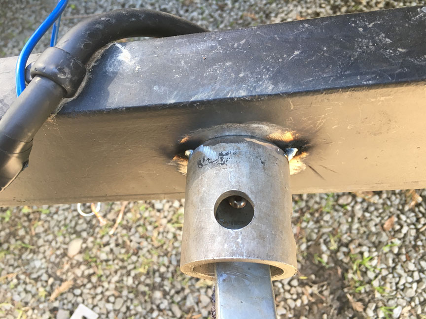

Beveled the side mount and ground off the paint. Tacked side mount.
544699d1521528043-welding-side-mount-jack-onto-img_1114-jpg
Root weld and cover weld.
544701d1521528043-welding-side-mount-jack-onto-img_1114-jpg

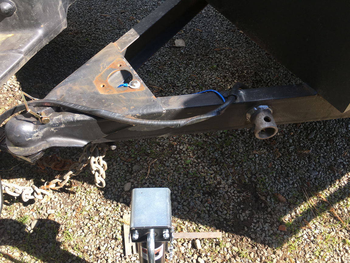

Welding done.
544702d1521528043-welding-side-mount-jack-onto-img_1114-jpg

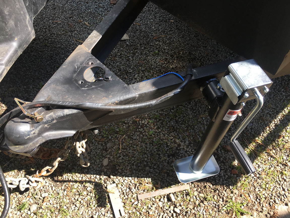

Painted.
544703d1521528043-welding-side-mount-jack-onto-img_1114-jpg

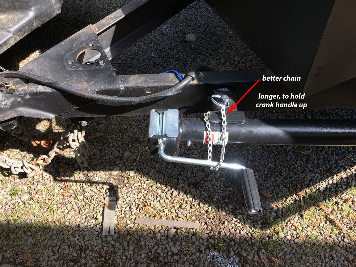

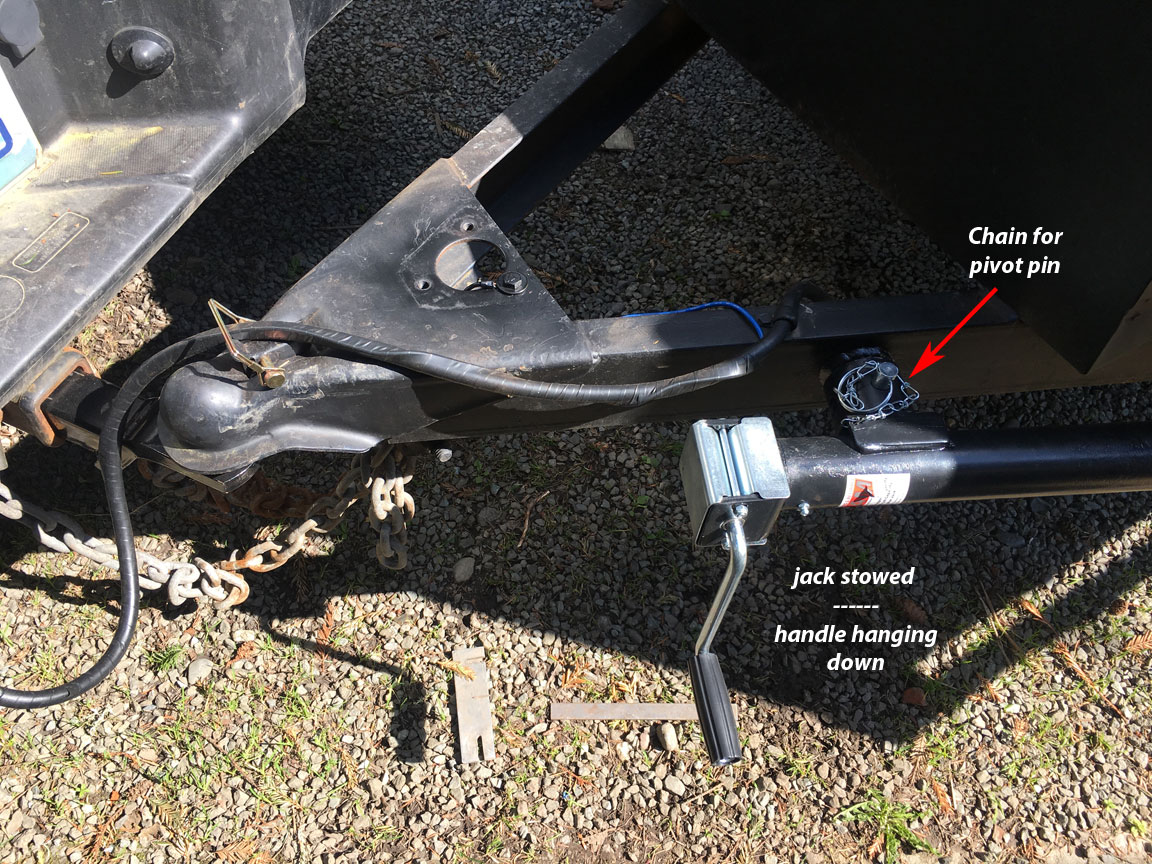

Jack pivoted, stowed. Handle falls down by gravity.
544704d1521528043-welding-side-mount-jack-onto-img_1114-jpg
Using the pin-chain lanyard to support the handle.
544705d1521528043-welding-side-mount-jack-onto-img_1114-jpg

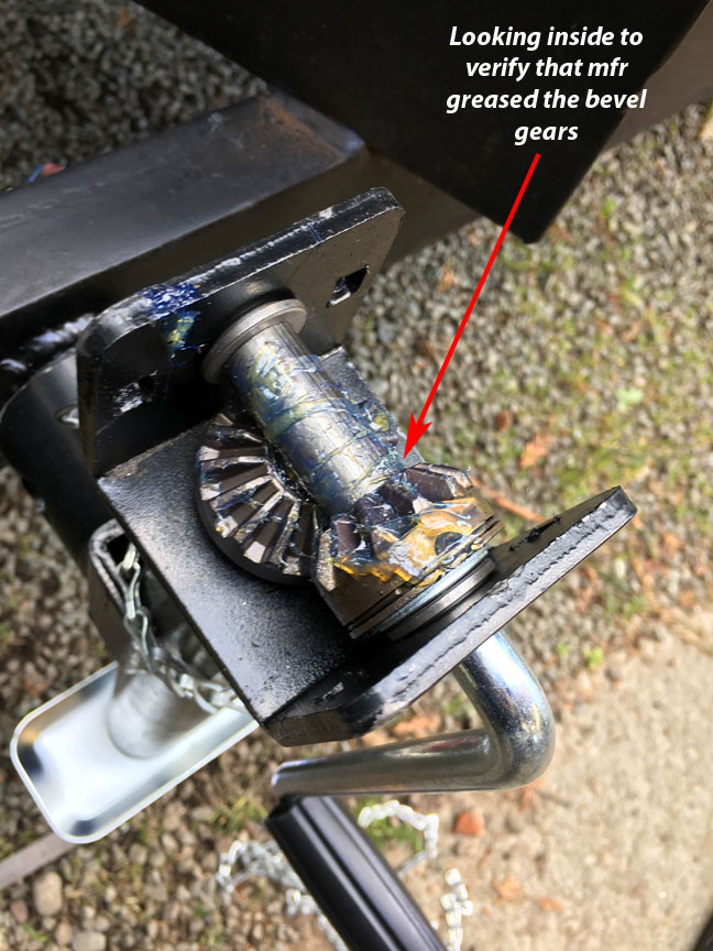

And finally, just verifying that the jack's bevel gears were greased by the mfr.
I had doubts that at $46.95 and free shipping,,,, they could afford to grease it, but they DID! ...:cool:

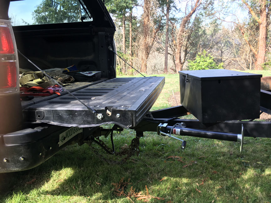

Thanks guys, glad you like it. Surprised though; not a single naysayer. We'll see what we can do about that.....heh heh.
Now, in use I've realized what a hassle it **was** having that centerjack blocking me from stepping over the trailer tongue.
Which happens often in a landscaping scenario.
545004d1521657376-welding-side-mount-jack-onto-img_1161-jpg
AND when the tailgate is perched on the center jack, EVERYTHING you WANT, is out of reach, cuz you can't put your weight on the tailgate to go after it.
545005d1521657376-welding-side-mount-jack-onto-img_1161-jpg
Much better now.
