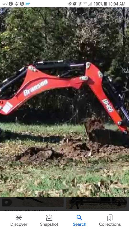

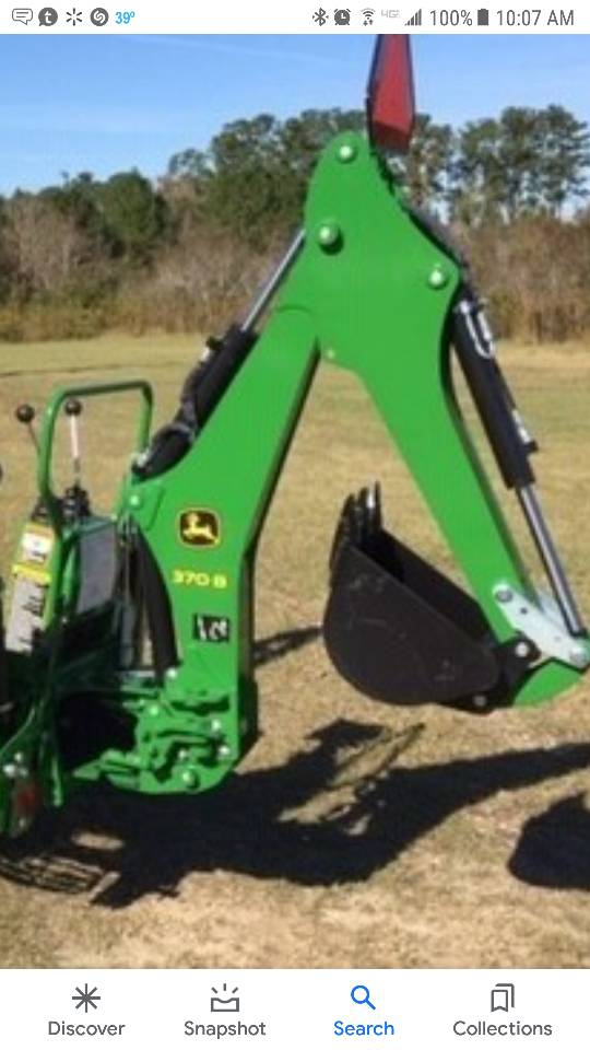

The design of those mounting ears is, ummm, how do is say this politely. The design of the mounting ears sux. Best to just toss them and start over. There are reasons that cylinders are mounted on doublers with long triangular bases to spread the load over a greater area. Especially the dipper stick and bucket cylinder mounts. I have never seen a dipper stick cylinder mount like this. See pics for reference. Do you have an overall photo of the boom and dipper?
Unfortunately this repair needs more than just welding the original part back on. This also really needs stick welding or high power MIG to get the proper penetration. How soon can you have 230v power? Do you have a 230v generator? Can you borrow or rent one?
But there is still the basic issue of the design of the cylinder mounting ears. These need to be redone to have any hope of surviving. If you manage to get good penetration, i predict the base metal will tear out (again).
View attachment 725815View attachment 725816

The factory mounting lugs were not the best design. Should have bigger base flares to distribute the forces. Consider making new mounting plates.
The repair welds are too cold and not penetrating into the boom steel. Poor Technique or welder settings.

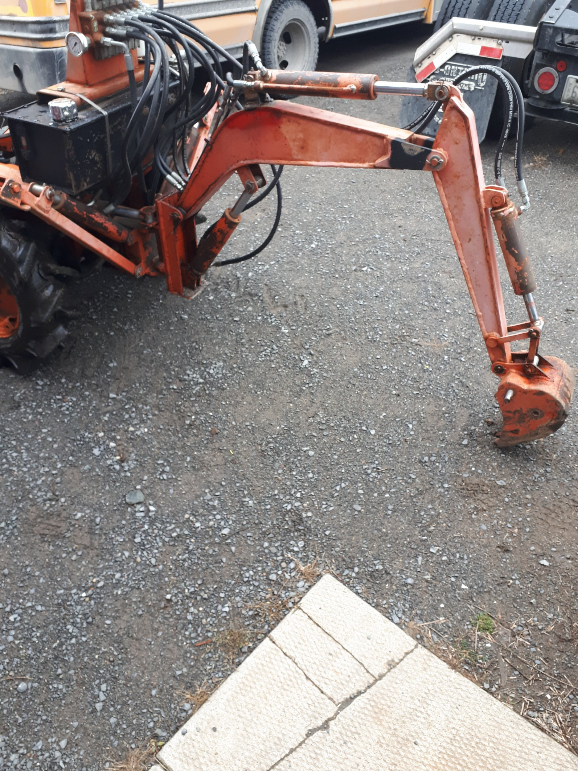

Here are a couple pictures from the OP's backhoe he shared on another thread. The broken mounts are the ones for the dipper cylinder.
It's a small backhoe and those cylinder mounts are just fine for this application. Just needs to get properly welded and it will be good to go again.

Thanks Pedro. That's what we needed. I agree the tabs could be properly welded and they would stay. With that said, it would also be easy to brace them with pie shaped pieces and triple the strength pretty quick.
