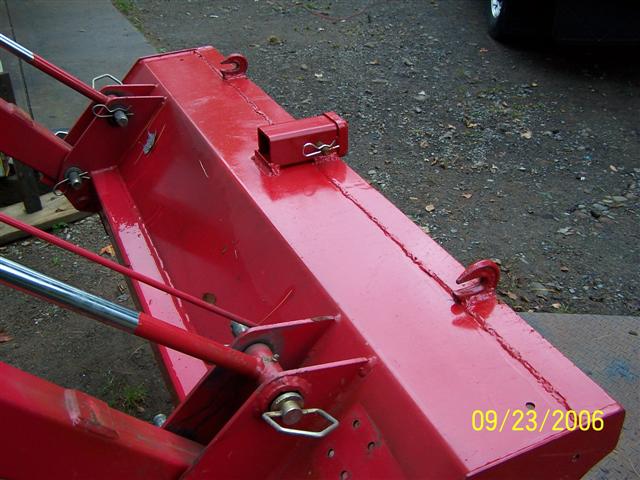

I'd re-enforce the bucket with a piece of angle to weld anything to. I welded a 2x2 angle across the top edge of mine then added my grab hooks and receiver. Without the extra metal thickness you are going to bend the bucket if you put any stress on it.

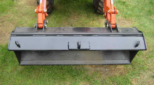

In addition to putting a reinforcement plate under the chain hook/clevis, consider the placement carefully. I had three hooks put on my bucket, left right and center. That seemed a good idea at the time to maximize flexibility in chaining odd objects. However, when I started to think about getting a bucket grapple, the position of my center chain hook precluded using a couple of the grapple styles. It is not the biggest consideration but something to keep in mind. Some of the least expensive grapple attachments bolt on to the top bucket lip. You cannot do that if there is a chain hook in the way. Putting two hooks on either side would not interfere. There are also other bucket grapple styles that can be modified to work even with center chain hooks (ATI and Add A Grapple come to mind).

The top lip of your buckets are much wider than on mine. But even so, it might make sense to mount hooks on the back of the bucket rather than on the top lip. In my case, where the bucket mounts are, there is another plate about 3/8" thick and I welded my hooks on there. You can see it real good on George's picture a couple posts up. It also puts the hooks near the loader arms. I always use both hooks. Another advantage I found is by having the bucket fully dumped and hooking the chains up, I get an extra lift out of curling the bucket up.
Here's a picture showing the location on my bucket. It was when I was adding on my grapples. They also don't get in the way of the grapple mounts back there. It's still a good idea to reinforce the top lip though.
