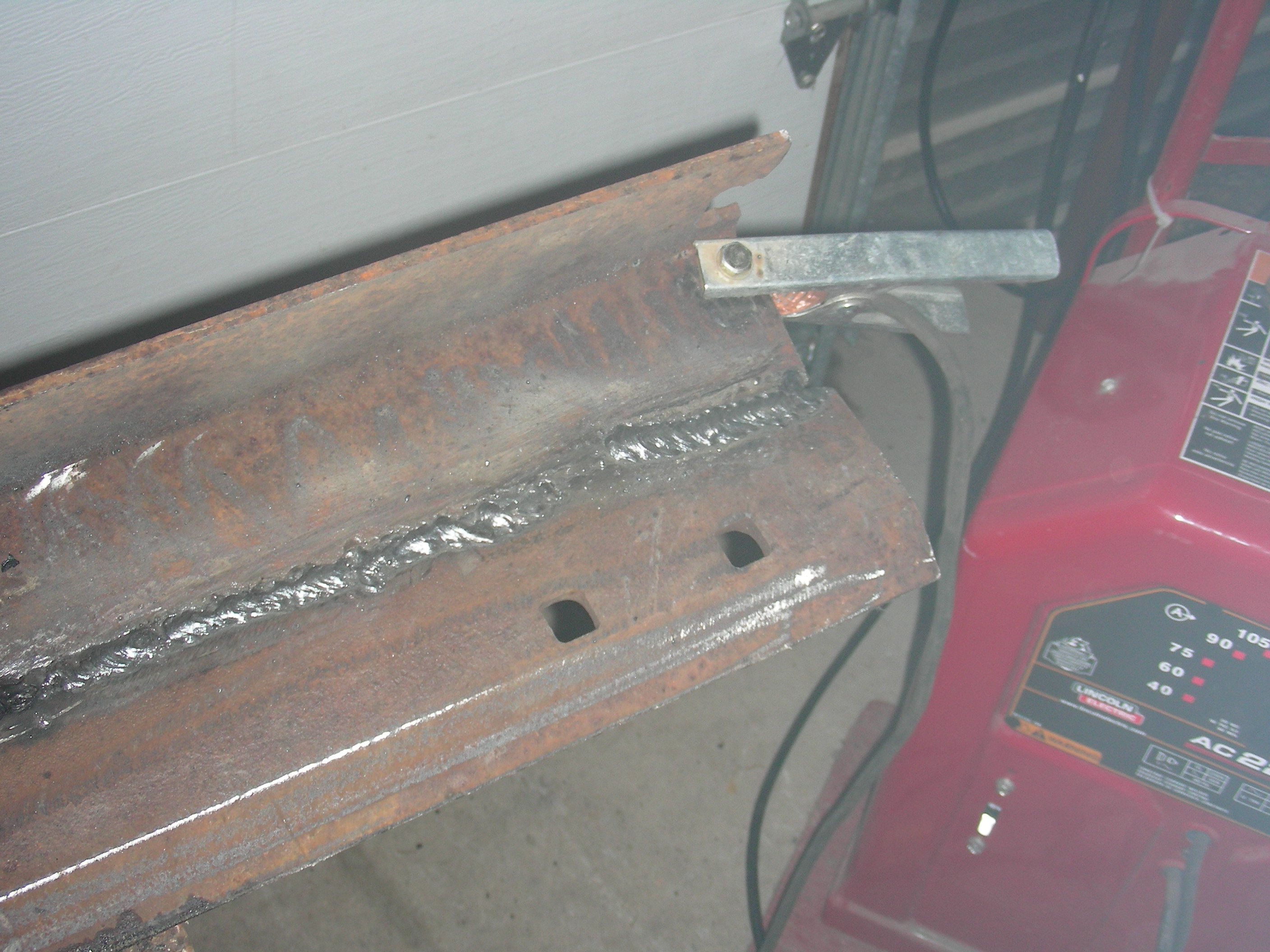

i have welded cutting edges with no problem .with a ac buzz box i would use 1/8 6011.with pictures maybe i could help.
   / Welding a bucket cutting edge to softer metal ?
#14

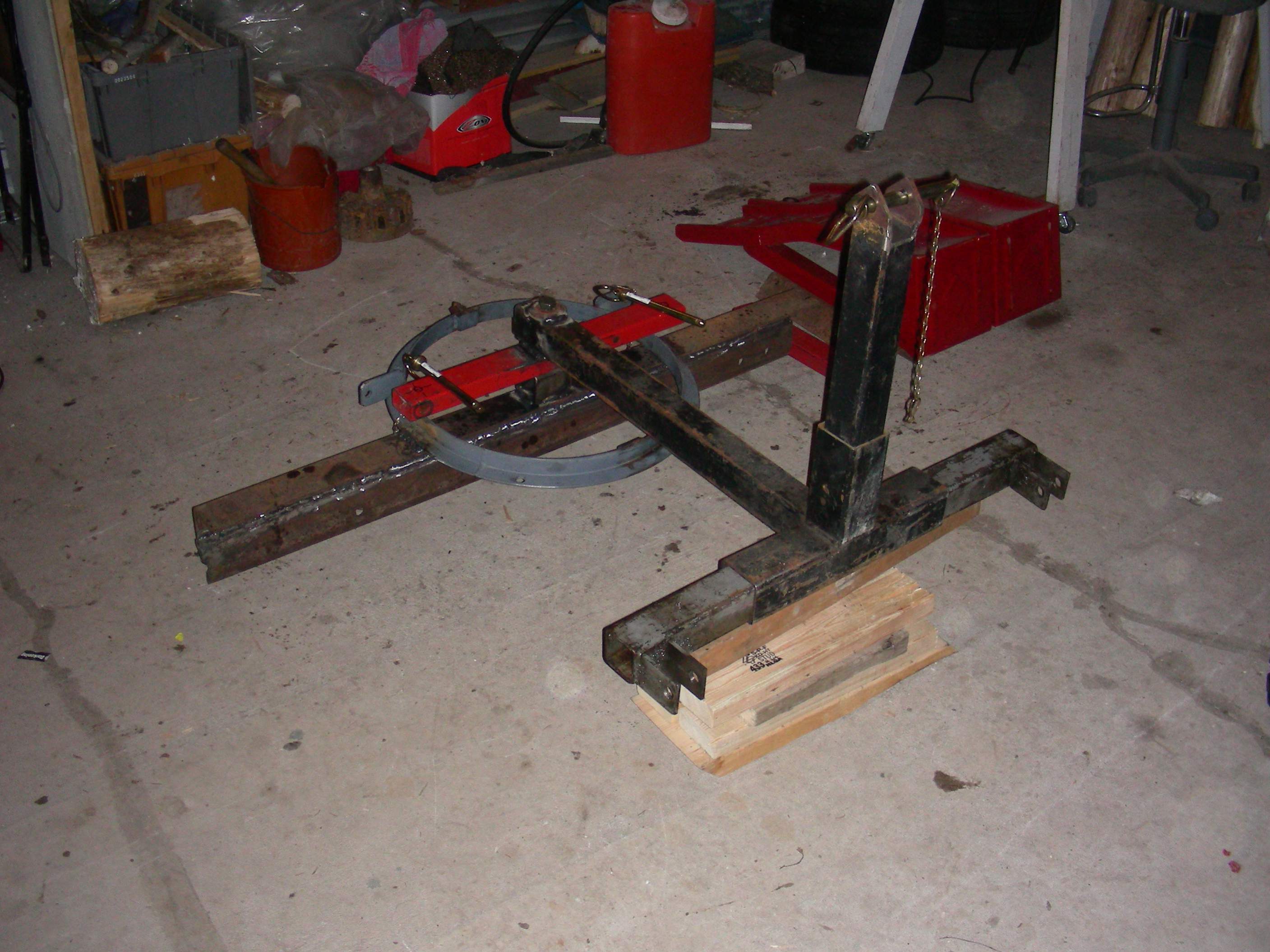

Here is blade pictures , the first two is when I had just used Lincoln AC 7018, gave up on that, and then used 6011 ............last picture was this weekend when I bought some farmers rod 7014 and just laid on a nice wide bead 3inches long , and I did four of those beads on front of blade and back of blade, (over the old welds that I ground flat). When I ground those welds I did not find any cracks . So it is messy , but I got to figure it will hold for my use of spreading gravel in driveway , or topsoil on lawn for low spots
I hope to paint the whole frame tonight. and add one more gusset at 45 degrees for box frame up to upper link area, and maybe a hitch ball.
If you use the 7018 on that machine get the 7018AC you will reduce your frustration level greatly. I walked this road a long time ago. If you need max strength and durability then 7018AC is one of the best. :thumbsup:

after looking at wawajake's welds.i would recommend slowing down the rate of travel and weaving more .the metal you are working with is ideal for 1/8 6011.ac will weld it.

Thanks Cowski and everyone else, I will lay a few more beads tonight with 6011 , grind it then paint the whole thing . (that will hide the mess :laughing:

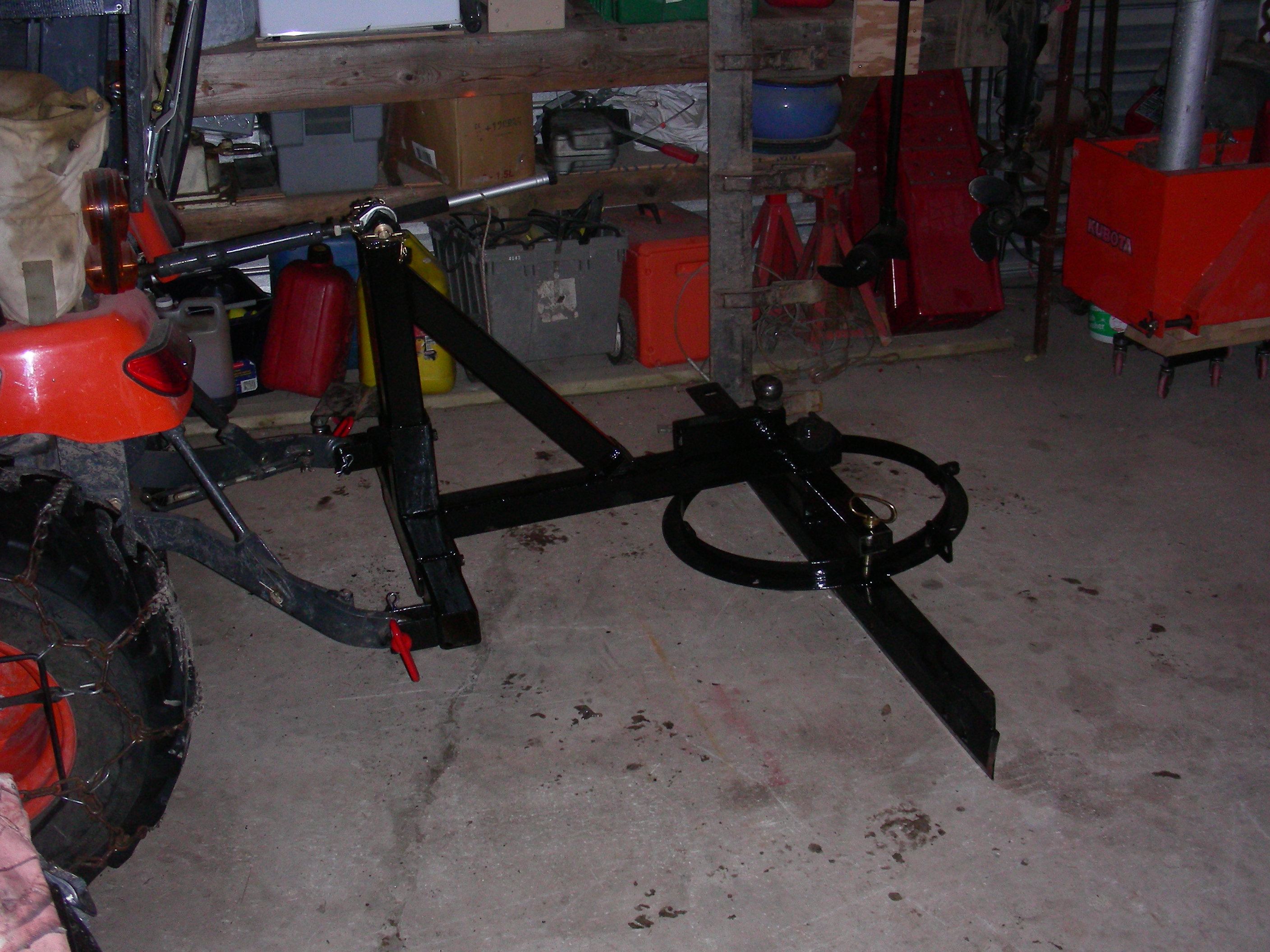

final results
haven't tried yet because we still have snow here and I plan on using it for gravel and topsoil spreading. The old sattelite dish's predrilled circle I used for swivel had holes predrilled to make it sit at 90 degrees and 45 degrees , but I see that the 45 degree might be too aggressive an angle , if it is I will drill some holes in the circle closer to 30 degrees.
With most of my projects being with wood (see even my cab is wood and plexi glass ) this was my first big welding project.
thanks for everyones advice !
