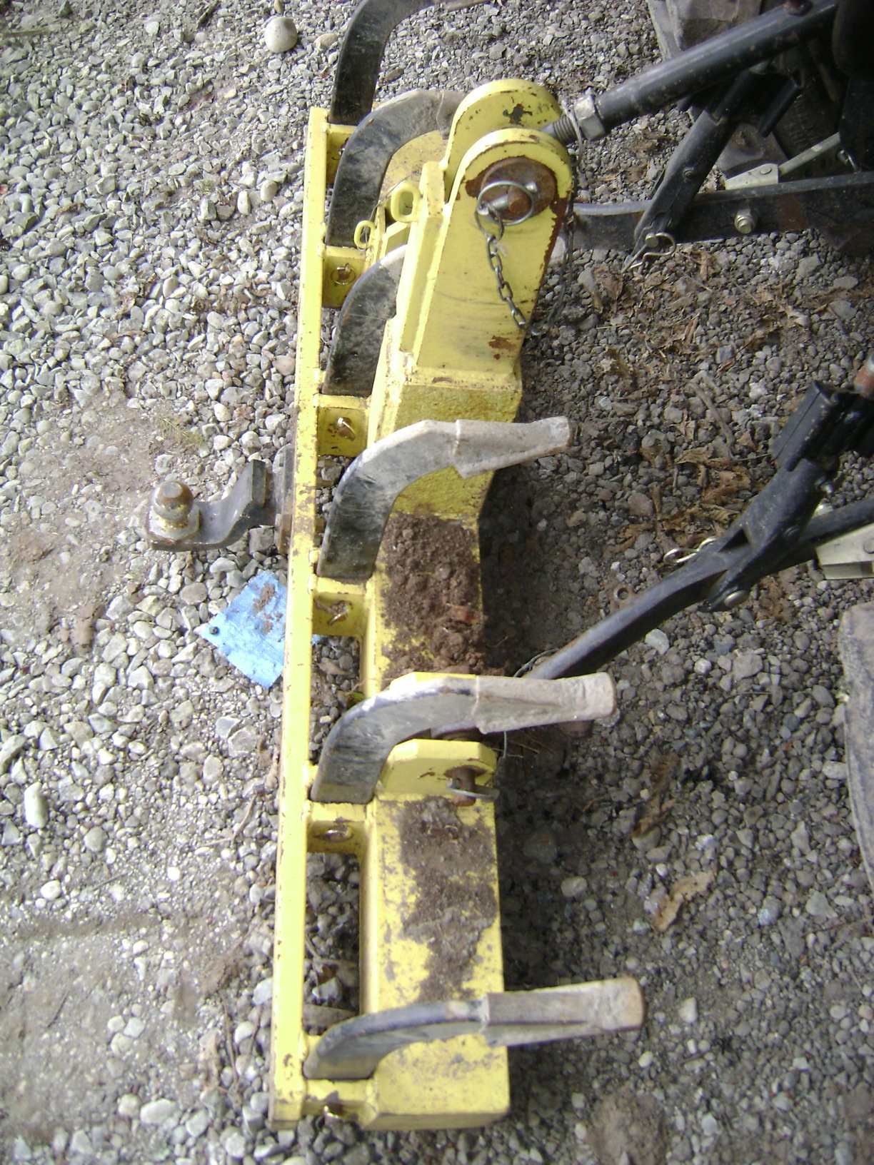

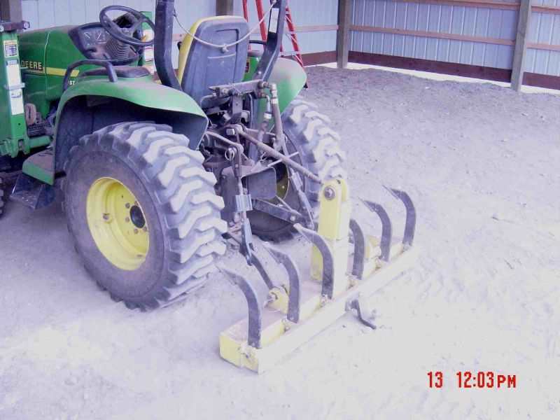

How about building one of these? Of course the teeth are in the non use position. I try to baby my front end loader as much as possible, the 3-point is another story! :laughing:
