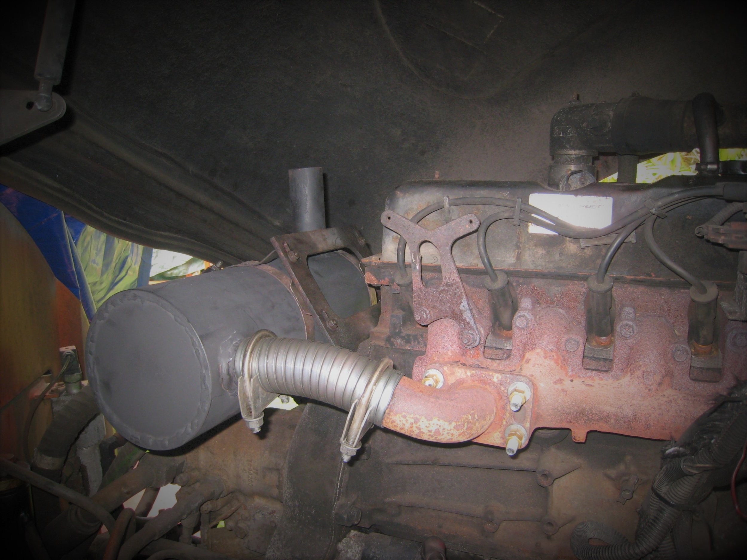

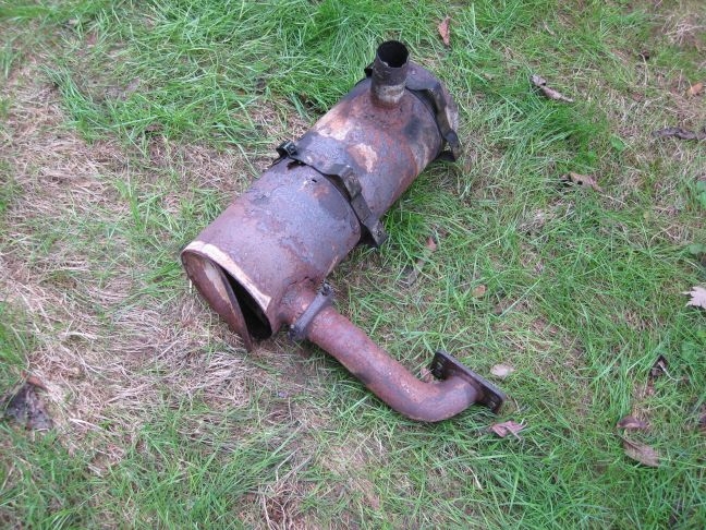

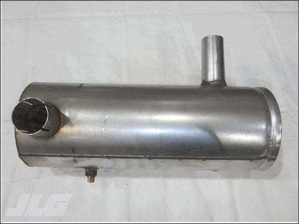

I had to replace a muffler on boom lift and found out OEM replacement would cost $800+ so decided to make my own out of heavy 6" pipe and 1/4" steel for ends and couple of inside bafflers.
It has worked out great.
No aftermarket direct fit was available due to inlet / outlet orientation.
Rusted out original:
$800+ OEM:
Homemade version installed:
