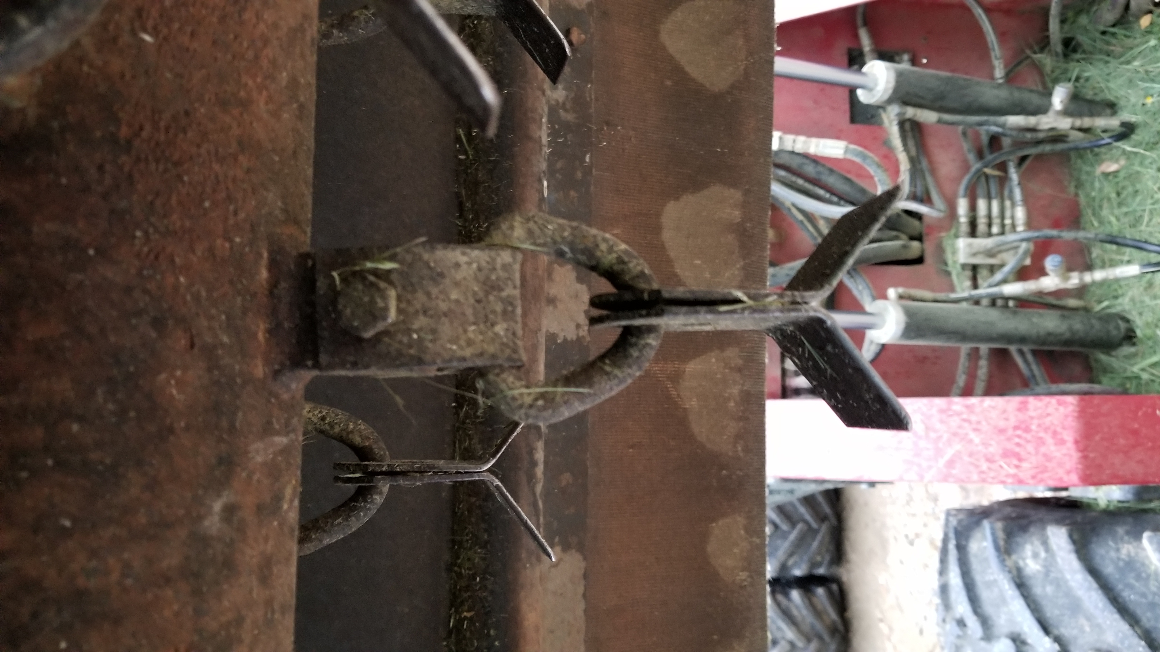

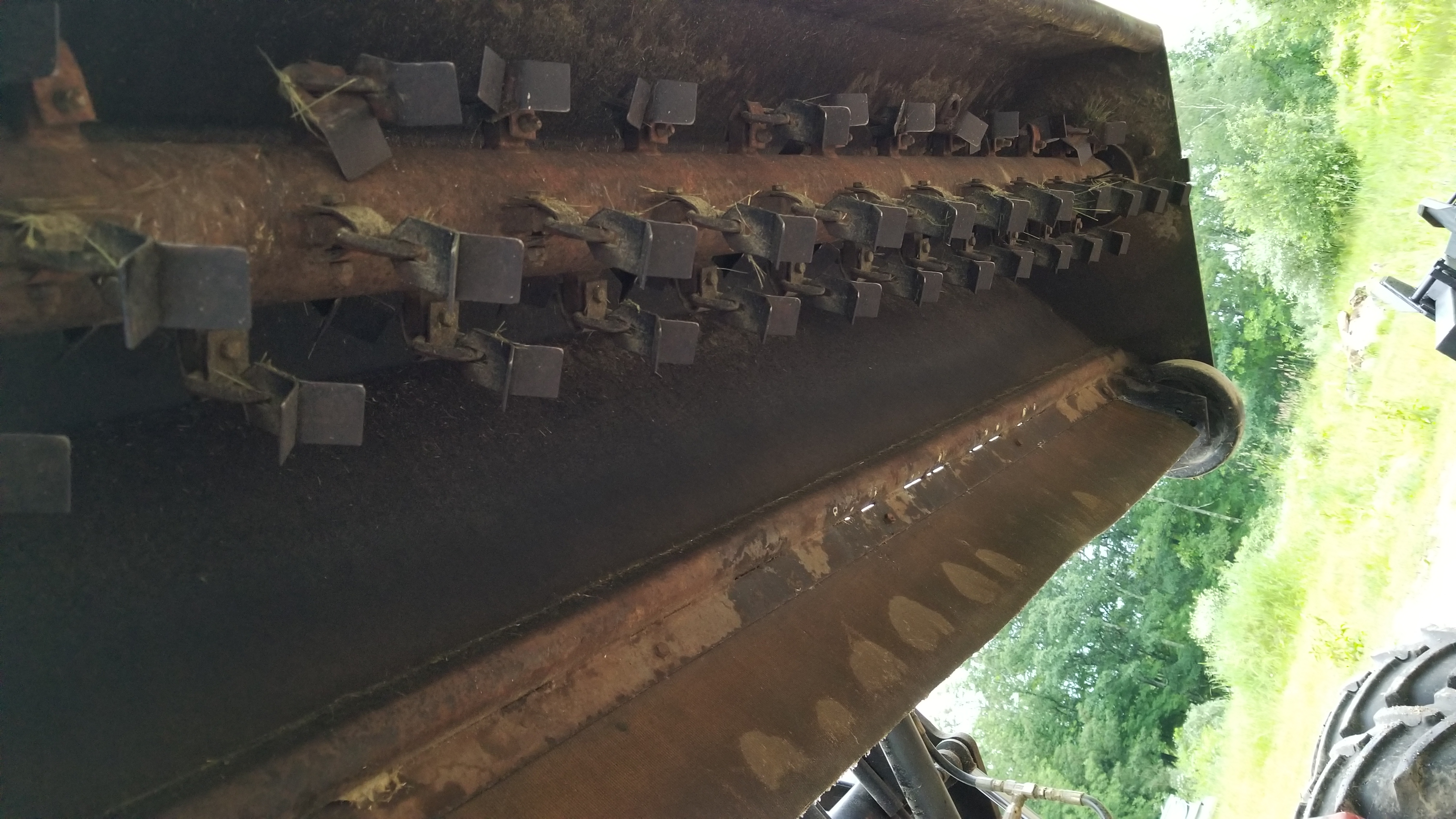

But, I snapped a few pics of the flail mower while I was moving stuff around today:
I am pretty surprised at how flimsy the knives are! I guess the low mass is what saves them when they bounce off of a rock...

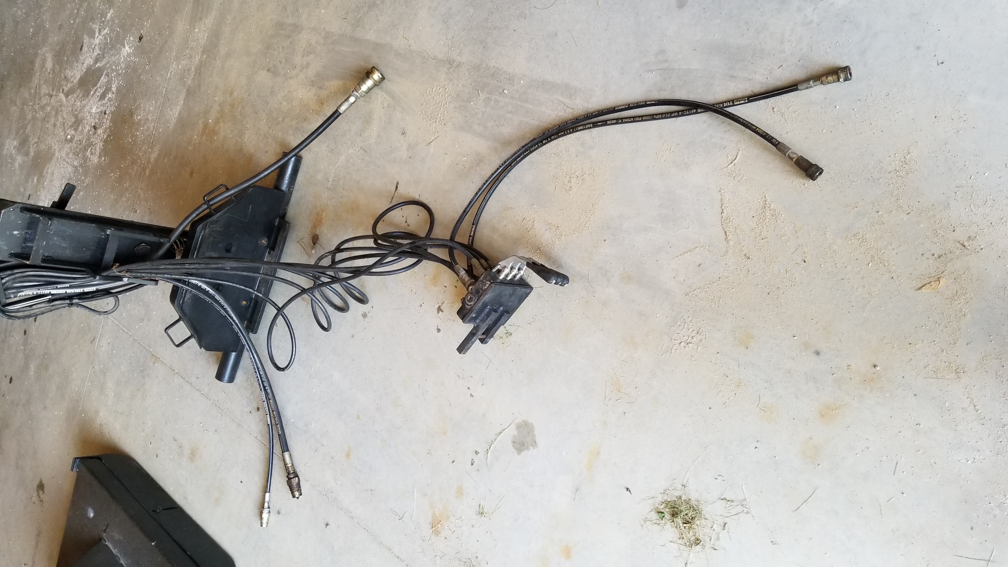

I also pulled out the knuckle boom mower to check all the lines:
Looks like it is all there.
Am I correct in assuming that the two female fittings attach to the lines for the quick-disconnect lock? Is that lever used for all hydraulic implements? Grapple, plow angle, etc?
   / Welcoming Avivii - flail mower #26
The Quick Attach hoses are operated by what's called the AUX PTO on my PT425. It's the lever down by my right knee, and is the 3rd spool in the valve bank that controls the FEL joystick. It normally operates the QA device for hooking and un-hooking any attachments from the FEL arms. It is also used exactly as you guessed, for powering things like the grapple, power-angle on the snow plow, etc...
So, you hook up the implement, use the knee lever to lock it in with the QA, set your parking brake, make sure it's engaged by driving back and forth a couple inches, get off, disconnect the two QA hoses and connect them to the atttachment. A total of about 30 seconds. :thumbsup:
