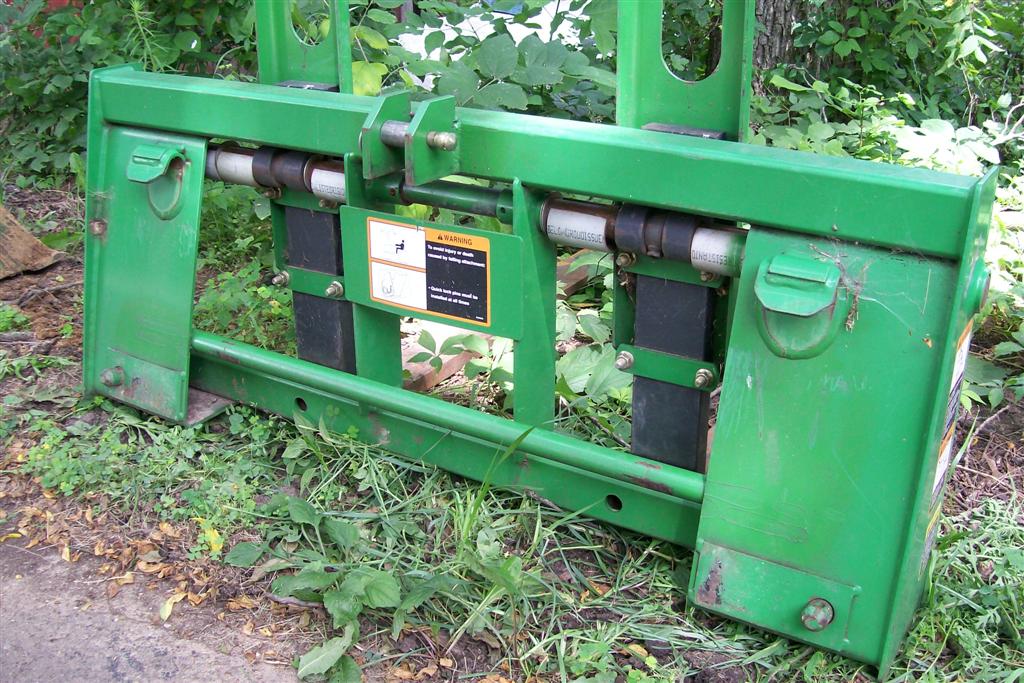

I think my Deere forks weigh about the same as the bucket. The regular attach and not the skid steer QA. I sure wouldn't want to be with my forks. Use them as much or more than the bucket. Adapted these for use on the iMatch as well with some additional fabrication.

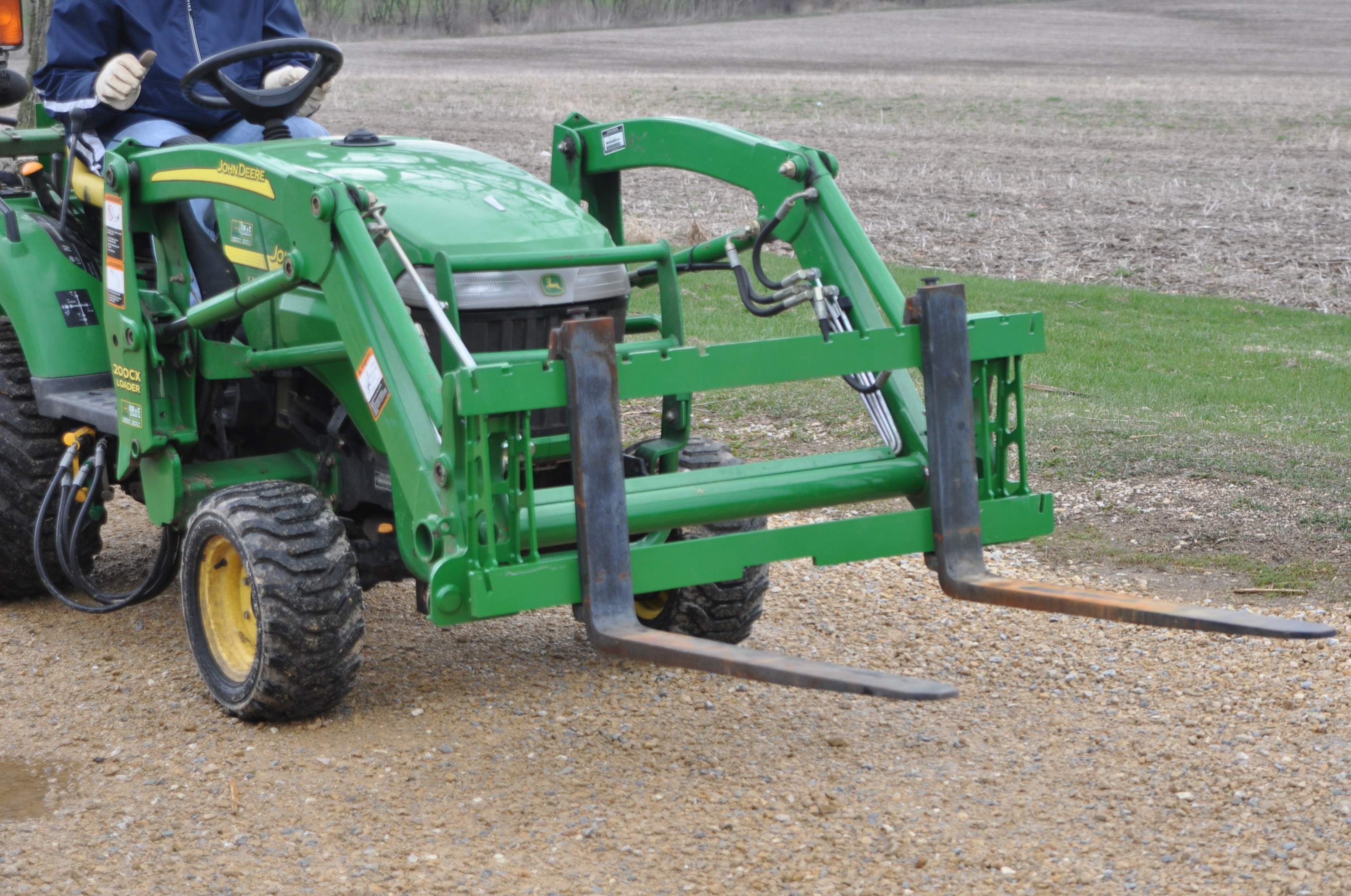

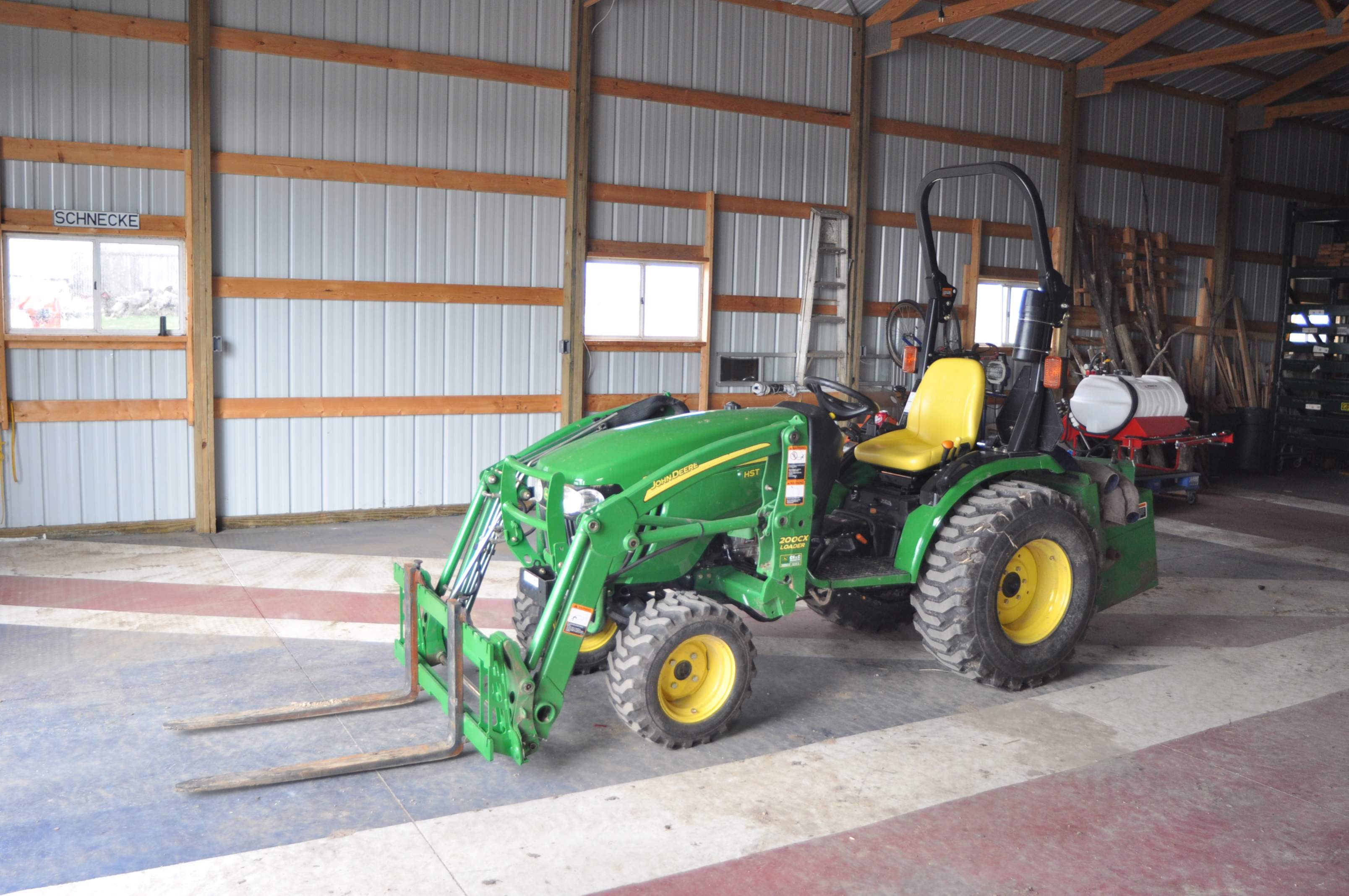

We have the Artillian pallet forks for the 2305 and 2520. Works well on either tractor, takes a little time to get used too. Well worth the money!

Hi,
My only concern with the Artillian forks is that is no "fence" or backstop to help keep a load on the pallet from sliding to the rear onto the tractor. Do they make a fence kit for them?
Tom
   / Weight of pallet forks for the 300cx loader #10
you would want to talk to Chris on that. I have a place i can get some steele and fab my own fence or guard. On vaca in two weeks and that will be one of the first projects. For the most part Chris has done ALL of the foot work on the frame and the forks.... the rest is up to each individual to fab to each persons needs.... his set up is right around 220# and fabbing a guard wouldnt be more than 45# maybe??? For your 3 series it would be nothing to lift.:thumbsup::thumbsup::thumbsup:
