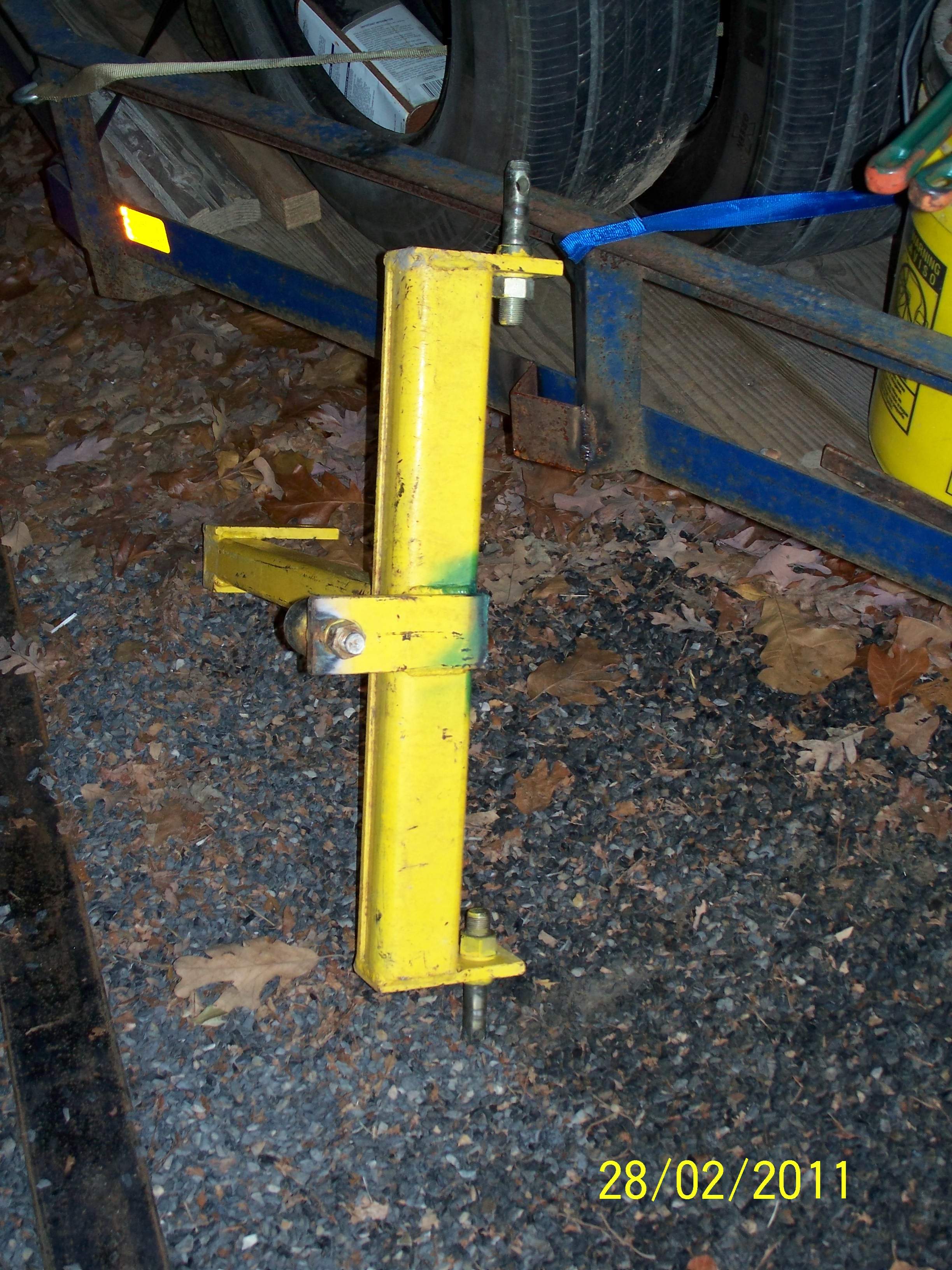

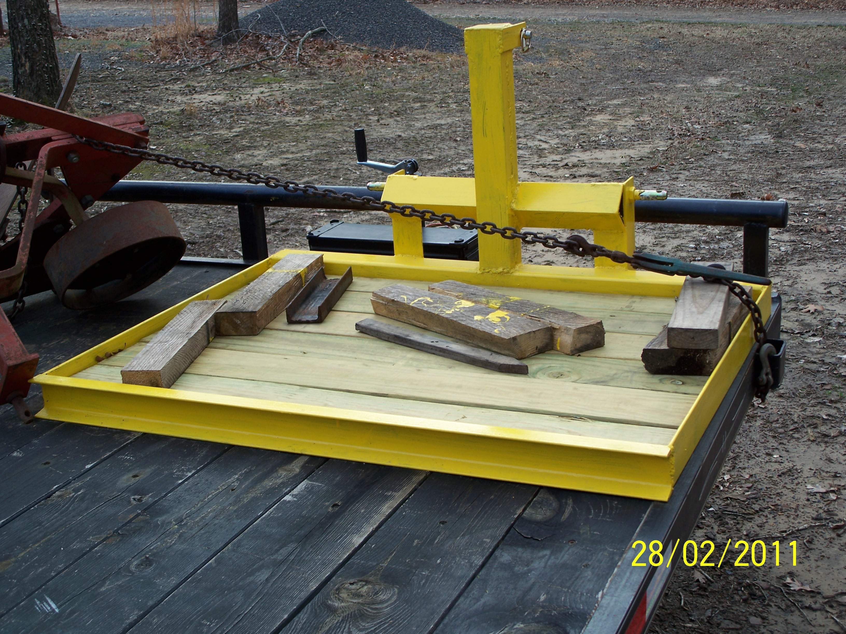

Since my Kubota cannot put down force on my 3 point I wanted weight on my Box Blade. I used some 3x2x3/16 Angle I had on hand and framed for 16x16x4 Concrete Cap Blocks on each side . 2 Blocks are @ 175# if I remember right. Four blocks seemed a bit much tho the Bota did not have a problem. 100_0173-1.jpg
3 Pt Hauler, Box Blade & Trlr Toter could have been made reversible w/ GN Ball on top & also with a socket on bottom to use different Hitch Inserts. :cool:
