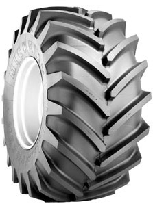

oops, missed picture, try again.
UncleAl

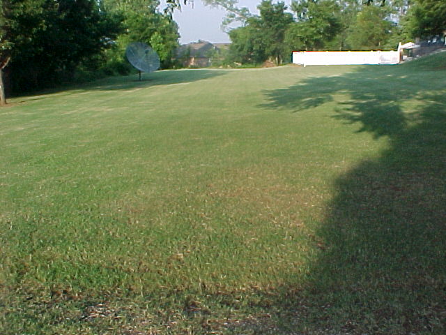

Here's a picture of my lawn...cut an hour ago with R-1s and MMM. Soil is sandy...3/4" of rain Friday night.
OkieG

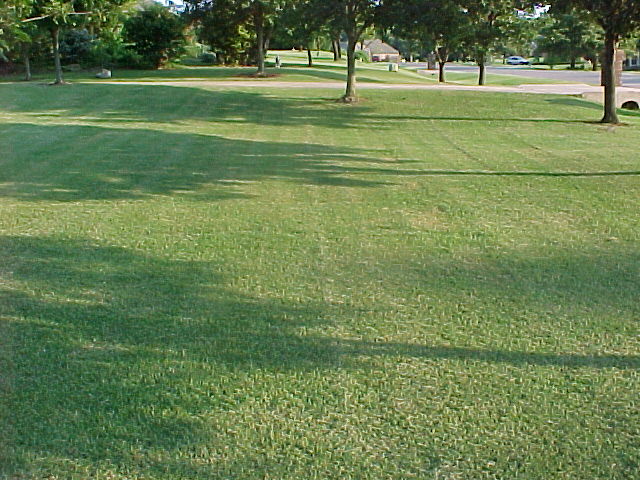

Here's a second shot. See any tire marks?? Minimal, if any.
OkieG

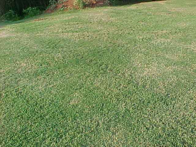

Finally, here's the softest corner of the yard. Do you see the tracks?
The track marks will likely be gone tomorrow, and they will only bother you if you let them.
For me, the benefit of extra traction when doing "real" tractor work outweighs the drawback of track marks after mowing.
Certainly, each tire type excels in one application or another...but, I really like R-1s. /forums/images/graemlins/grin.gif /forums/images/graemlins/grin.gif
