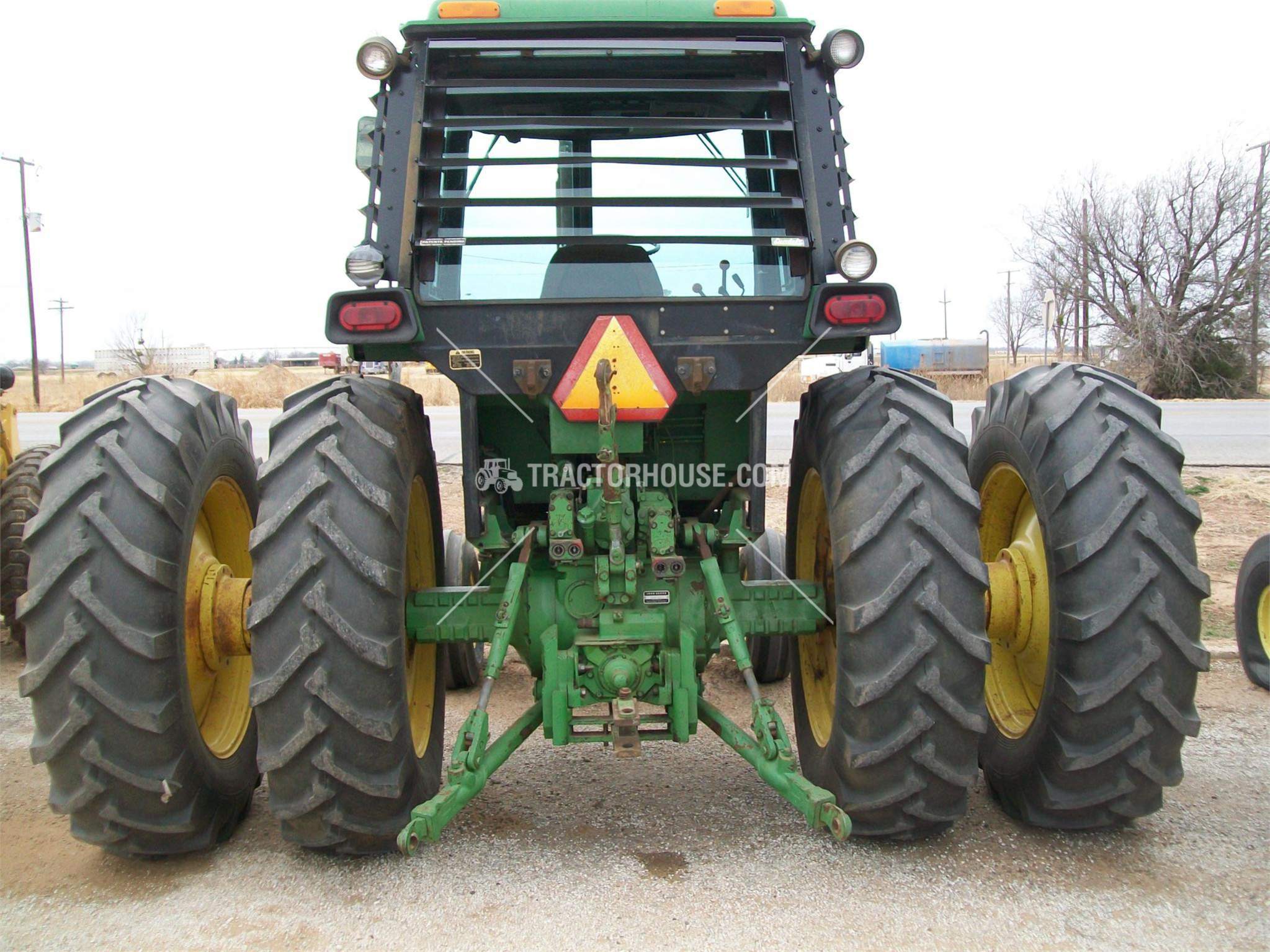

Here is a pic of it

On the trade, the older machine with 7700 hours is getting pretty long in the tooth. Depending on prior care, it could be waiting to fall apart or still run strong for 8000 more hours. The cost of extra weight on a known GOOD machine vs getting an unknown machine with lots of hours needs to be evaluated carefully. personally, I'd keep the "bird in hand".
That was definitely a concern. I know a lot of these tractors of this vintage farmers use daily still and they have 15,000 hours. Proper care is the key. This tractor is coming from a very reputable dealer who has been in business a long time. It was a trade in on a new tractor and the previous owner had it a long time 20 years I think. The dealer thoroughly checked it out and assures me all is good and I feel he will stand by it if not. Not necessarily a warranty but if it craps out the first week I have I am sure he will make it right. Being that I use my skid steer for all my loader work the tractor may only see 50-100 hours a year. A lot of these tractors might see that in a week and are likely doing a lot "harder" work than I plan to do with it. If it is solid when I get it I am sure it will last a long time doing what I plan to do with it.
