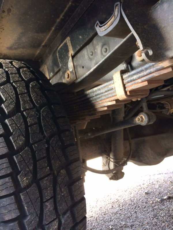

I did not, but my truck is heavily built. I can put 5k on my flatbed and not go over the truck’s GVWR. If I was driving a lighter duty truck, a WDH would be used.
These are my rear springs:

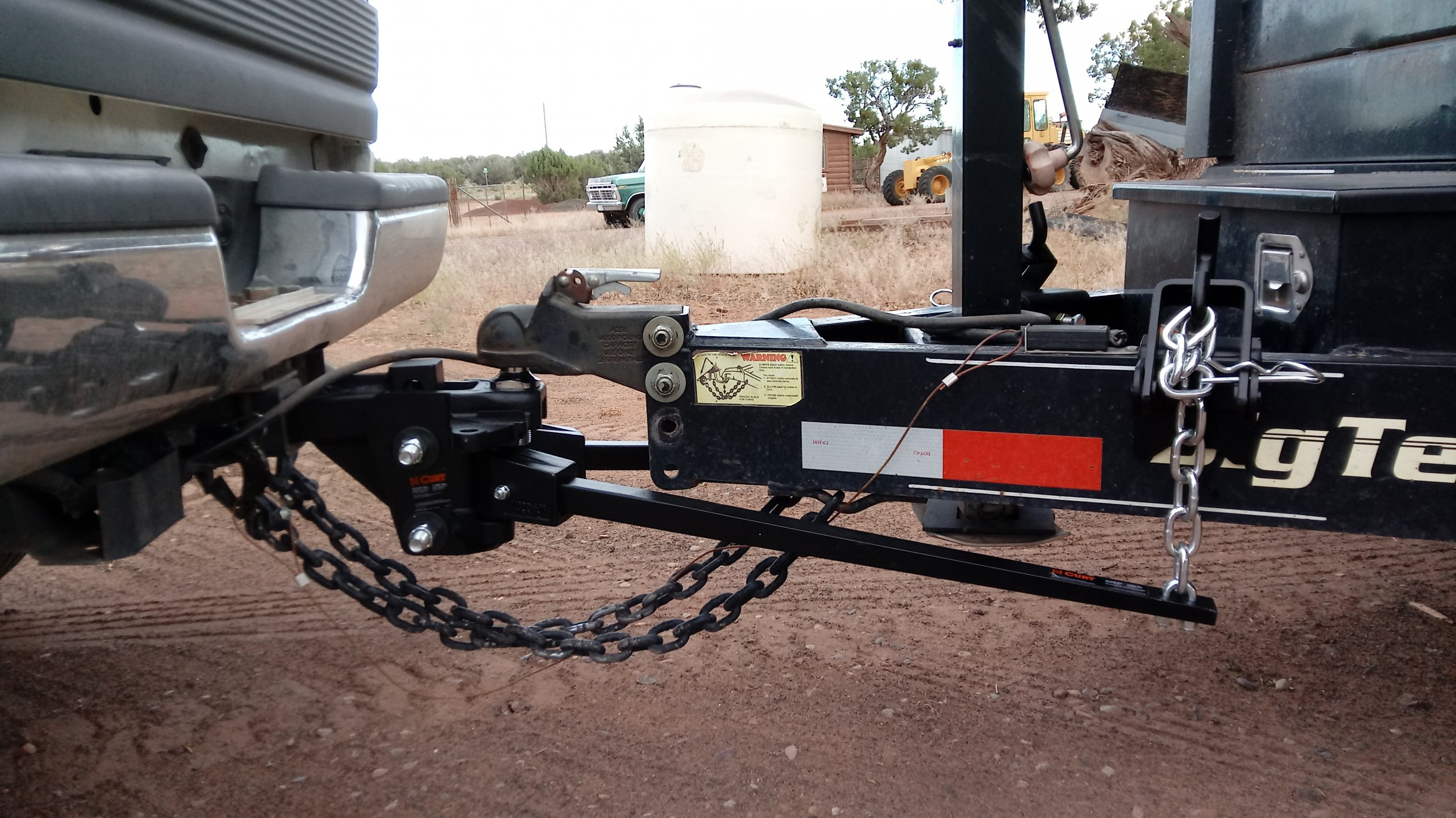

I have a 14K Equal-i-zer hitch for my 14K equipment trailer.
I also have air bags on my 3/4T tow vehicle.
I MUCH prefer the Equal-i-zer (brand) hitch design over the drop chain style, because the Equal-i-zer design is not subject to turning while backing issues.
Certainly not cheap though.
That 14K Equal-i-zer is now $697.95 on e-trailer.com.

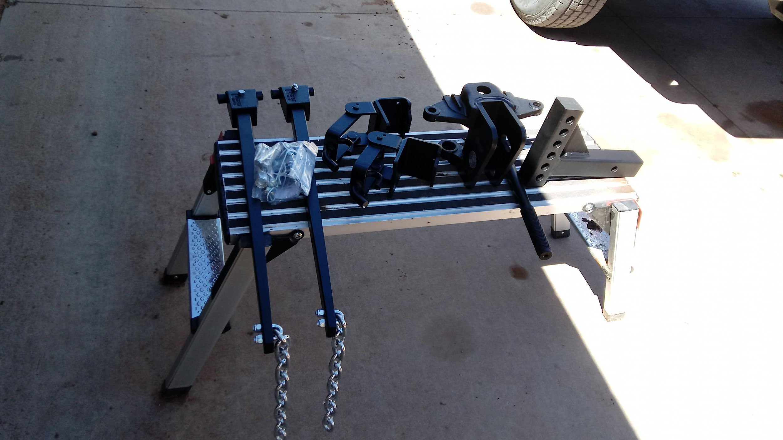

Big fan of my WDH and tandem axle trailer brakes on my 7Klbs trailer. Got lucky that I could buy an extra set of trailer frame brackets for the weight distributing hitch that I bought with our camper setup right by the dealer. All my trailers are 2 5/16" balls now, everything interchanges. The only downside is the angle / tongue weight empty on the camper is heavier so the setup is a tad "tail heavy" when i run the 7K equipment trailer empty (using the rear wheels too much which can wear em more). But I don't run it much empty and once she's loaded, it's nice and level. Drives well at speed and brakes straight.
