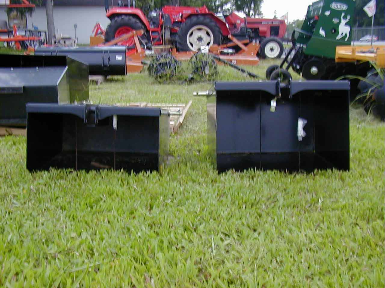

I found these 3pt. hitch weight boxes out at my dealer's yesterday and thought some of you may want to see them. There are four views. John
/ Weight boxes from Woods
#2

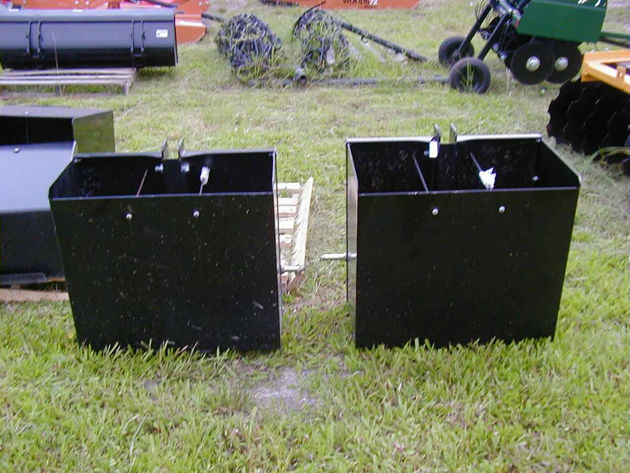

there are two sizes, 6.0 cubic feet and 4.5 cubic feet.
Retail if $223.00 and $213.00 respectively. John

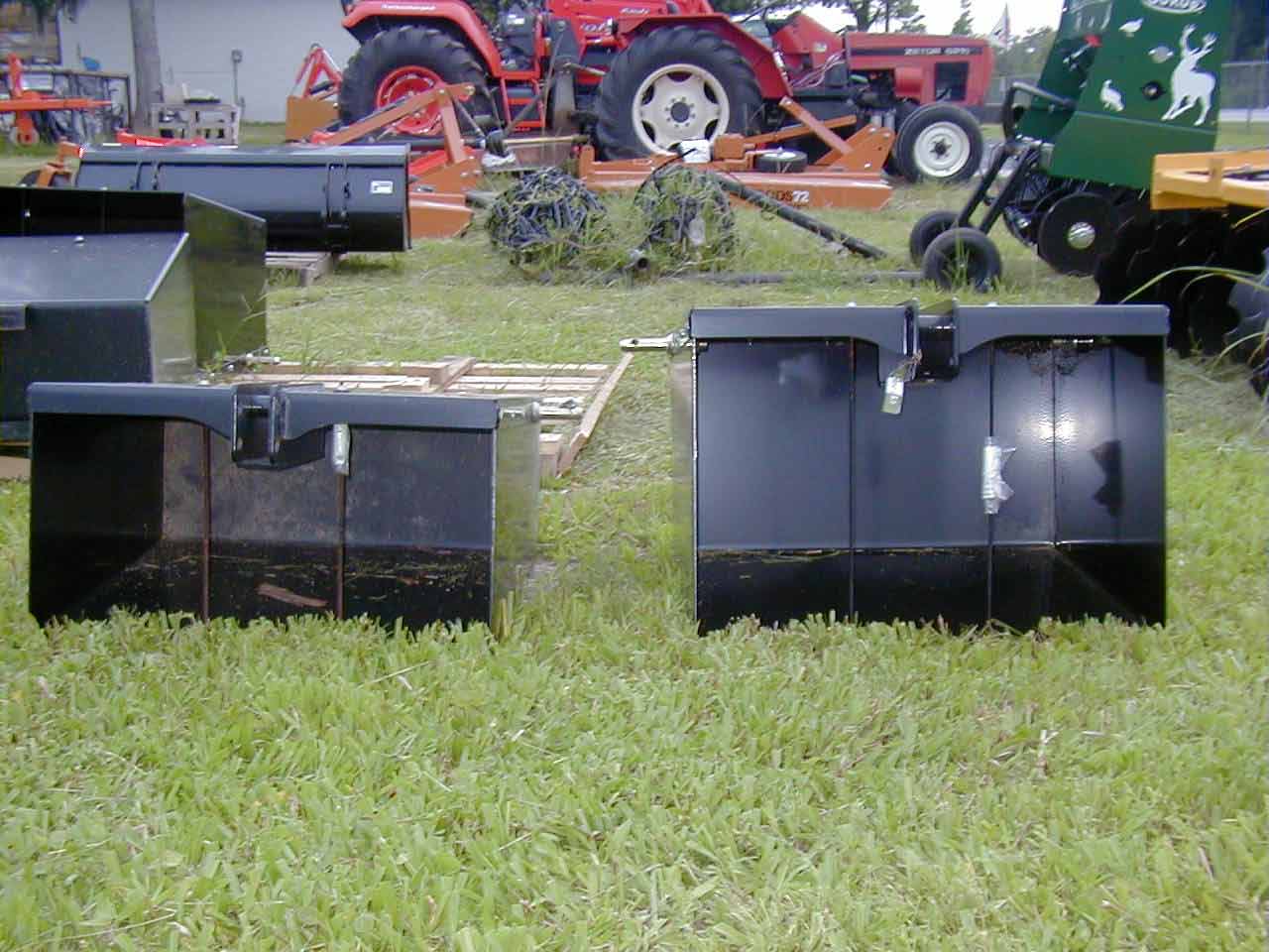

another view

I think maybe the pics have an optical illusion as there is no top. One of the views shows a shot into the boxes which are open on top when attached.
These are good for adding sand, dirt, gravel, etc. to gain the needed weight, and have a hole at each front corner to drain water. Sorry if the pics didn't show the opening clearly. John
