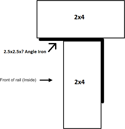

The long, 15ft 6in back section has some give to it. I used 5/8's threaded rod there, as it's the biggest size that I coudl fit in the tubing. It's very tight, but with the distance being so long, it will move on you if you lean against it. It's there, but not very bad and I don't think most people wil even notice it.
For the back rail, did you use 2x4s?
If so, you could put a piece of 2x2 (or 2.5x2.5) angle between the upper and lower boards that make up the top rail. That should make it much stronger and should be almost invisible from the inside.
Here is my drawing of how it might look from the end:
A piece of 2.5" flat stock between the upper and lower boards might work as well if you want the back to look nice as well, but a piece of angle iron might be stronger.

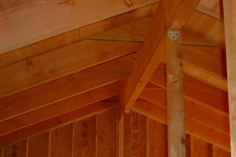

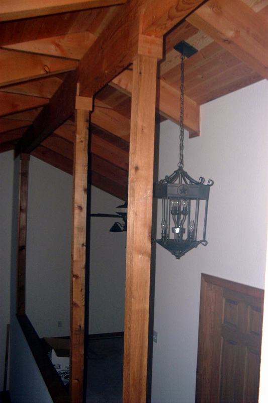

Eddie, I'm really not critical about metal brackets showing on my deck, especially on post caps and joist hangers. Inside my house, I didn't want the post cap brackets to show, so I had the finish carpenter construct "saddles" for the caps to make it look like the beam was sitting inside wood as shown in my attached photos. I'm only concerned with the corner brackets because they are more at eye level and they also have pan head screws. I'm sure you removed any burrs that could snag and stain might hide them sufficiently to be an non-issue. Ultimately, if the client likes it, it's perfect.
