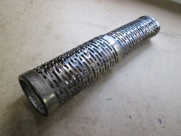

It's coming to the end of proper smoked cheese weather in my location but I managed to get in one last smoke a couple of days ago. The 5:00 am temperature was thirty-four degrees, perfect for a two and a half hour cold smoke.
The key trick is to keep the interior kettle temperature under ninety degrees or your running the risk of melted cheese. The only heat generated comes from the "A-MAZE-N" smoke tube itself. I've heard of folks using trays of ice cubes or frozen water bottles to keep the temperature down but that seems a bit risky to me.
My favorite self-mixed blend is 75% apple and 25% cherry pellets which leaves a pleasant smokey flavor without overpowering the cheese's natural flavors. We've pretty much narrowed our favorites down to sharp cheddar and pepper jack varieties.

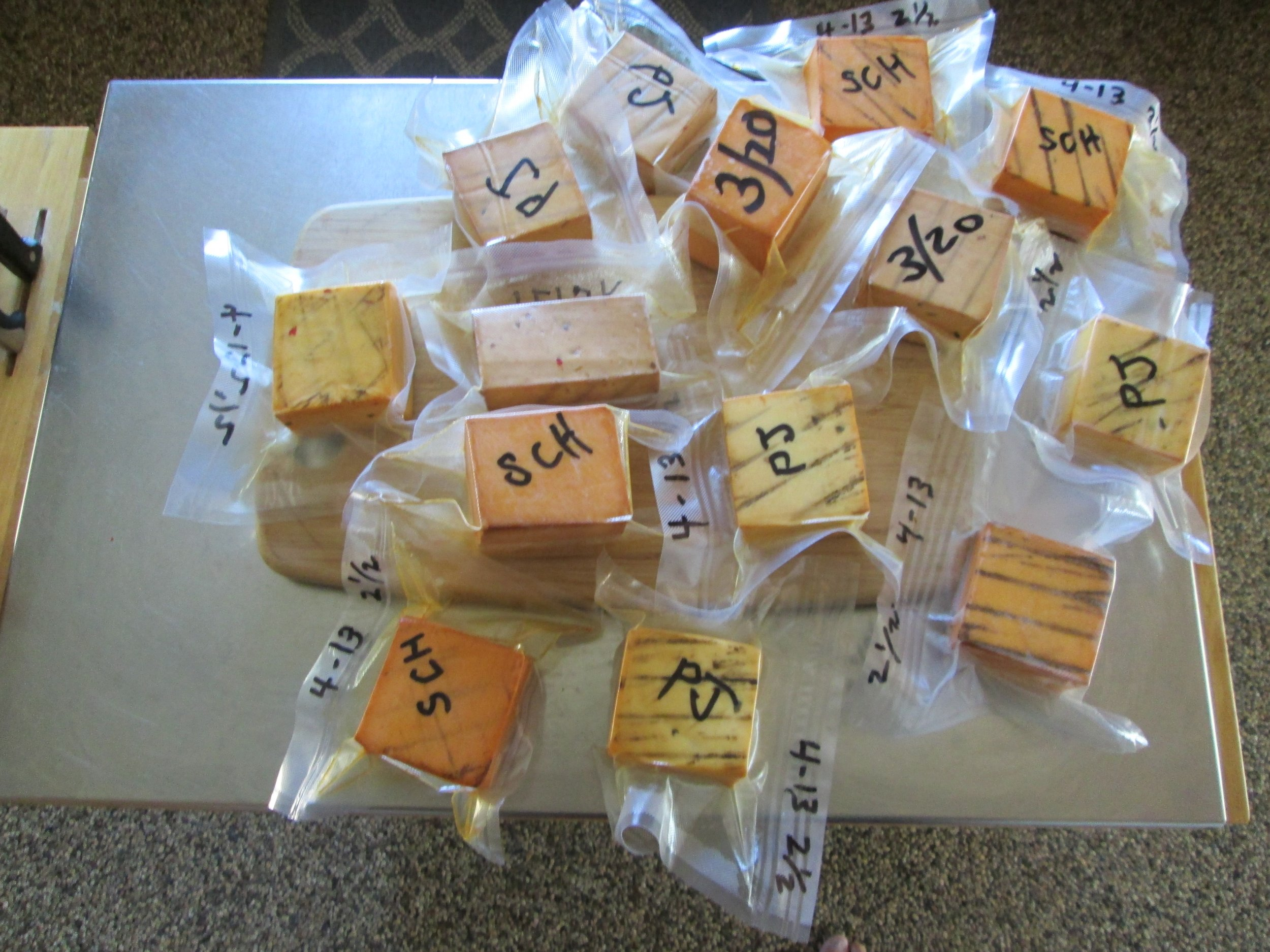

The last step in the process is to individually vacuum seal and label the 2"x3" blocks and refrigerate for at least two weeks which allows the smoke to further penetrate into the blocks. You can use ziplock bags but be sure to get as much air as possible out of the bag to avoid any long term molding.
Looks like I have enough of a "stash" to make it to the fall and the start of another smoked cheese season.

I'm still pretty new (two years in, ten smokes) to cold smoking cheese so here are a couple of my "grasshopper" found observations:
I've smoked some of the supermarket offered Gruyere and Gouda brands and yes, they are delicious but also pricey (at least do it once for the taste experience) so I limit that smoke to family gatherings, holidays, special occasions when in smoke season etc.
Twice have smoked swiss and each time was disappointed in the flavor-don't know why, anyone else experience that?
I now stick to high end sharp cheddars and pepper jacks-our favorite basic choices, happy days!
Absolute low outside ambient temperature is the key to cold smoking and keeping the internal BBQ
temperature under 90 degrees for the duration.
If you vacuum or zip lock seal after the smoke, let the cheese rest and air dry especially if vac packed so the new fresh exterior smoked skin doesn't drain/suck/leach out of the block.
Enjoy!
