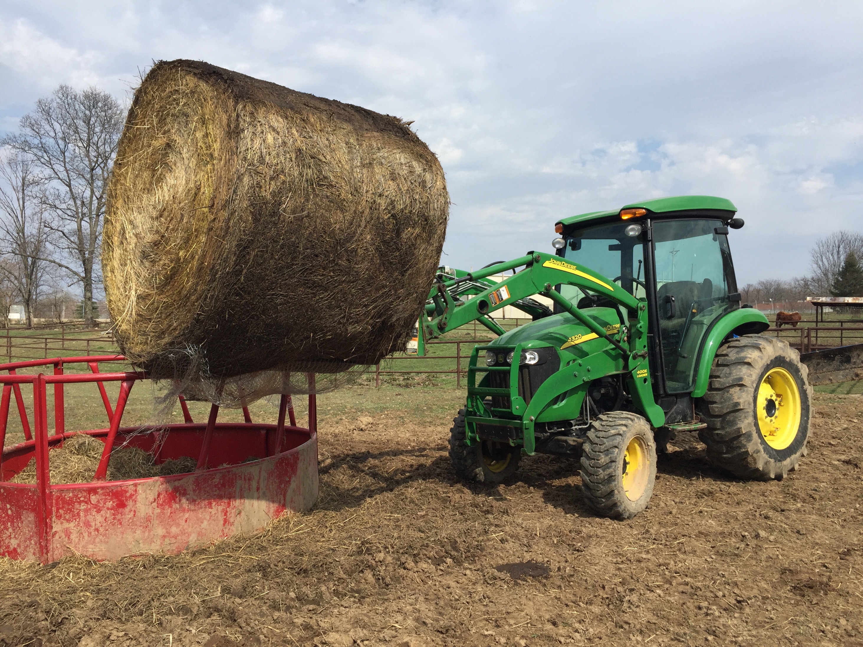

Mine does something similar to what the OP describes, I have a load on my pallet forks on my FEL and it can lift it but can only curl it about 1/2-3/4, if I lift higher it will relieve enough pressure to curl it the rest of the way.
I don't think I have a problem though, like others have said the weight I'm curling is a long ways (up to 4ft) from the pins.
The bales are over 1000lbs, prob closer to 1200lbs, that one in the pic is a tightly packed 4x6 round bale.
