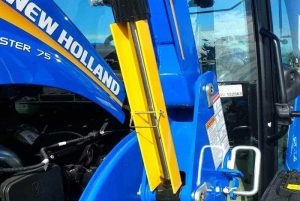

My New Holland 50 doesn't have them but I bought a pair from Tractor Mike. Since I don't have the fabricating tools or skills, I thought $100 was worth it for safety.
Those would be handy. When I service the engine, I always chain the loader cross bar to the truss in my barn. That device would sure be easier.
   / We All Live In An Orange Submarine #66
Wouldn't two equal length pieces of C channel zip tied in place work well enough?
I suppose in a way it might. However, my nearest steel supply is 35 miles one way and C-channel and zip ties just don't raise the confidence level in me that high. The difference in price is negligible, the difference in feeling safe would be a bit larger.
Milestone . . . he's admitting that he is going to have to open it up.
Mike/Florida
The lynch pin in the picture is what makes that C channel loader support functional. Now having said that, the ones that came stock on our tractors (Kubta and JD) are very HEAVY WALL C Channel & with two lynch pins. It does feel secure.
On the neighbors sink and swim Kubota..... The nice thing about opening up an engine that is still working - even one that is just somewhat working - is that a mechanic can often do a lot of good without having to completely rebuild everything back to the stock clearances.
   / We All Live In An Orange Submarine #69
Ah, unfortunately I always think that most everybody has steel and various material laying around. I get my steel from 150 miles away, and usually between 1,000 to 4,000 lbs. at a time (in 20' sticks).
But I would trust C-channel just laying on top of the rods. Once the loader's weight is on them they can't really fall off no matter what.
