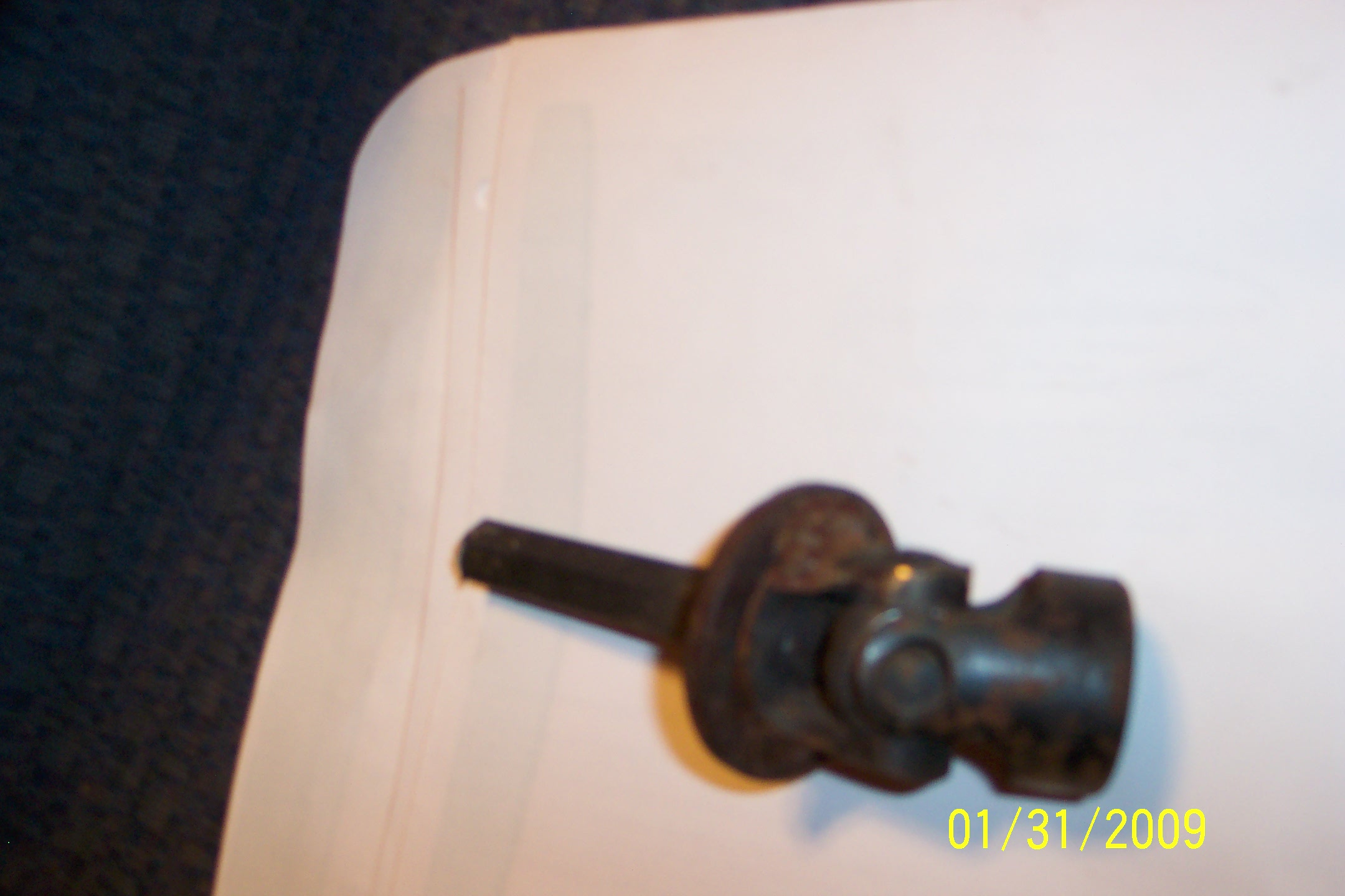

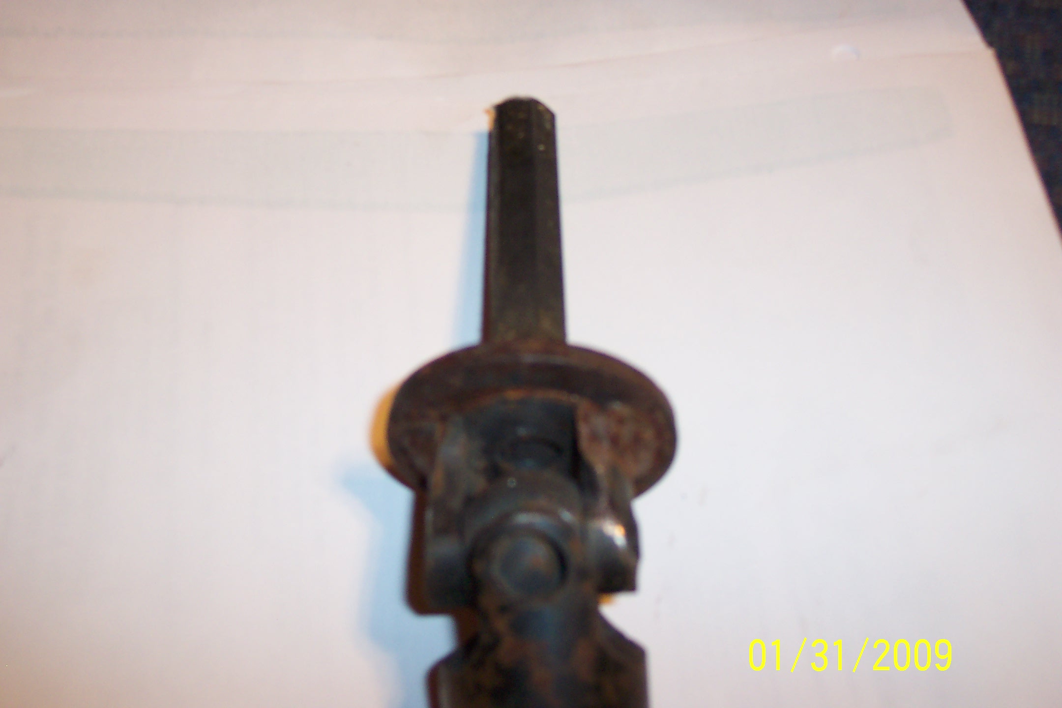

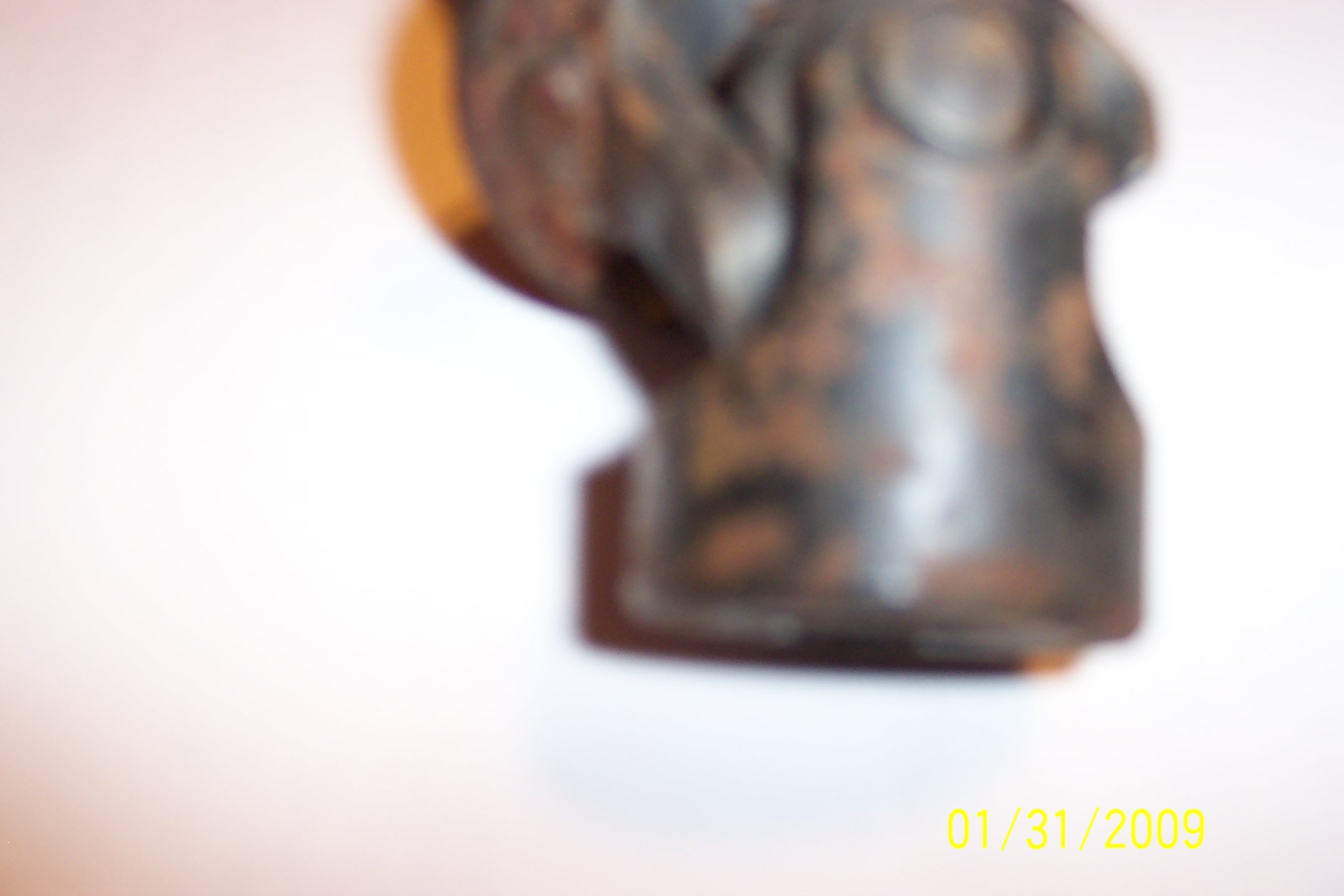

Rob, I blew up the feeder driveshaft in my WC-06 today, and was looking at the pictures of yours in this post. The picture looks to me like yours has actual small U-joints in it with bearing's etc. Mine has just pins and is made like a standard 1/2" wobble joint. The pins are worn about slap out and the assembly came apart.
Anyway, could you look at yours and tell me if they are actually a cross bearing or are they just pins?
Also, just a question, and keep meaning to ask everyone this, when you see mention of this everyone talks of greasing the bearings, yet really, when you grease those points on those pillow block bearings, are you not just greasing the outer shell of the bearing in reference to the pillow block itself? I don't believe any of that grease actually reaches the rotational parts of the bearing itself or am I missing something there?
Thanks, any suggestions you could offer on that drive line would be appreciated.

I believe when you grease those pillow blocks you are indeed greasing the ball bearings. The shaft itself is not greased, but the shaft rides inside the inner race of the pillow block bearing. The inner race is supposed to rotate with the shaft. If you look closely on that second photo showing the pillow block of the main drive shaft, you can actually see a set screw that holds the shaft to the pillow block inner race. So greasing the ball bearings is important because that's where the rotational movement is.
Regarding the feeder drive shaft, I'll have to look closely at it. But as I recall, that joint is an actual "U" joint with (presumably) cup roller bearings on the end of the pins. The reason I say is 2 fold. First, I remember seeing small retaining rings that hold the cups in place and second is the pin itself is a smaller diameter than the cups are. So the pins have to have "caps" on them, but like I said, I'm only guessing that there are needle bearings in those cups like regular "U" joints. I have not had them apart yet.
Hope that helps...

Do you have a Point of Contact to get replacement parts for your's? I was going to call Tommy and Ronald to see what they had available, but it makes a world more sense to have a regular U joint style cross in there then what mine had. If you have a direct source for the WC models could you post or PM me please.
When I looked at mine, (and I had problems with the shaft "walking" forward) so I played with it a bit. I think that is a sealed bearing inside the pillow block, and what you are greasing when you grease that nipple is actually the pillow block to the outside, of the outside race of the bearing. If you look at the picture of the driveshaft, you can see it coming out there, I bet if you pick the seal it will still be the sealed chinese grease in there. Unless there is an access hole through the outer race of the bearing to allow the grease in, but I would think that would be tough to do well. I kept meaning to ask that and saw your picture and it reminded me to ask.
After I looked at mine, I thought it was just lubricating the nutational movement of the bearing, so a shot is probably a lifetime supply on there.
Alan,
Do a search for this subject on TBN. This seems to be a common complaint and a few guys have upgraded or modded to a different solution.
