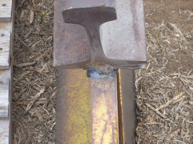

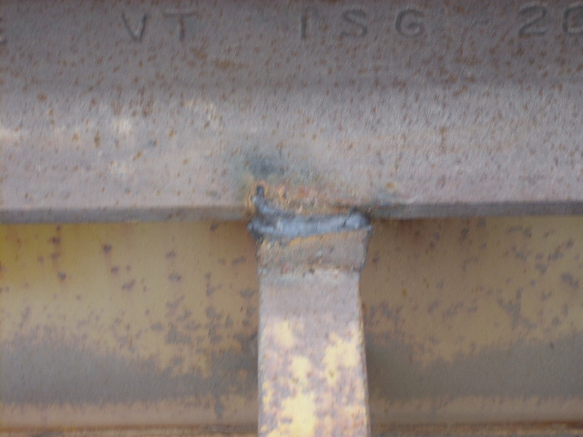

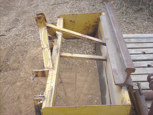

I ended up having it welded on to the back.
I aint used it yet but should here in a few weeks.
It may end up being aft heavy and need some weight in the front to balance it out but then again maybe not.
Down pressure would be nice.:)
The only problem is it is a little harder to move around by hand but I shouldn't be doing that anyways!
Thanks for all the input everybody.

My BB is 830lbs, I can't move it by hand and most of the weight is on the back.
