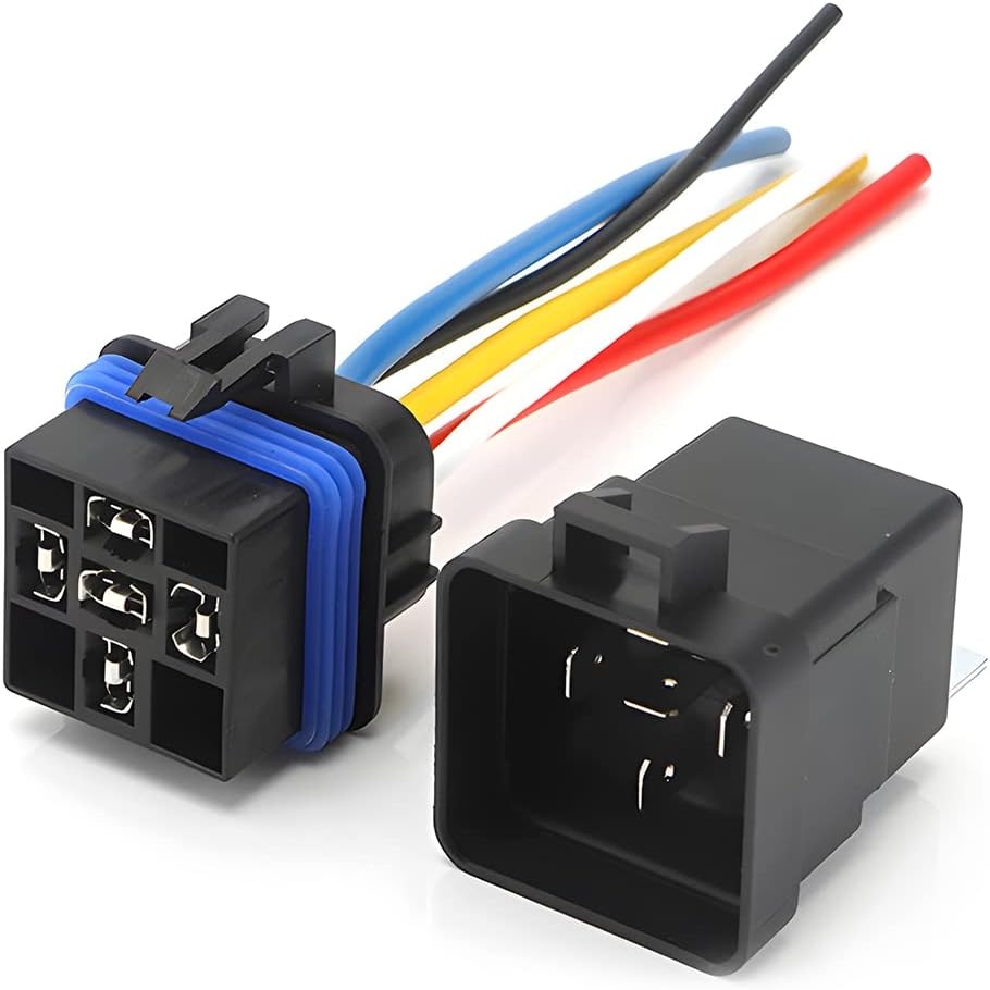

You can replace that relay with a standard 12 volt automotive relay, but you also need to replace the socket with one for the standard auto relay. Get a std relay with a harness. This is less than $10 on Amazon.
You need to remove the wire pigtails from the new relay socket. Then remove the wires from you tractor's relay socket and you then insert the tractor's wires into the new socket. You need to get the tractor's wires in the correct space on the new socket. If I recall correctly, the original relay had a wiring diagram on it, as do most auto relays so identifying where the each wire goes should be straight forward.
Use a very small flat blade screwdriver to remove the wire's from the connectors.
This is what I did on my 1520 when that relay failed several years ago.

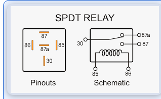

As toot77 said. Get a Bosch relay off Amazon, match the pinouts and you're good to go, $174 for a simple relay is ridiculous.
I f you don't want to modify the wiring harness, add some male spade ends to the new plug and plug it in to where the relay went.
Here's the pinout diagram so the coil connections would go to 85 and 86 on the new one, common would go to 30 and NO would go to 87
/ Way to bypass a relay?
this looks like exactly what I will be doing, thank you

The relay (SBA385230220) referenced in the OP's question does not carry starting motor current. SBA385230220 is commonly referred to as a safety start or neutral start relay. The NO contacts of this relay is in series with the ignition switch which energizes the starter solenoid. The coil of SBA385230220 is energized by limit switches which must all be closed in order for the starter to operate, i.e. clutch pedal & pto's, etc..
A standard Bosch type automotive relay is adequate for this application and has been in place and working as a replacement on my 1520 for about 5 years now. Due to the different terminal configuration I also changed the relay's socket. The SBA385230220 terminals are labeled so I just moved the two wires that were connected to the terminals labeled 'COIL' to my replacement relay terminals 85 & 86, and moved the wire on 'COM' to 30, and 'NO' to 87. I did not cut, splice, or change the oe spade connectors on any of the wires.
