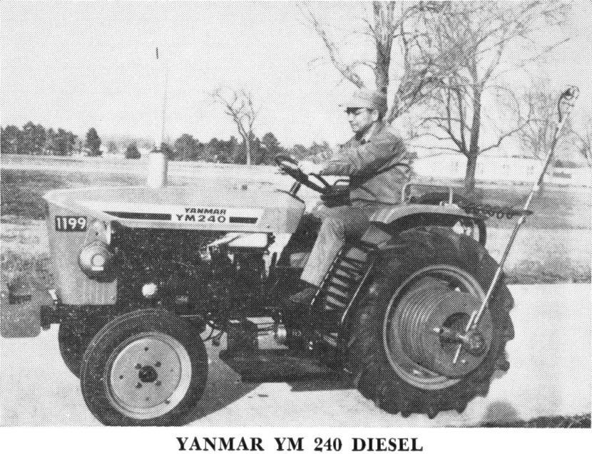

YM240 (US version of the Japan-market YM2000) is one of the best-documented (in English) Yanmars. U-Nebraska tests tractors under standardized conditions. The YM240 Nebraska Test (Linked from TractorData, TractorData.com Yanmar YM240 tractor tests information) has a photo showing the comical amount of extra weight Yanmar put on the tractor they offered for the test. Not just wheel weights but every option you can imagine - running boards for one example. Even after ballasting up to match the bare weight of a US tractor, the pulling performance was nothing special. If Yanmar thought all these extra wheel discs @ 25kg each were ok, then this should be harmless on Etpm's YM2310, a tractor of similar size.

Comical indeed! That picture is hilarious. My Yanmar YM2310, that I bought to replace my 9N, does not have the traction of the 9N. Which affects pulling power. It is so much better though in so many other ways that it is hands down the better tractor for me. It goes faster, it goes slower, way slower, it has a front end loader, the 3 point hitch hydraulics work better, and the PTO can be be in neutral while the 3PH is raised or lowered. That 3PH, working the way it does, is for me a huge plus. I thought about liquid in the tires but I think new tires are in my future and draining liquid out would be a hassle. I know because I dealt with this on my 9N. Wheel weights plus some lead down low will really help with traction and stability.
