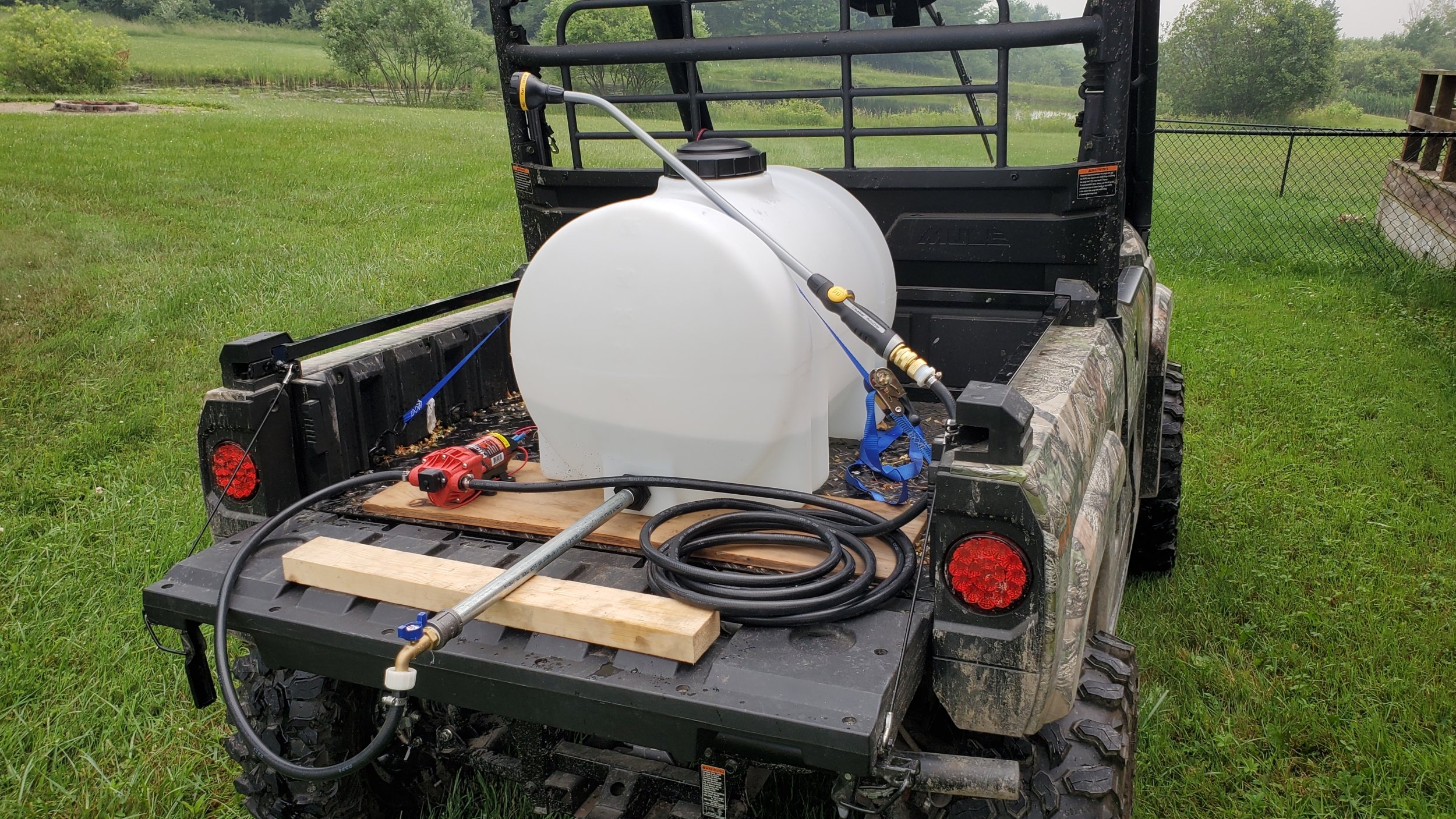

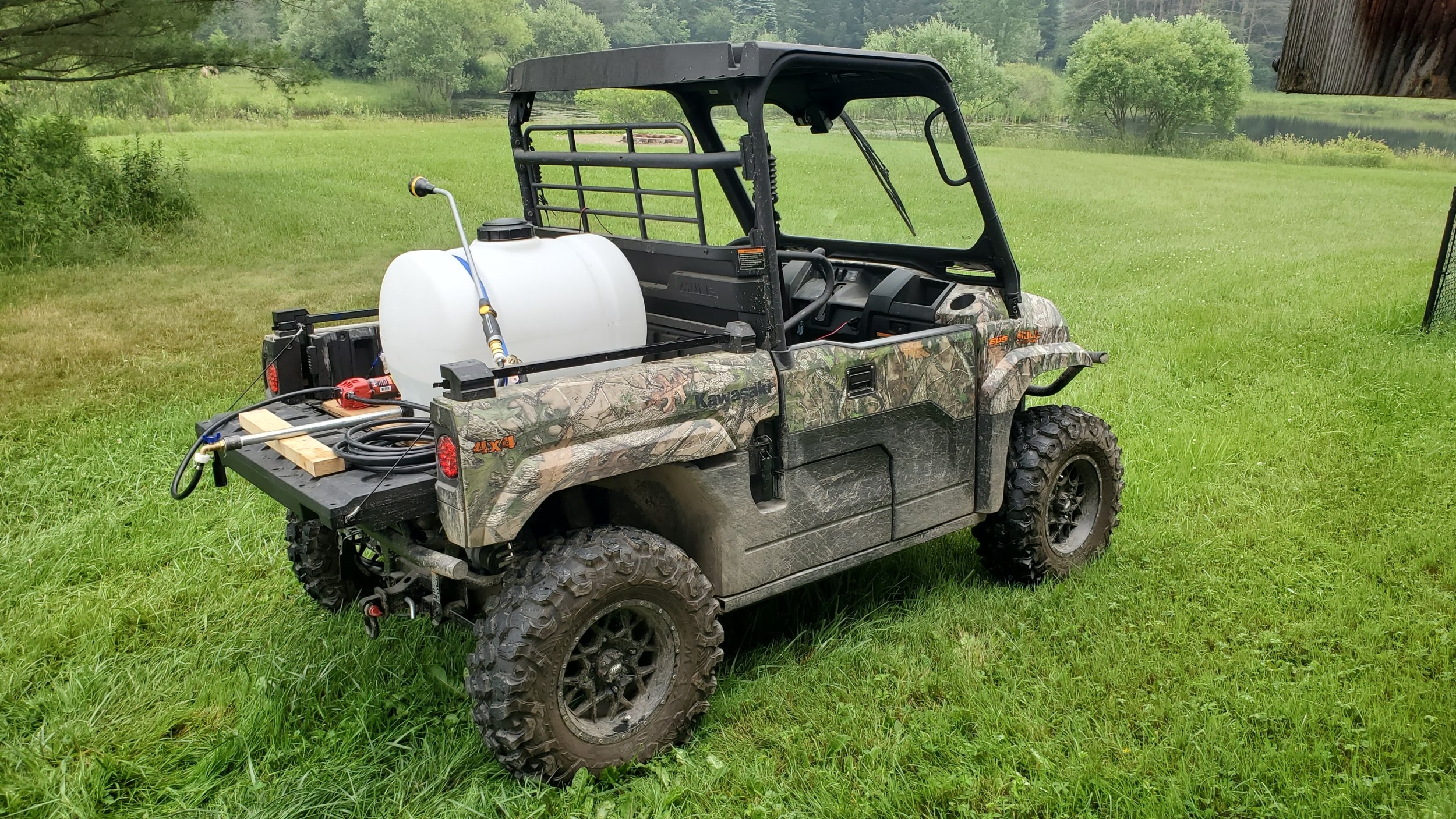

My garden watering machine was a success. I was afraid 3/8 sprayer hose would not allow enough flow to the watering head. I was wrong.

You can mount all that on a pallet real good and pick it up with your tractor, that will free up your utv for other uses.
Do you have pallet forks? A pallet is all it will cost you.

I have pallets but no forks.

Before you fill that tank in the UTV, add some 4"x4" or 6"x6" timbers to raise the tank up and remove that long galvanized pipe. Short nipple and a valve would reduce the strain on the tank fitting. Jon
