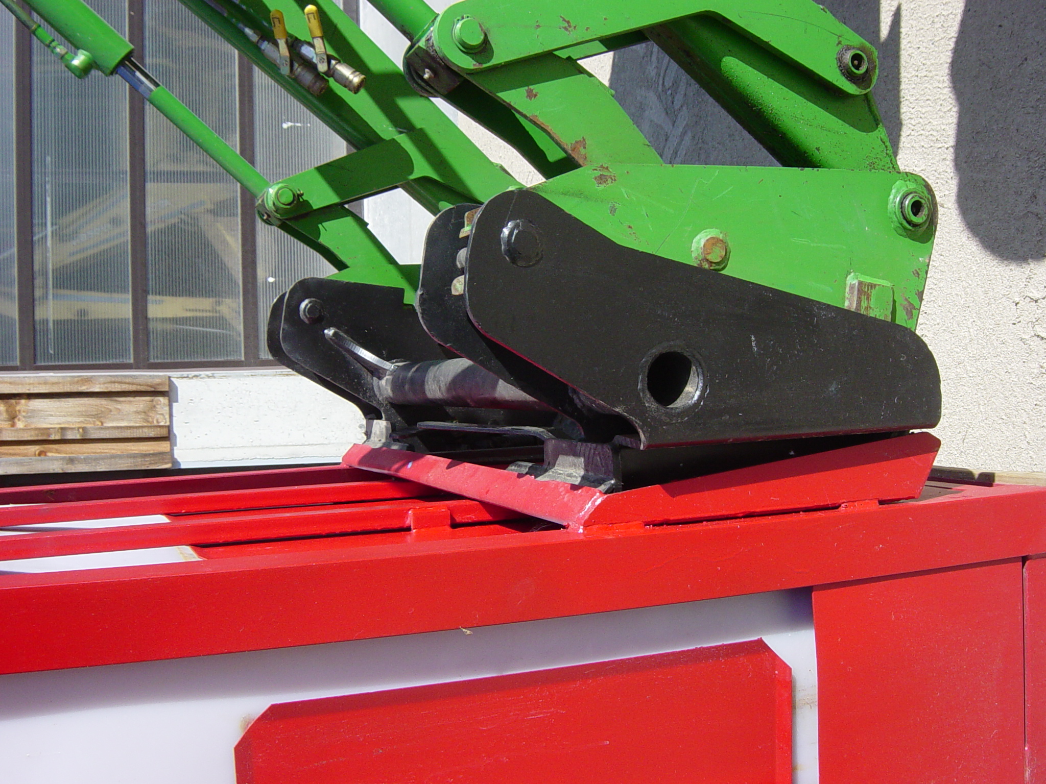

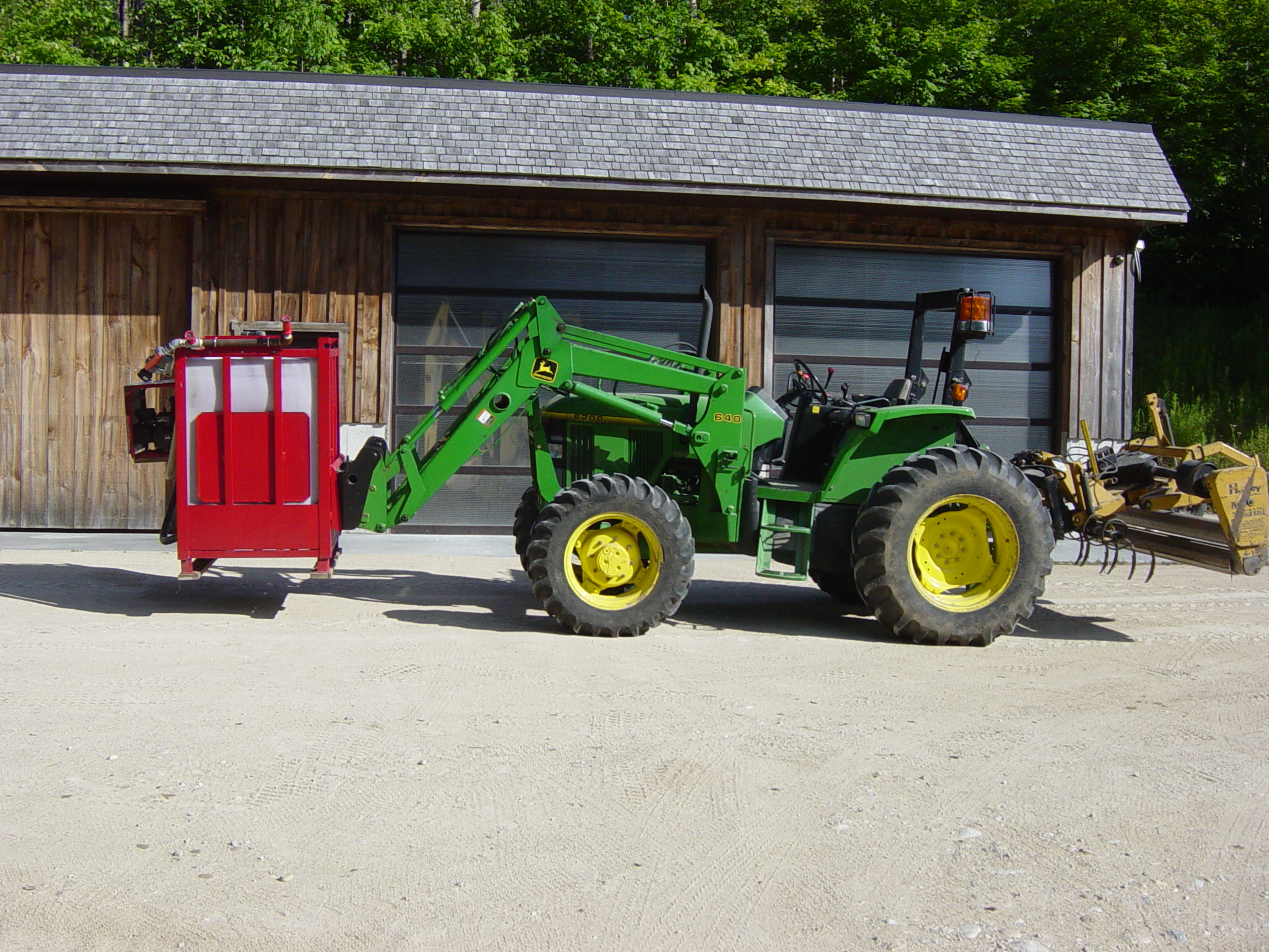

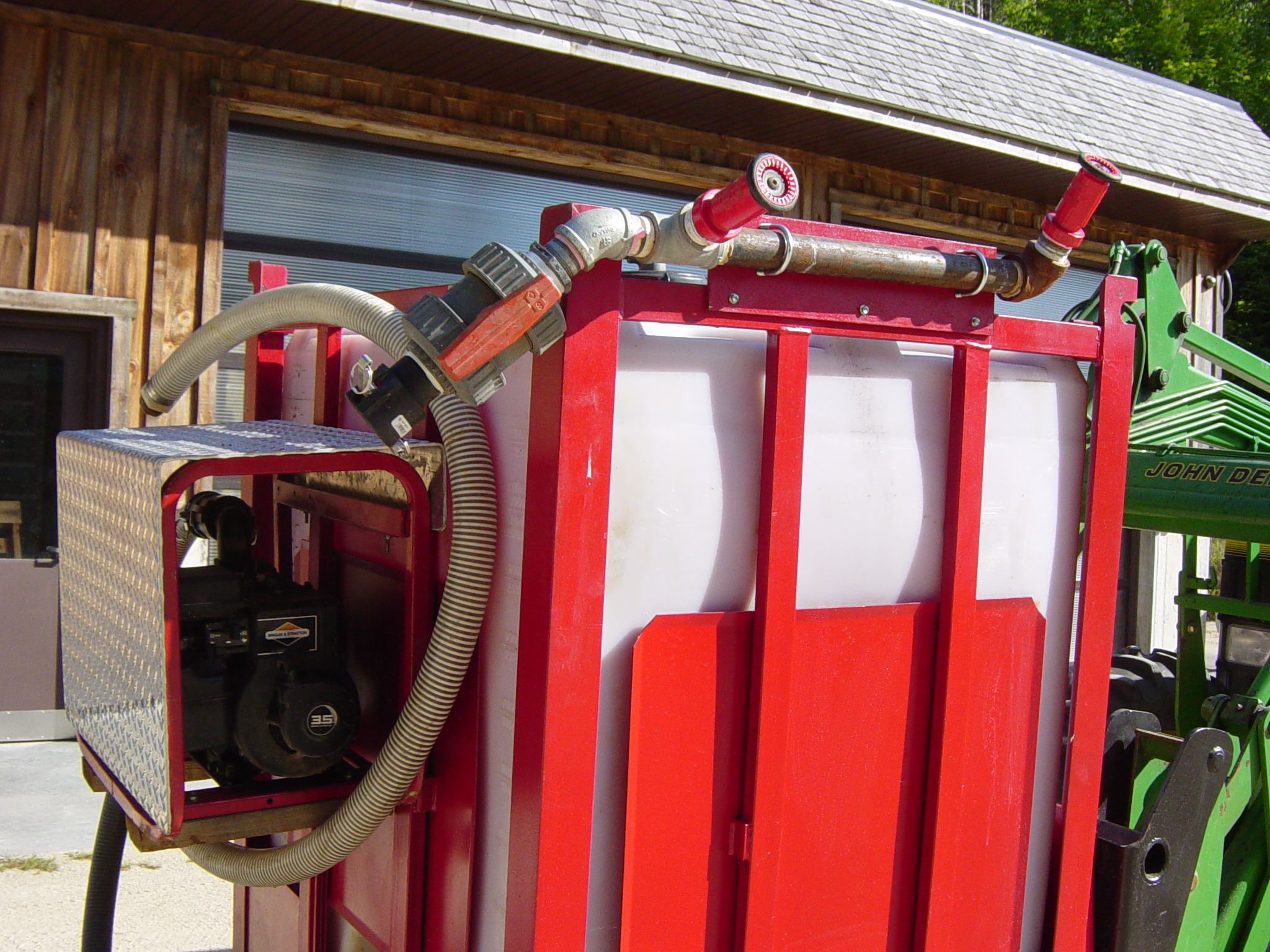

This is the arrangement I use to water new grass areas.
Just under 1300 liters.
I welded a SS plate onto the container to make it more solid and reduce weight over using my rather heavy forks.
I use a 2" Pacer pump to suck water out of a pond and a fire nozzle to disperse it. I rigged up those two nozzles but it wastes so much water that I have to make extra trips to the pond, so it was a failed project.
These tanks can be pressurized (BTW, they are cheap here, like $150.00). I would have liked to try and use an air tank and regulator, just drop it off and run a sprinkler. Unfortunately, I think it would require some kind of filtration to stop the sprinkler plugging up from the pond water.
I ONLY water at DUSK. The experts say not to, but I really found this to produce the best results with a minimum of time, energy and fuel. The water has a chance to soak into the ground over night and not just evaporate before your eyes.
