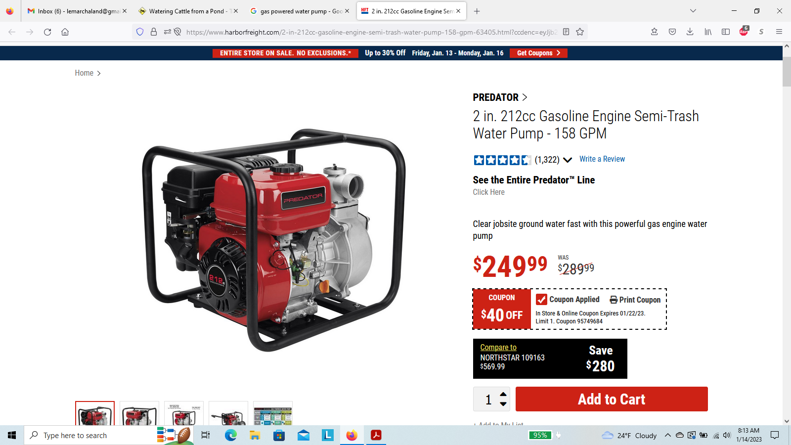

A small gas powered pump, filling several watering tubs will work. It does requireing pumping a couple of times every day depending on how much water trough and the number of cows.
it is a time consuming pain but is an inexpensive method, we use a foot valve on the end of the suction line to make for faster priming after the first time. A floating bucket or barrel will keep the suction line out of the mud.
