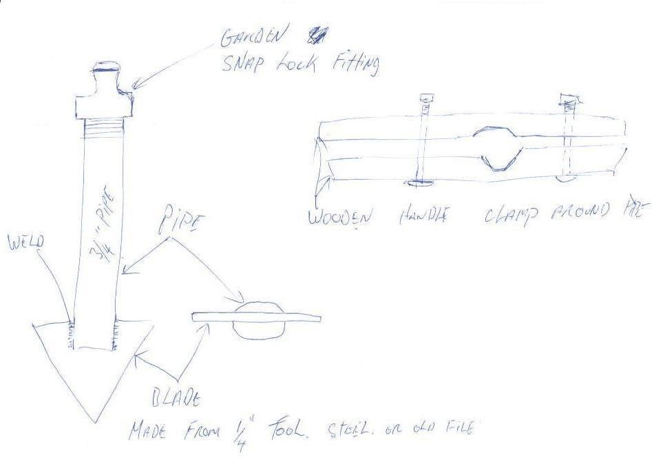

Hi
I hope this make sense, please forgive me if it does not.
I have put down several bores to about 36 feet in clay useing a home made tool and mains water.
This is done using lenghts of 3/4 water pipe
First pipe has an arrow welded on the end in such a manner to allow water to squirt towards the arrow head.
The top of the pipe has a snap lock garden hose fiting attached so you can connect the garden hose.
Use a wooden handle that clamps around the pipe so you can turn the pipe and arrow, the water assists with the boreing and washes the loosened material to the surfuce. as you go down just keep adding lenghts of pipe, (10 feet is suffice )
Always turn in a clockwise direction so your joins don't undone
   / Water Well Drilling #4
We call that jetting a well down here and it works really well where you have a supply of water to begin with. We've also used a gasoline driven pump to supply the pressure if it's close to a pond, creek or other source.
