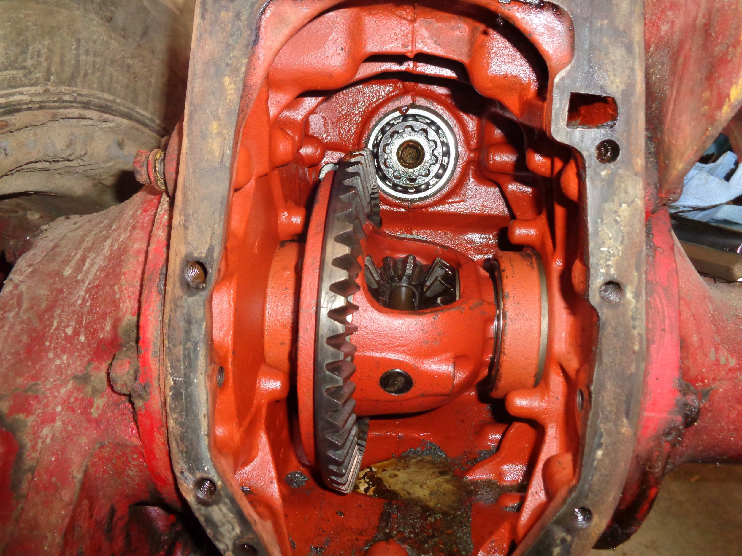

I use a mix of diesel, ATF, usually a 50/50 mix of the transmission capacity, minus 1 quart. Then add 1 quart of 90% rubbing alcohol. Diesel does have a bit of lubrication properties, and the ATF is a high detergent oil, which will clean things up, while the diesel washes everything to the bottom of the transmission. The rubbing alcohol will absorb any remaining moisture, and take it out with it. Add proper amount to the transmission, then drive around for 10 minutes or so, then immediately drain. I usually flush with an extra 1/2-to 1 gallon of diesel for a final flush, once it quits draining.
Depending on what type of filter element is on the hydraulic pick-up, if a paper type element, would probably be a good idea to change it. If you have a service, or operators manual, it should tell you how to do that. Maybe someone here has a like model, or similar one, and can advise on that. Could also be a You Tube video on it.
As mentioned, if the shifter boot(s) is/are bad, more than likely if it has set outside in the rain, water will run down a shifter into the transmission. Even replacing them if they are bad, is not a complete guarantee it will stop that. If it can't be parked inside, some sort of cover should shed most of it, even a 5 gallon bucket set over the shifter's, and secured might work.
Here is a picture of using this mix to clean the transmission on my IH 140,which also had trans oil that looked like a thick milkshake.. What you see in the bottom is remnants of a bad PTO bearing. I did a final cleanup, while I had it apart to replace the bearing, and adding new oil. It did a pretty decent job of cleaning things up.
