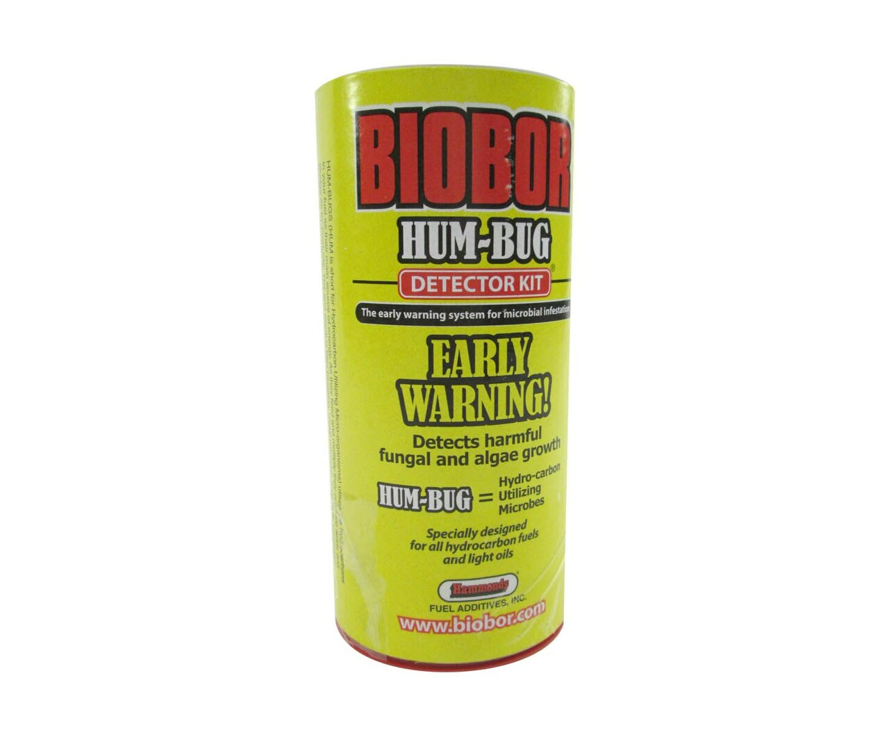

Note: You may only get algae if your fuel is exposed to direct sunlight for extended periods, such as in using IBC totes for your bulk storage. Algae are photosynthic. The microbial fungi "bugs" do not require sunlight. This is what we use in our 80,000 gallon fuel tanks.
Also, you want to use this to check your bulk storage tank:
   / Water in fuel causes $10,000 damage to my Kubota Grand L6060 #82
thanks on the info, looks like there are 2 separate issues, algae & microbial as you mention. being non commercial, my fuel is rotated in 2x5gal containers, so that may not be as much as an issue as water. i like the scrubbers in PS
thanks again, regards

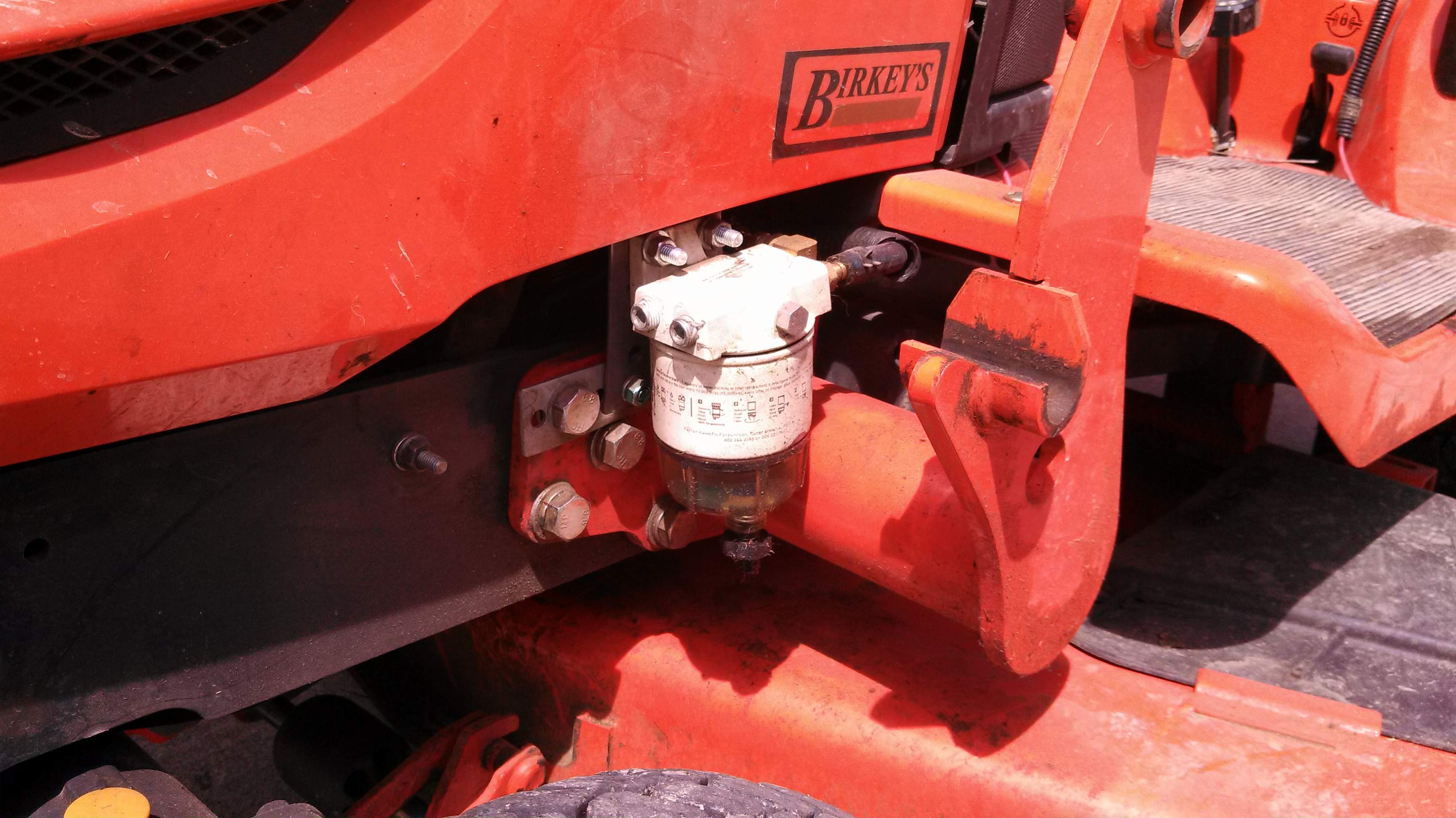

I added a Racor to my Kubota BX when I owned it. A big improvement since it came with two of those tiny ones. It didn’t have any kind of sensor though.
   / Water in fuel causes $10,000 damage to my Kubota Grand L6060 #89
Racor fuel filters are available with water sensors in the bowl.
