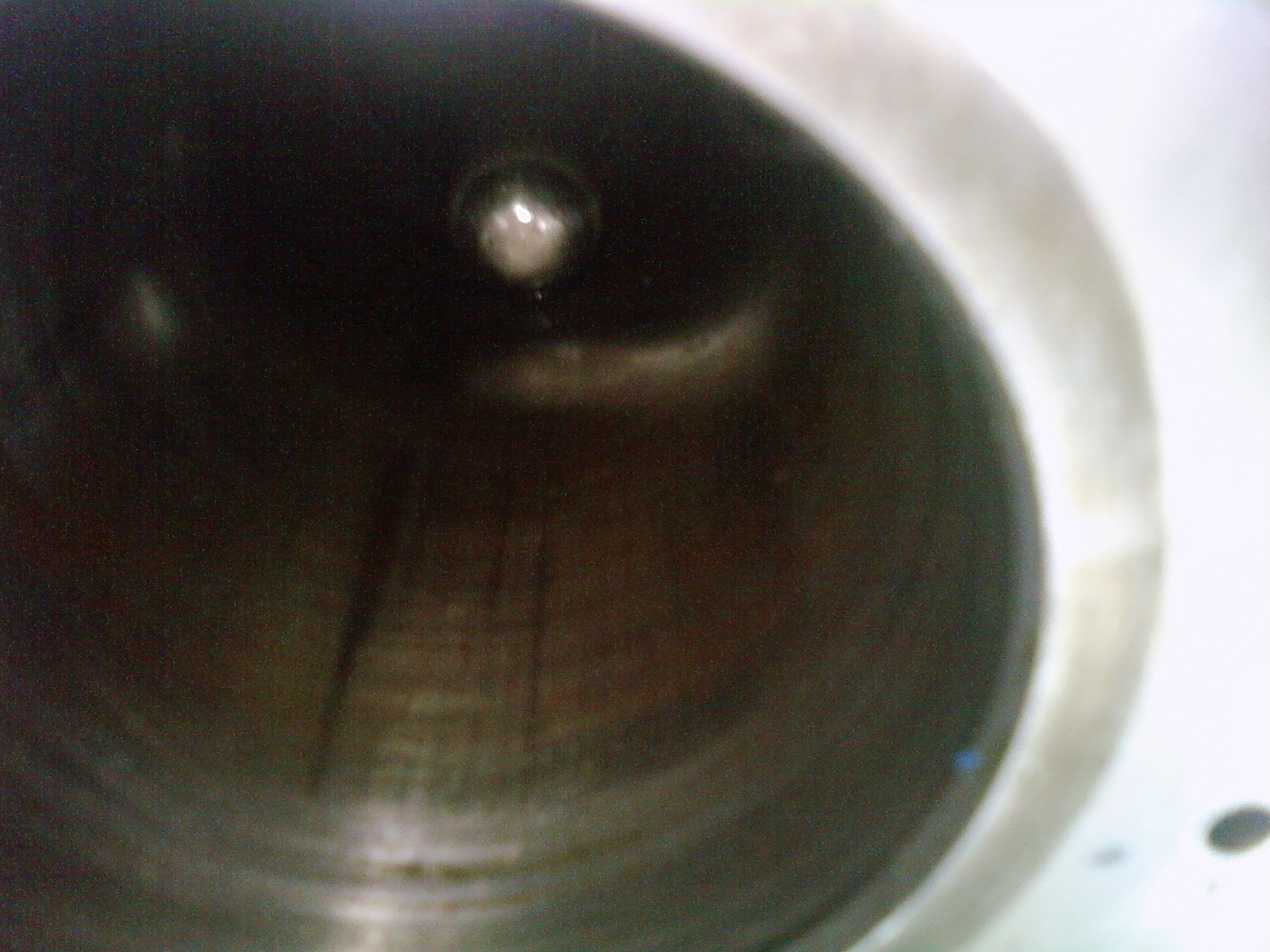

0417121753-01.jpg0418121240-01.jpgWith the exhaust manifold exposed to rain as you say- then yes- even for me it's a paperweight. I'm restoring an old Honda MC at the moment that was seized up for over 15 years. The difference? This one was sitting in a garage so the damage was limited to the cylinder and piston. Also the entire cylinder on these old bikes is cast iron whereas many small industrial type, air-cooled engines have a cast iron sleeve. Likely, damage is ruined valves, valve guides, cam shaft, cylinder and piston.
