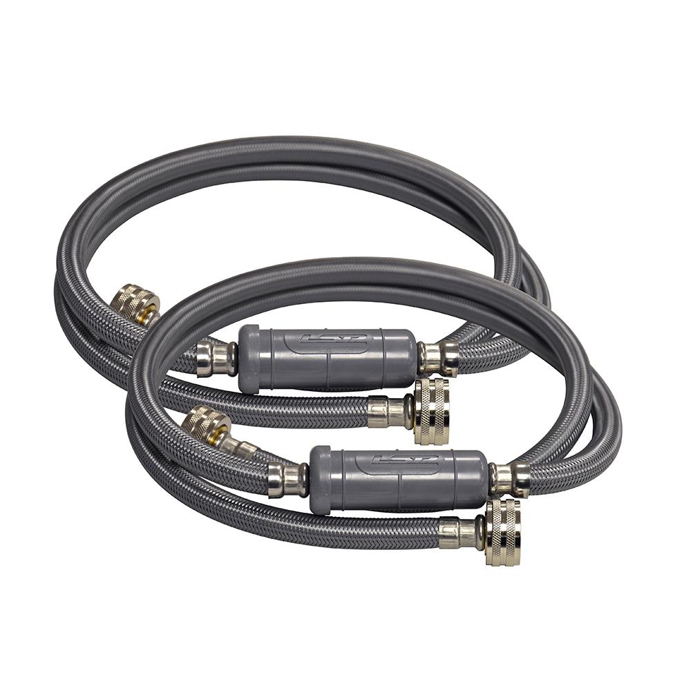

Had the same problem about a year after we bought a new washer even though the plumbing had anti hammer fittings. Talked to a buddy and this solved it
Hammerstop is the brand

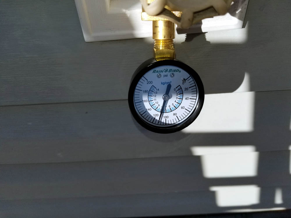

OK....so no amount of those hammer arresters did anything ....well anything good - they gave me lots of drippy little leaks to keep fixing.
SO here is I'm guessing the problem....which lead to another problem:
112 psi - about 2x what I'd want.
SO to fix it, i *thought* I just needed to adjust this set screw on this valve right above the main valve to turn water on/off for the house.
You can see how far counterclockwise I turned it with no effect. That gauge stayed at 110ish no matter what. I got it to where it would go down to 80psi with the kitchen running wide open, but it wouldn't adjust any more than that. At just the hose bib with no water running anywhere, it's 110-112psi. I did disconnect the gauge, run the hose bib wide open for a minute or so, shut off, then reconnect the gauge. Other than while I was letting kitchen sink run - during that time I just left gauge on with mrs CMV watching it while I adjusted.
So took cover off that valve/pressure regulator/whatever it is. Everything looked ok (to someone who doesn't know what he's looking at). Diaphragm moved back & forth, spring looked OK, rubber around the diaphragm piece looked good. But unless that's not what adjusts the house's water pressure, it doesn't seem to be working. I tried going the other way and bottomed out that set screw which only bumped the pressure up a bit.
Guess I need to call plumber & get that pressure valve replaced? I have no PEX tools or knowledge so unless there's some type of shark-bite version where I can just cut the old one out and push connect the new one in its place, it's beyond my skill.

I would have the pressure control valve replacd as soon as possible. Hot water heaters do not like high inlet water pressures. Water expands when heated and water being heated under 110 pounds of pressure is going to cause expansion problems.
   / Water hammer #26
If I am seeing things right, that regulator has a union joint on the top, and I imagine there is one on the bottom too. That means you should be able to swap a new one in very easily by unscrewing the collar. To maintain the same spacing, you'd need the exact same model or one that has the same inlet-outlet dimension. Sometimes with a union it's a good idea to replace the o-ring or rubber washer when you swap things out.
