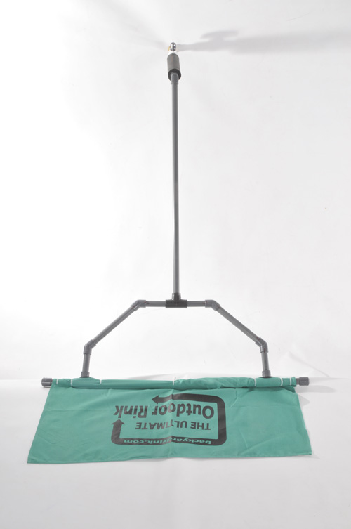

This is what I am using to smooth my ice
I just attach a ball valve at the top and a quick disconnect and I'm good to flood.

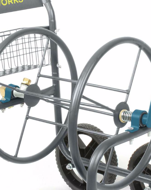

One of these with an old pair of skis attached opposite to the direction of the wheels would make pretty quick work of hose storage if you are on flat ground.
Yardworks All Steel 4-Wheel Rolling Hose Cart | Canadian Tire

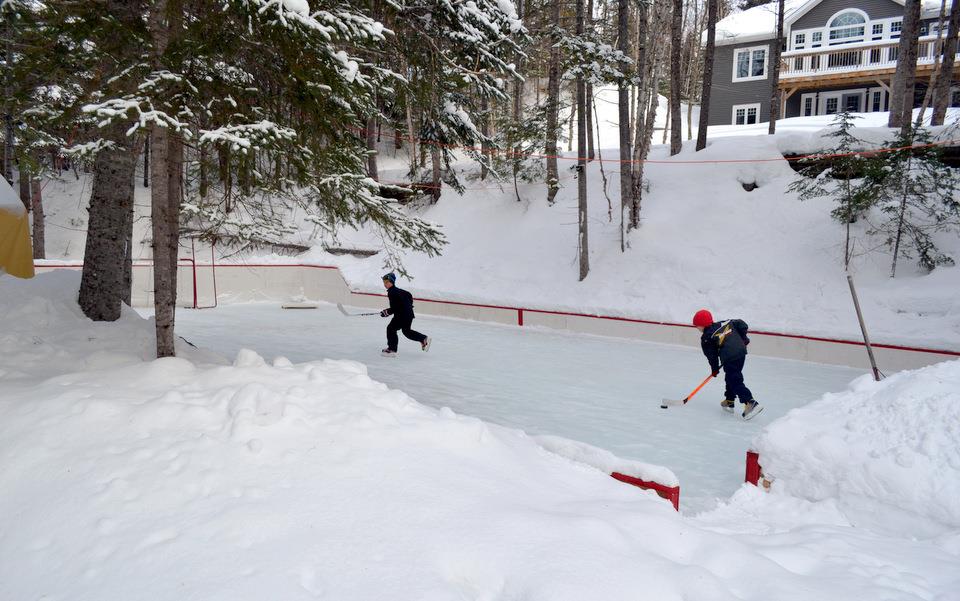

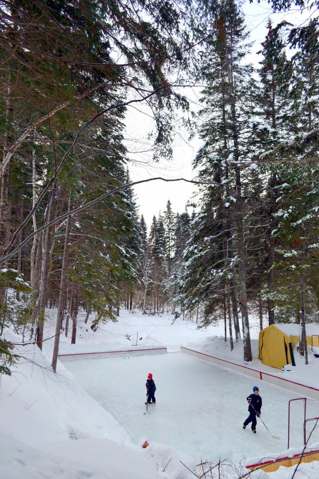

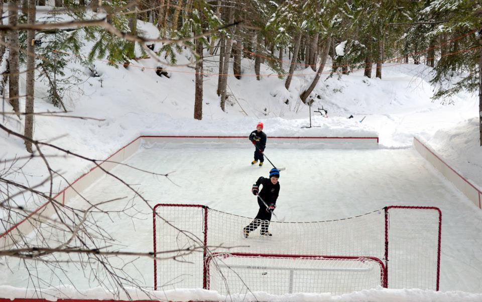

Figured Id throw up a couple of snaps of our rink. Rink Guys appreciate other rinks I think?
