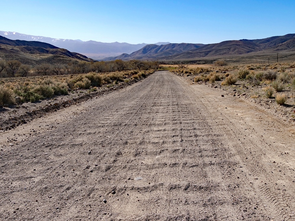

Acceleration? Excess speed??
Mostly it is the type of road surface. Here in the desert most of the dirt roads are like what is in the pic below. No one is "accelerating" for miles upon miles on these roads, nor are they traveling at excessive speeds. A dry sandy surface with a lot of loose material on the road surface and washboards will develop no matter how slow you drive.

You kinda already know the reason, it's dry. You have to have something cohesive to prevent wash boarding. Depedning on the driving surface (sand, dirt, clay, base rock, gravel), you May be able to add something that will bind it together better, but in the end, moisture is needed for almost anything to bind together. To help avoid making it worse, drive slow, in different tracks, will help.
To temporarily remove, they can be graded out; BUT, grading will loosen and remove more moisture, making it come back soon, and worse
In that situation I have a pond near my roadway. I purchased a 2" pump added fire nozzle and kept its moisture level high.
