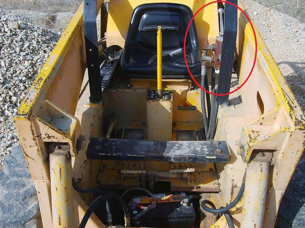

#11
I have another question on the picture shown,What is the valve i have circled? i did not see it on my skid.

/ was given a Jd 24a skid steer. #12
That is just an auxiliary valve that someone added. Probably to run a grapple or other hyd. powered attachment.
