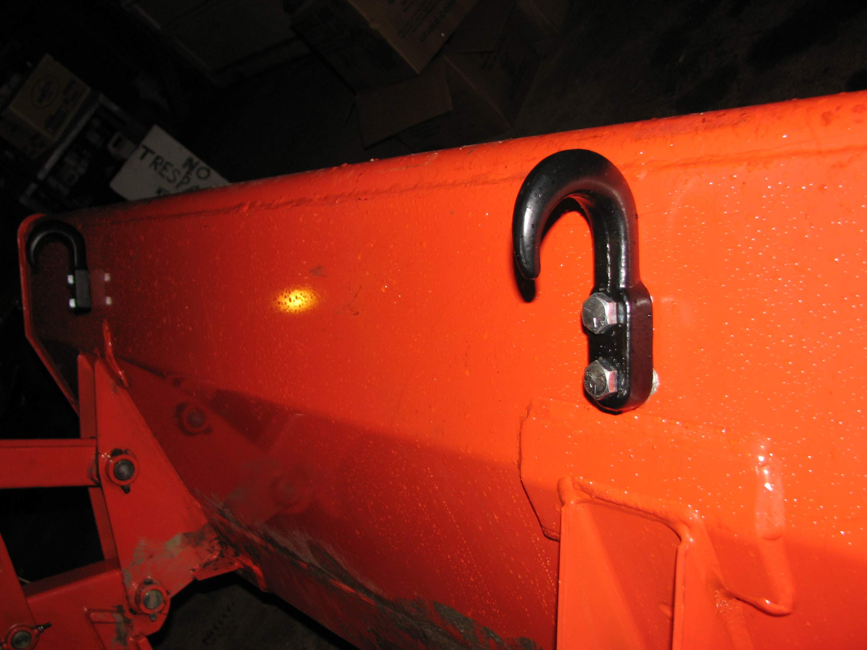

All this talk about adding hooks to the FEL has me itching to do the same... Does anyone have any website recommendations for where to buy these hooks. I have looked at the local Tractor Supply and Hardware store, but have not found any... :confused:
I bought my bolt-on hooks at Tractor Supply. They have been trouble free and are very sturdy. At the time I didn't have a welding machine, so this was the quick and easy way to get what I needed. It also showed me that I was in sore need of a new, heavy duty 1/2" hand drill. In the near future I will be adding a hook right in the middle of the back of the bucket, turned opposite to the other 2, for single point lifting. Now that I have a welding machine, my plan is to use a weld-on grab hook for that one.
-Jim
-Jim
Jim,
I hope you have backing plates inside the bucket under those hooks. I bolted those type hooks on my first tractor bucket with no reinforcement. I think I must have side loaded them somehow, maybe with a "Y" arrangement connecting one lift point to both hooks. It bent the sheet metal slightly where the bolts go thru. And my bucket wasn't a pretty as yours.
John

Have you ever seen a bucket that no longer has the front edge touch the ground level? In other words, one side of the bucket hits the ground before the other? Most likely, if it has hooks welded on it, it's because someone improperly welded hooks on the outer edges of the bucket. This should never be done. In line with the lift arms or inside the lift arms only. As I've said on here many times before, I've cut off dozens of hooks after guys have damaged their loaders by having hooks on the outside edges. That is never a good idea and will not only exert forces improperly for lifting but will almost assure you nearly tip your tractor on it's side the first time you try to pick something up with just one hook. Never outside the lift arms.

I put mine at the edges also and when I need to lift using one chain I cross the chain to the center of the bucket and hang it in the middle and use the other hook on the chain to hold it there centered.
